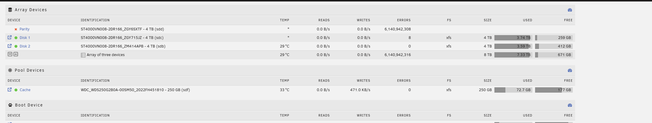

09/22/2025 at 3:01 AM
Alert [TOWER] - Parity disk in error state (disk dsbl)
ST4000VN008-2DR166_ZGY6SXTF (sdd)
Warning [TOWER] - array has errors
Array has 2 disks with read errors
I logged in to investigate, but the server was barely responsive. The GUI eventually froze, and I couldn’t retrieve diagnostics. Screenshot 2025-09-22 08:18 AM.

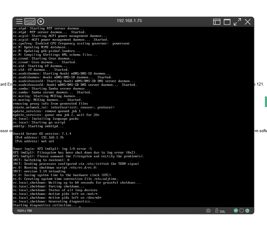

I pressed the power button to shut down the server, it took a while, and I believe it performed a clean shutdown. Though it hung at the diagnostics collection stage, I eventually had to do a hard power off. Screenshot 2025-09-22 11:26am.

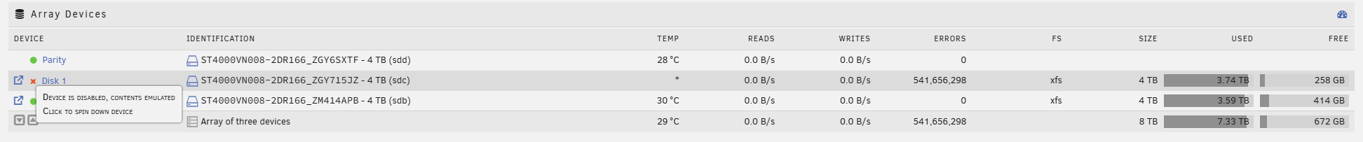

09/23/2025 at 3:25 PM
Alert [TOWER] - Disk 1 in error state (disk dsbl)
ST4000VN008-2DR166_ZGY715JZ (sdc)
This is the current state, Screenshot 2025-09-23 205210.
Fresh diagnostics are attached. How can I determine what data has been lost, and what can be recovered?

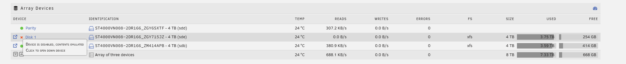

I’ve given the system a thorough clean and reseated all the cables to ensure proper contact. I did the same with the HDD backplane, removed all drives and reseated them. I even moved Disk 1 to a different bay, just to be thorough.
Here’s the current state after startup. Do I need to do something to try enable the disk?
Fresh diagnostics.
tower-diagnostics-20250924-0953.zip
Cheers.
No disk-related errors so far. Since emulated disk1 is mounting and assuming contents look correct, you can rebuild on top:
  • stop array
  • unassign disk1
  • start array
  • stop array
  • reassign disk1
  • start array to begin the rebuild
Any more errors, post new diags before rebooting.
