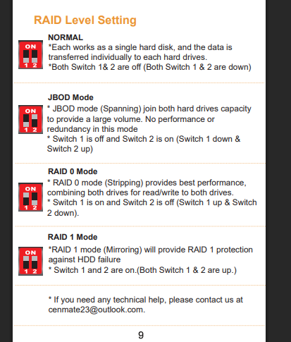

RAID Level Setting nees to be set to normal. unraid will use a software raid to control the disk.
page 9 of manual:
https://www.cenmate.com/uploads/soft/20250210/1-25021010193a30.pdf
with out knowing more of what type or version of the Cenmate external hard drive chassis you have.
model number, product number etc... Can't really help nor assist.

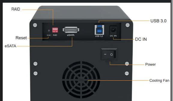

I'm assuming you have this and are looking to use it with unraid:
https://a.co/d/dpXxEeM
This is the Cenmate chassis:
https://www.amazon.com/dp/B0DD3FRQDS/ref=sspa_dk_hqp_detail_aax_0?sp_csd=d2lkZ2V0TmFtZT1zcF9ocXBfc2hhcmVk&th=1
This is this is the esata adapter:
https://www.amazon.com/dp/B00952N2DQ?ref=ppx_yo2ov_dt_b_fed_asin_title&th=1

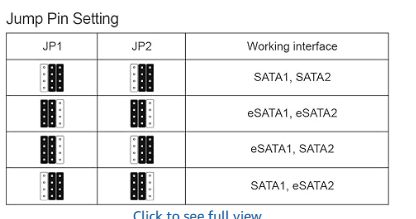

With both port pin configuration set for esata- which didn't work or didn't recognize card or esata adapter, since they only support LTS Kernels from 3.5 and up, with correct libraries, or unable to support Unraid/Linux server config.
Looking for a comparable USB PCI adapter that would work with Unraid/Linux configuration.

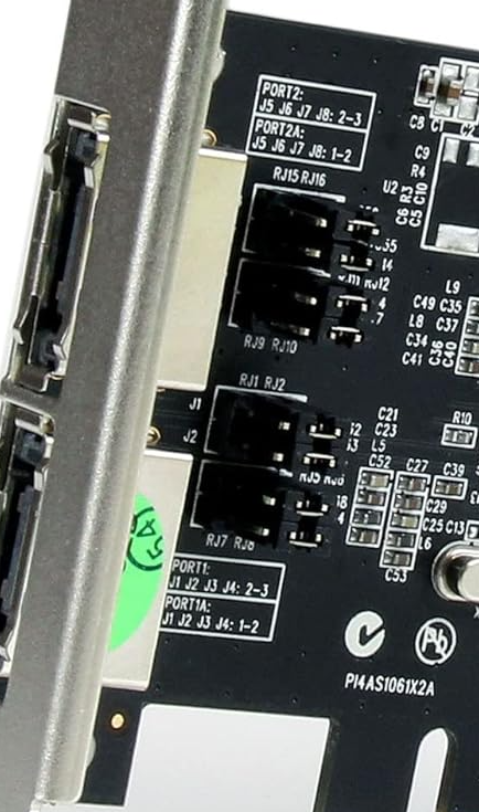

on the star card wht is the pin layout and whats pluged into what.
as this card similar with the above has pin configuration and may need moved over to use the esata ports. per amazon picture If i'm reading that corectly(kind of hard as its tilted and cant get a good read/count.. by defualt interanl sataports look like they are enabled...
So:

kerneal unraid slackware for this doent' mean much and that not correct. since your using a 10 bay disk shelf and that 10 bay disk shelf uses usb 3.0 you need to use the unasinged disk plugin. the cenmax device is using mutiport which unraid done't support.
again you would need to use a HBA in it mode to conect that disk shelf.
as this Hard Drive Enclosure is already doing disk operations for a raid. Unraid will not be able to use this device efectively. each of the 10 disk would need to be passed
example of a HBA
https://a.co/d/3q2WW44
as the disk shelf you links conect via usb to shar its jbod based on other raid configurations. Unraid done't support sas mutiport. unraid is slackware linux. ther is no adatila 3rd party or usb devcie I could recomend to fix or make your hardware work due ot the disk enclouse type and setup you have.
