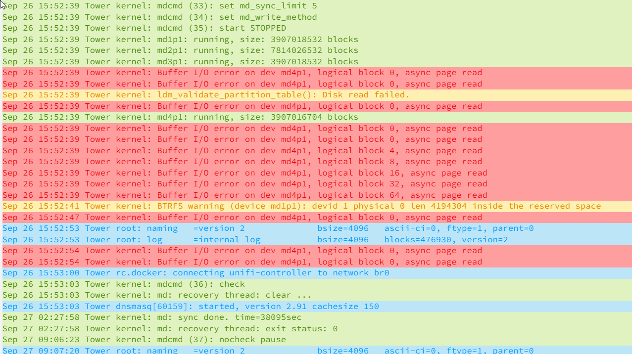

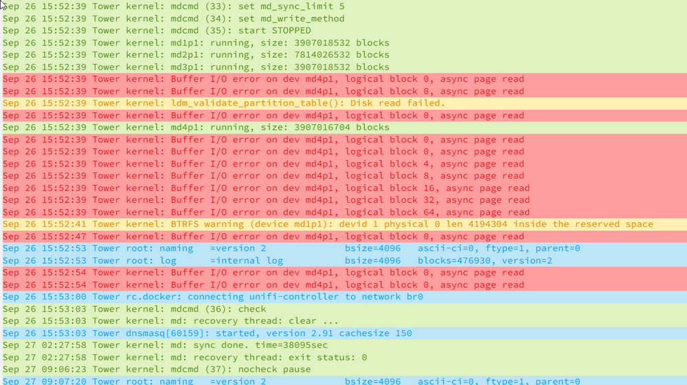

I had disk2 failing so I bought 2x 8TB disks to replace parity and disk2.
Parity was 4TB so I had to add a second parity (8TB) and then remove the old one (4TB) to be able to replace the disk2 with the 8TB) new disk.
Parity sync completed without errors.
But disk2 rebuilt finished with errors.

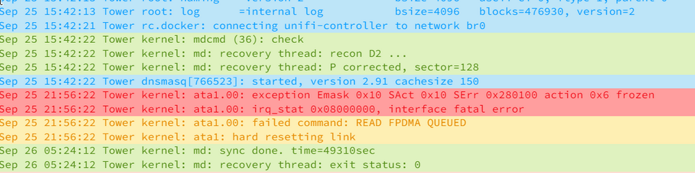

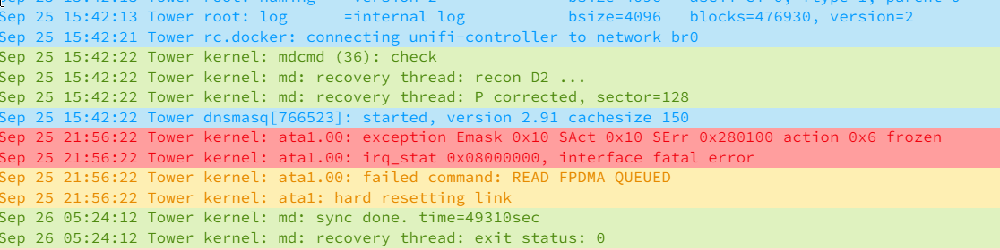

My problem is that I don't know what kind of error happened. Is any file corrupted so I need to restore it from backups?
Event: Unraid Data-Rebuild
Subject: Notice [TOWER] - Data-Rebuild finished (1 errors)
Description: Duration: 13 hours, 41 minutes, 50 seconds. Average speed: 162,3 MB/s
Importance: warning
This part in syslog shows the error. I have also attached diagnostics.
Thank you!
tower-diagnostics-20250926-0905.zip
Solved by JorgeB
A sync error was corrected; there is nothing else you need to do, there was an ATA rest for disk1, if it keeps happening, replace its cables.
