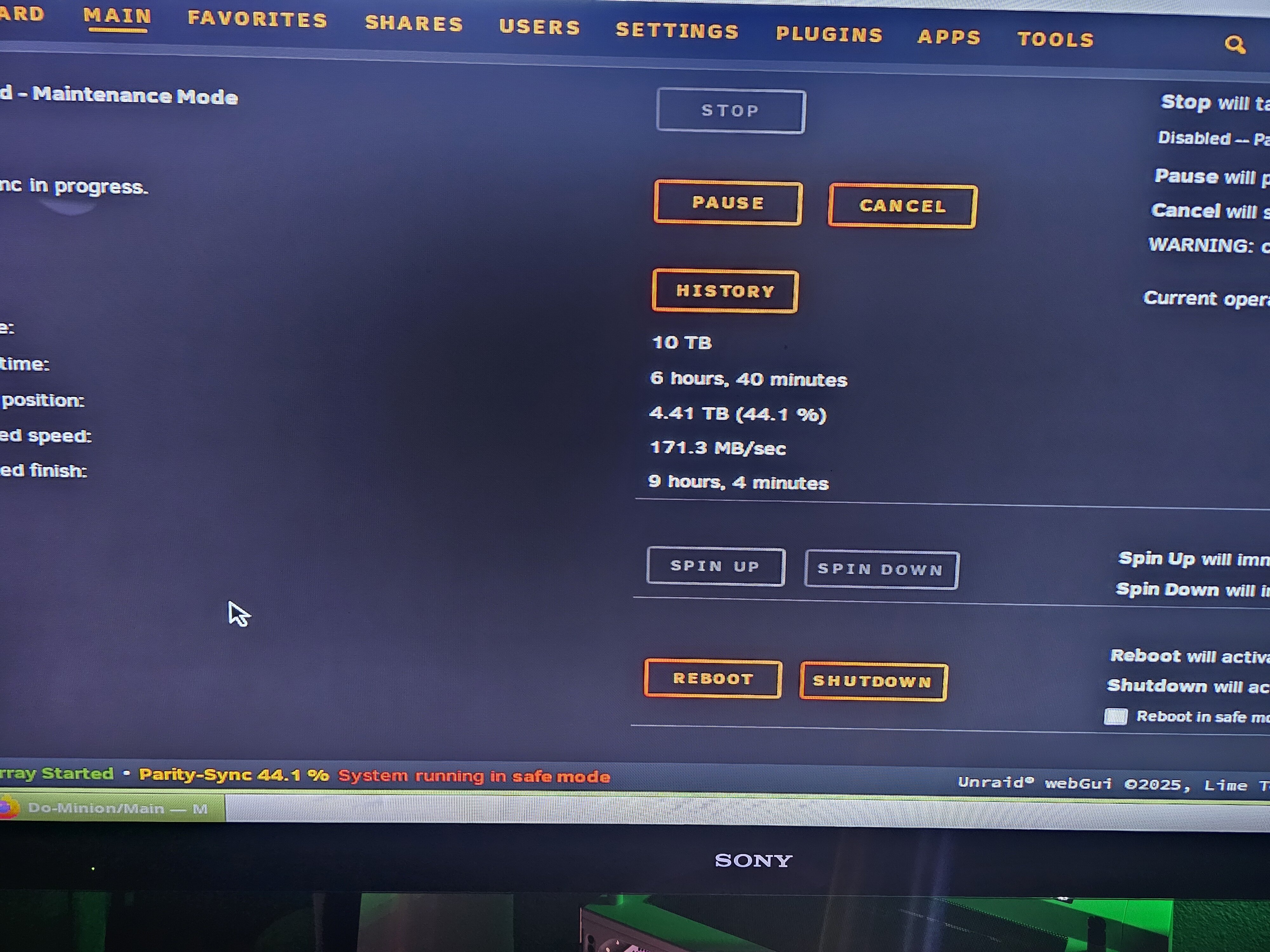

Good day and thank you for your info. I updated BIOS and made the changes suggested in your post. I then restarted in Safe Mode and started a SYNC but it froze again by the 8% mark. Im wondering if its something with the drive or something in config that may have changed. My main concern is not loosing the data in my storage drives. im trying to complete a Sync in order to replace some drives that gave SMART error.
Edit: 👇🏻
After the previous freeze, I restarted and put another sync to run and this also froze at a different mark. See pic. Unfortunately I couldn't get syslogs since I had to force-shut the machine.
