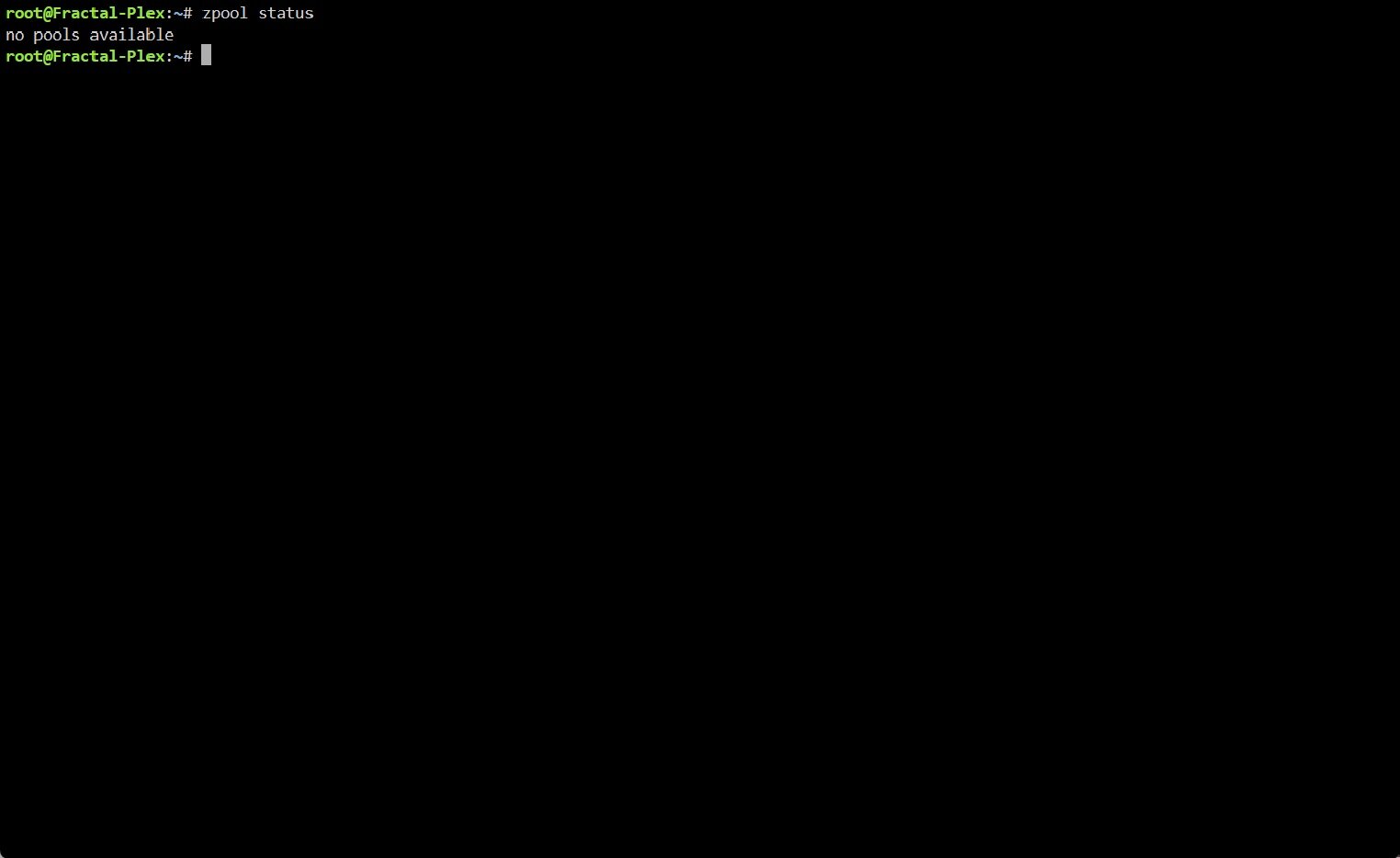

Unfortunately it did not work. I was looking at my boot sequence and noticed the line “no zpool”. I think my zpool has been deleted somehow.
zpool status shows nothing.
Post the output you get from that command, and also the output from zpool import

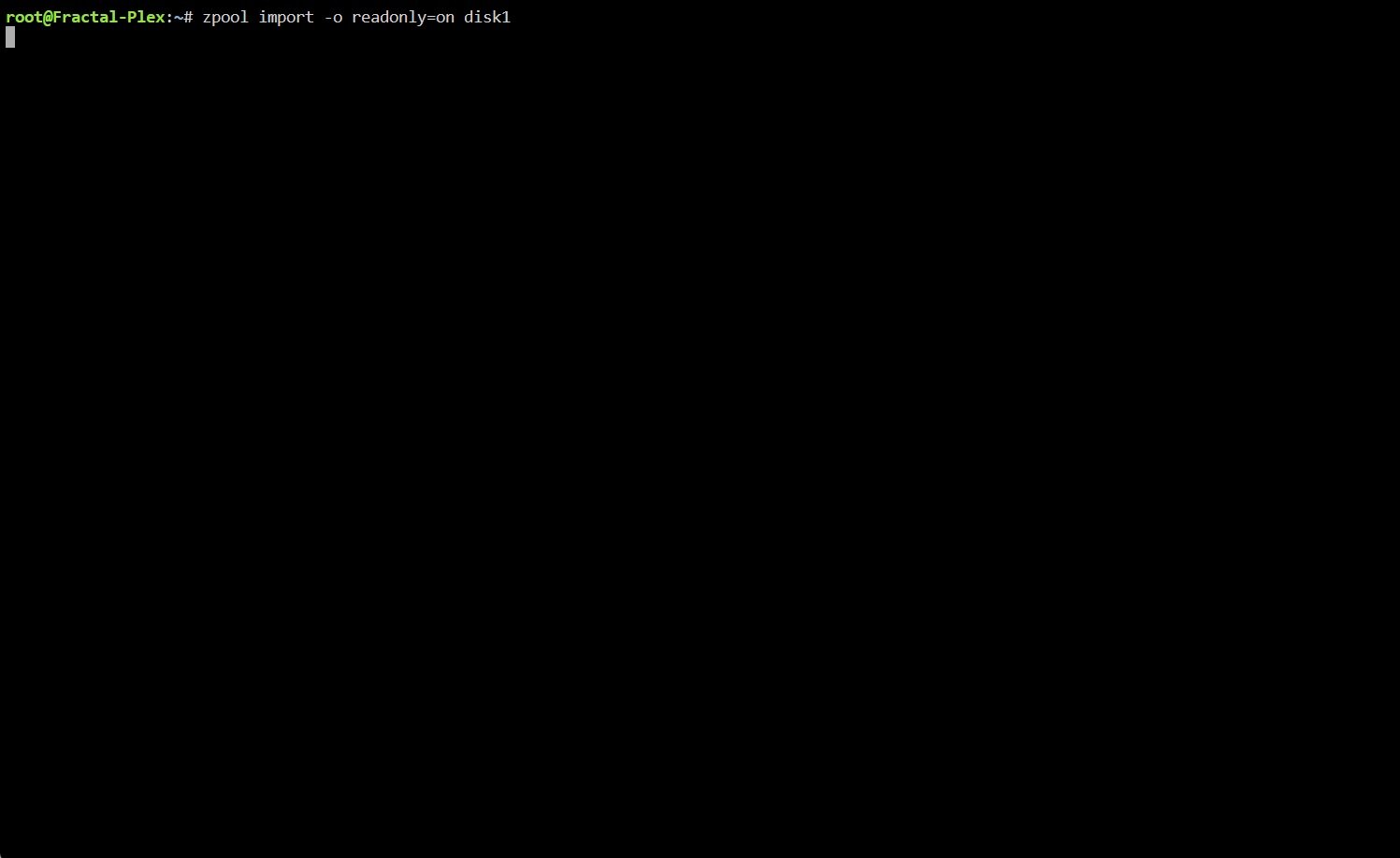

It won’t complete, it stays blank.

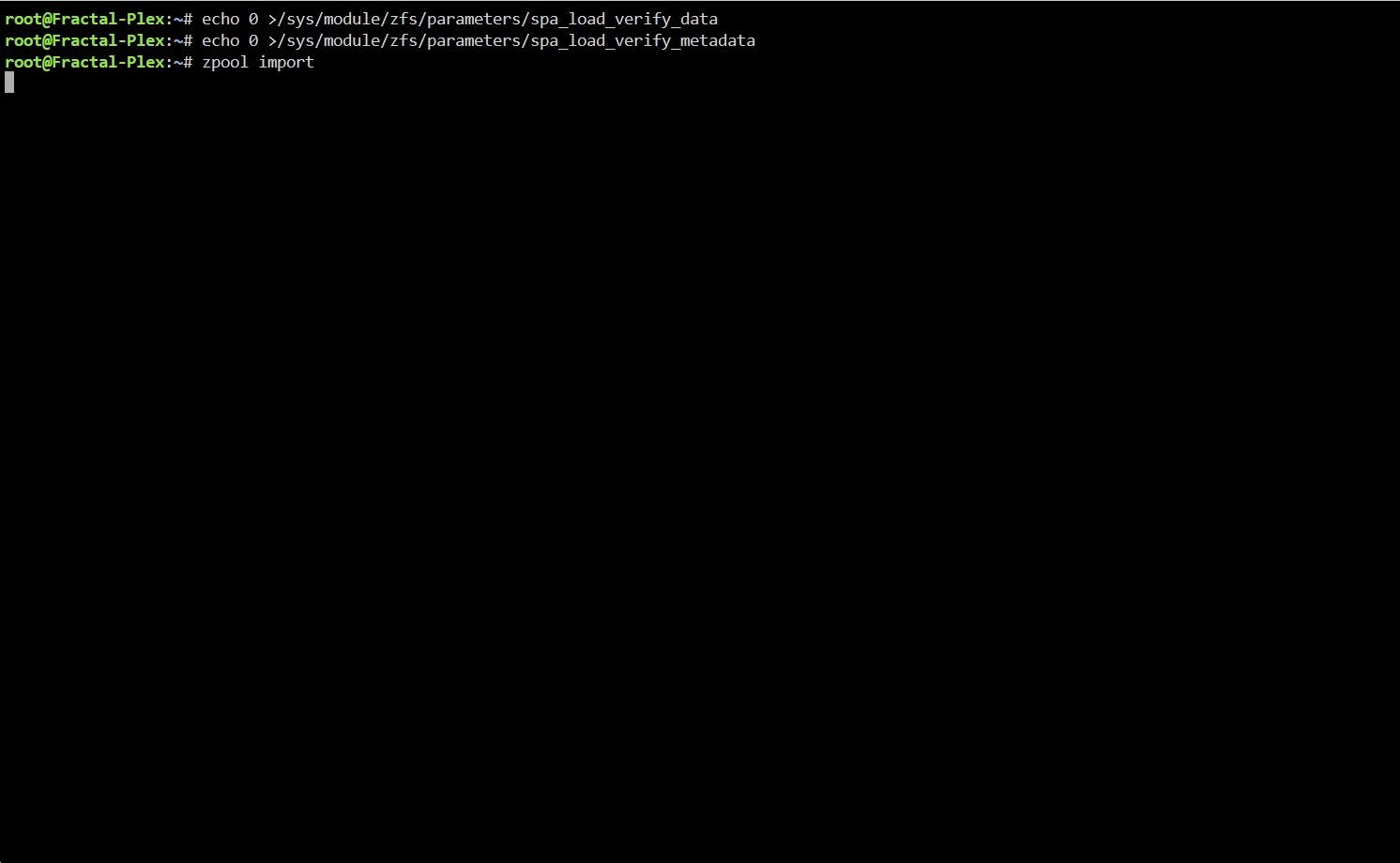

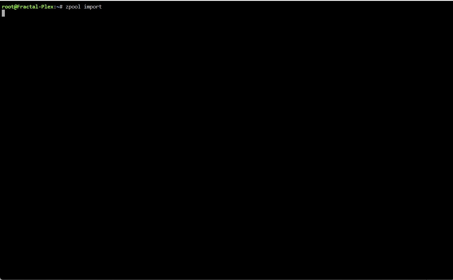

Which one? Post a screenshot.
Reboot to clear the logs, don't start the array, try just the zpool important command, and if the same thing happens, post new diags.
zfs is panicking with just the zpool import. Try this: reboot again, then type:
echo 0 >/sys/module/zfs/parameters/spa_load_verify_data
echo 0 >/sys/module/zfs/parameters/spa_load_verify_metadata
and try zpool import again.

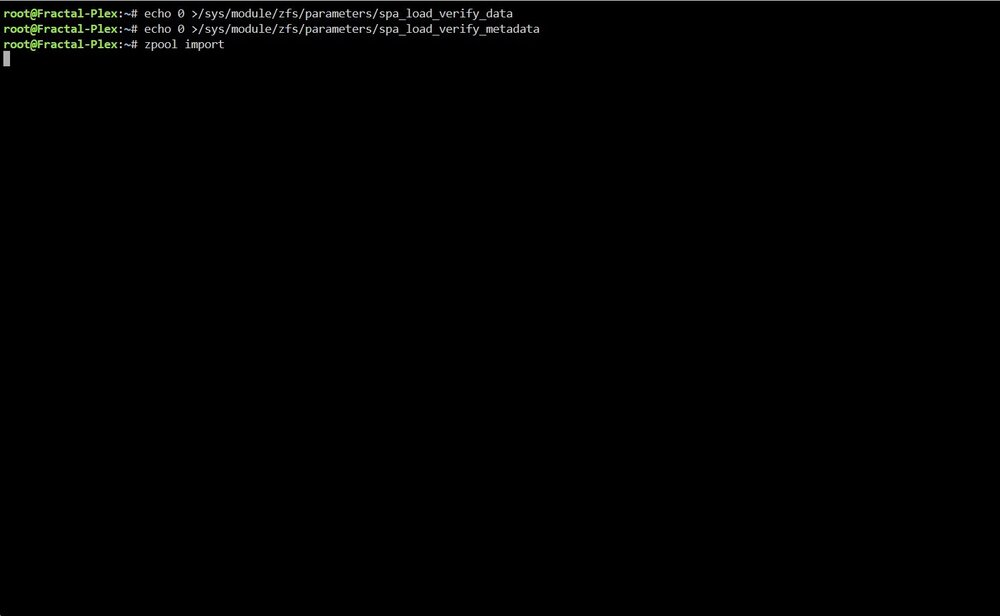

No change
I'm afraid that the filesystem is too damaged, you will need to reformat the disk to be able to start the array, if there's important data there and no backups, you can try a file recovery app like UFS Explorer; the free trial should show if it can recover anything.
