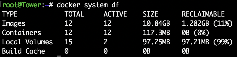

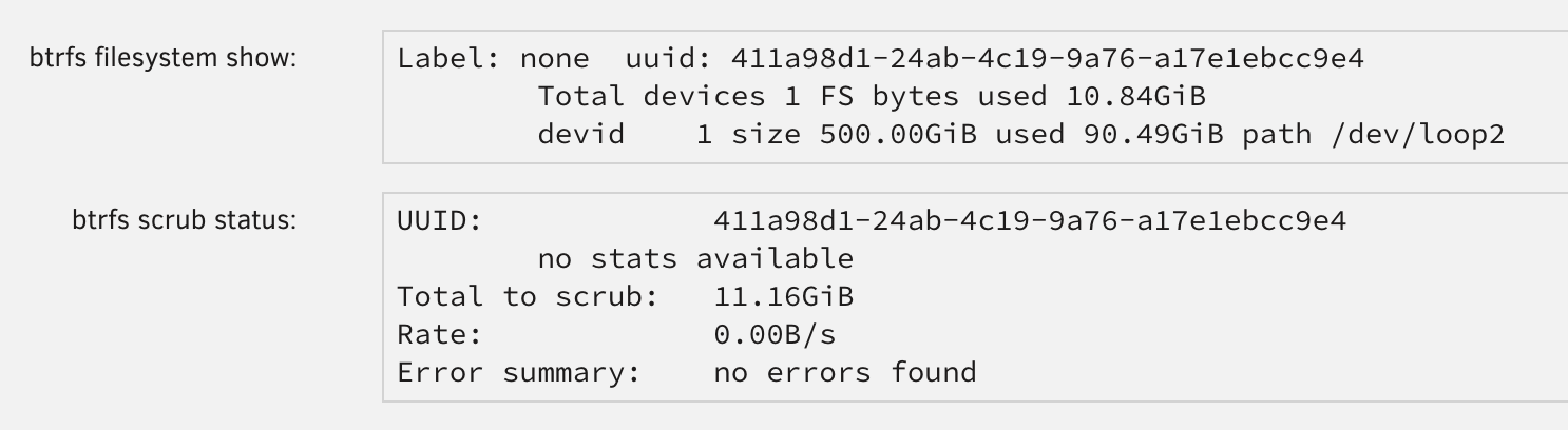

I have all my docker compose files running on my cache drive and now it gets quite full (950GB/1 TB). What I can see is the the docker.img file is not so much used as I initially thought with reserving 500GB for it. See the screenshot. I asked Perplexity how to save some space on that drive and it came with quite complex instructions, is there an easy way / strategy on reducing the drive / image?
I already did a system prune and the state is now

Solved by Kilrah
GitHub
No image preview
unraid_scripts_and_guides/guides/recreate_dockerimg.md at...
Unraid scripts and guides I've put together. Contribute to jcofer555/unraid_scripts_and_guides development by creating an account on GitHub.
Change the size to something more sensible between steps 3 and 4.
