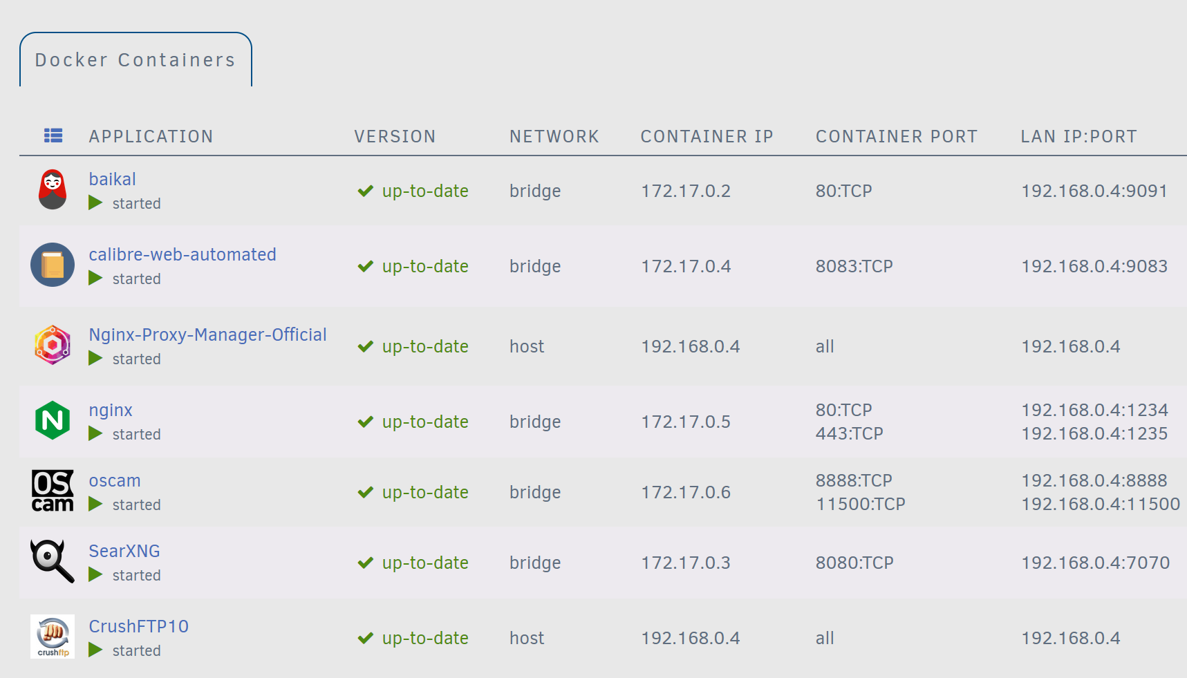

Take a look at my docker list for example:
The gui does not show any V6 addresses at all (but they are there in the background, believe me).
As you can see, there are many running in "bridge" mode, others in "host" mode.
The general rule is "if you need direct access to the docker from the internet, you need to run it in host mode". This means, it is reachable with the address of the server himself.
Here "Nginx-Proxy-Manager-Official" and "CrushFTP10" are directly connected.
The others, running in "Bridge" mode, need proxiing, this is handled by "Nginx-Proxy-Manager-Official" (or other alike packages that are also available).
This takes the connection from the internet and makes a new internal connection to the local docker (this can become quite complicated, you will find several posts here in the forum how to solve certain problems). The nice thing with it is, it can take connections from V6 and hand it over to internal V4!
So you will not have to deal with the complicated Docker-V6 at all.
You might ask, why not running ALL dockers in host mode? the answer is simple: in host mode they use all the ports they have been created for. And many many use ports 80,443,8080 and so on. So they cannot be run together. Nginx-Proxy-Manager uses ports 80 and 443 and tunnels them to arbitary ports as you can see on the above list, so baikal can run with nginx although both of them use port 80 internally.

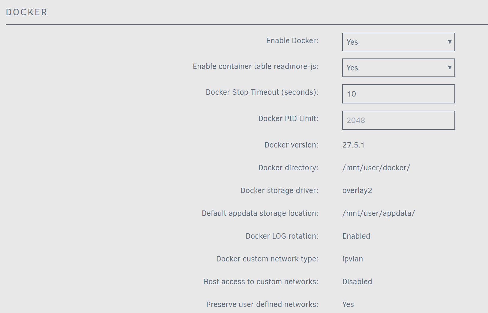

I currently use the macvlan driver for the custom network, which also works with IPv6, but containers cannot access the host via IPv6 (even though it is enabled in the settings).
The problems described above only occur with ipvlan.
What are your Docker settings? Would you mind sharing a screenshot?
What settings? I thought I have made a shot of the docker config above already??? or do you mean a particular docker? (although that would be boring, the only thing I ever change for the dockers are bridged or host mode, and maybe a port now and then.)
