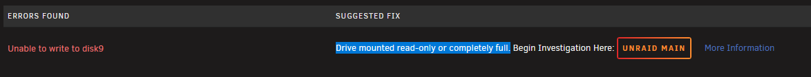

Unable to write to disk Drive mounted read-only or completely full

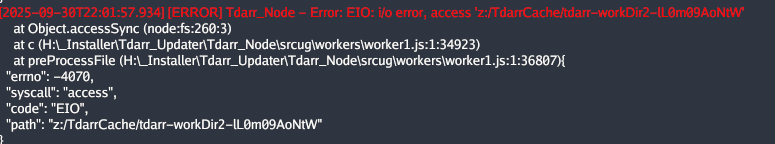

I've finished a pre-clear on a new disk to replace a failed disk and I noticed when I added to drive 9 after the pre-clear it did not ask to be formatted. The rebuild also finished pretty quick, but now I'm getting this error from "fix problems" and tdarr is reporting an I/o error witting to the drive.
