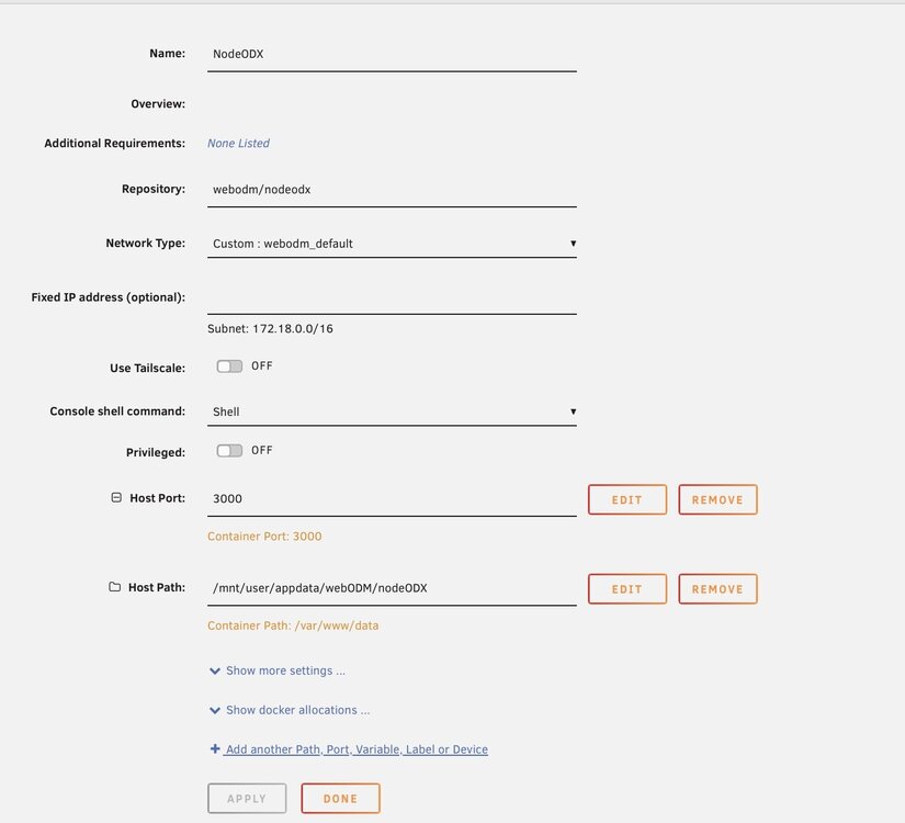

April 20Apr 20 Just in case anyone else is looking for this, I feel like I should document the other step as well since opendronemaps nodes are depreciated. From my limited understanding, there are a few different processing nodes that can be used. It looks like WebODM, if downloaded to Windows or MacOS, defaults to creating a NodeODX node, so that's what I went with here. I generally copied what was done in the linked post. Here are the settings I used to create the container. I'm sure the network type can be changed. Change the path to be uniform with whatever you did with WebODM variables. Note: I did not choose a template. Also note: I am not an expert in any of this, but it worked for me. After this, just open WebODM and set the processing node information and you should be good to go. I ran a test last night and everything worked as expected.
