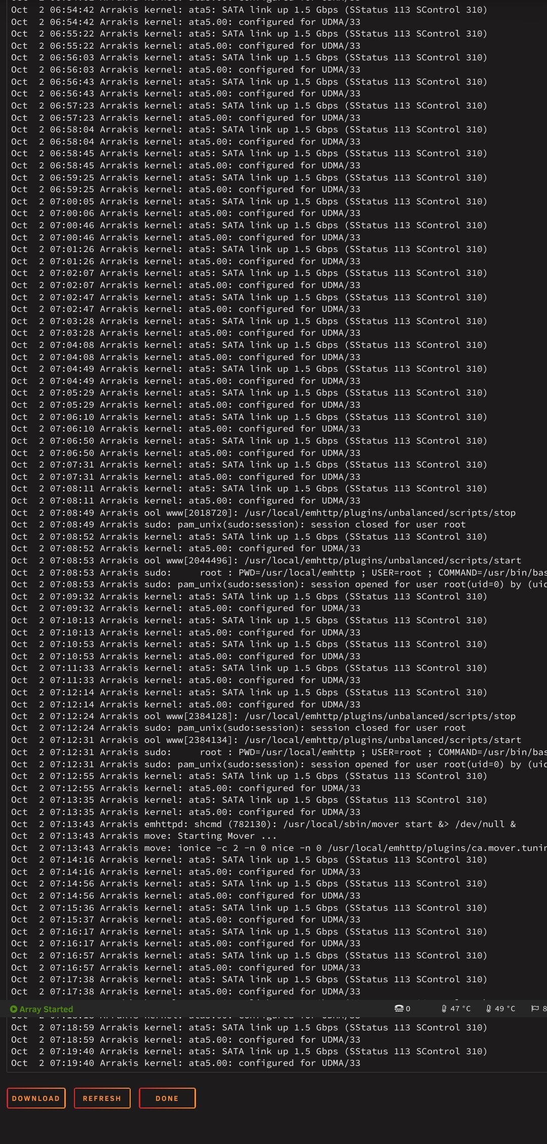

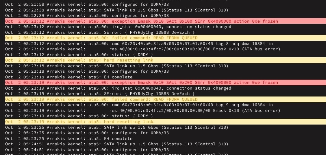

Thanks I will do, but I think I found the issue, so there is a problem with one of the HDD's, I have added 2 drives recently, they are working fine, but sata cable access in my case are terrible. And I am using thin sata wires, I suspect I have damaged on of them as I am getting a lot of weird errors on one of the drives and I could even hear it spinning up every 30 sec etc. This is few months old device which contains no data, and as everything started when I was messing with wires I suspect I just need to replace it..

That looks more like a power/connection issue, try replacing the cables for that disk first, but it would also be good to see a SMART report.
Power cable was power not seated fully :) I will check mover log tomorrow morning.
