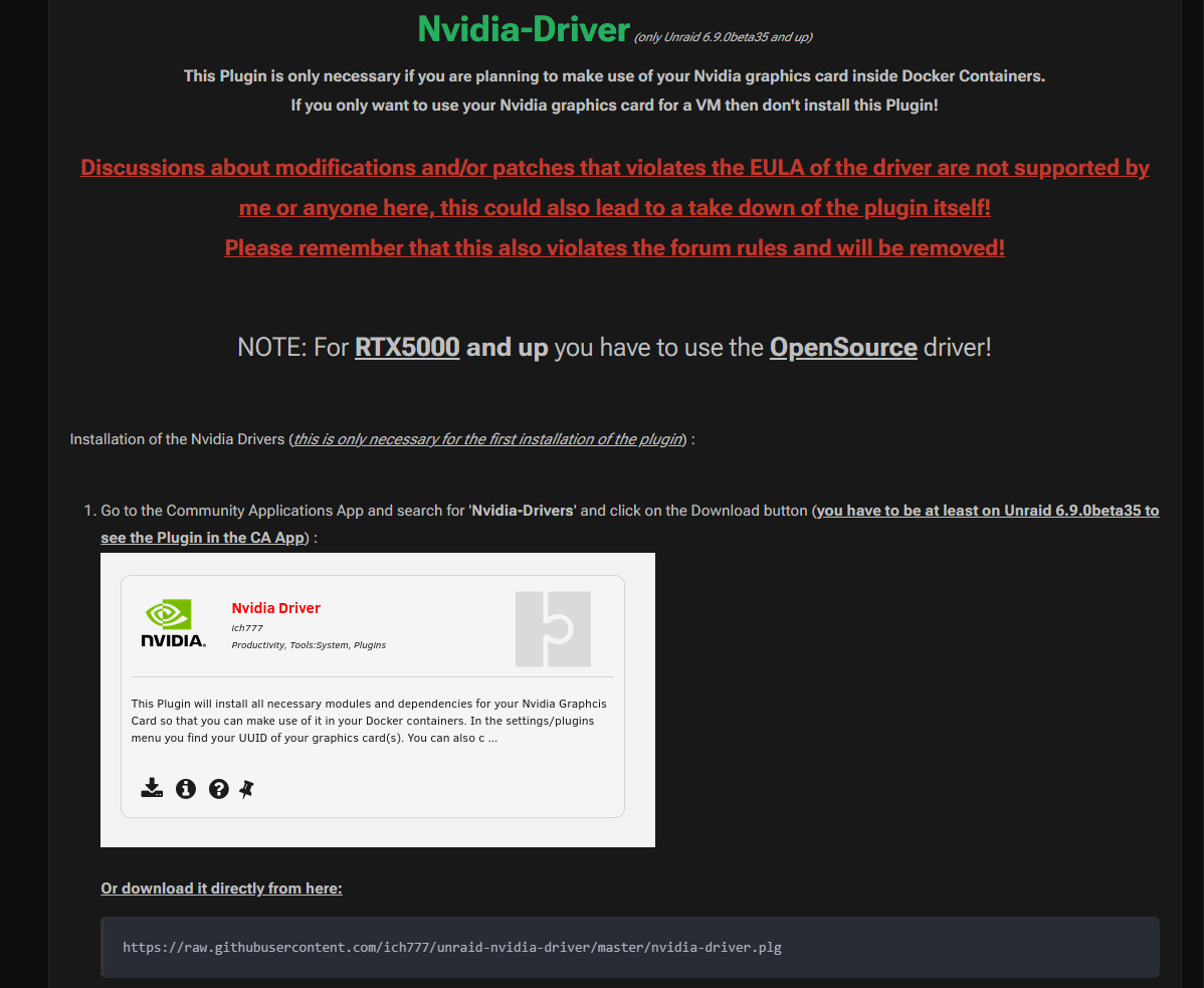

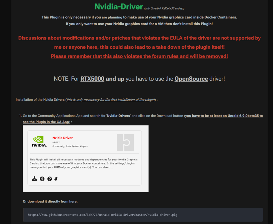

also for the nvdia rtx 5000 series did you take a look at the nvdia support page???
https://forums.unraid.net/topic/98978-plugin-nvidia-driver/
