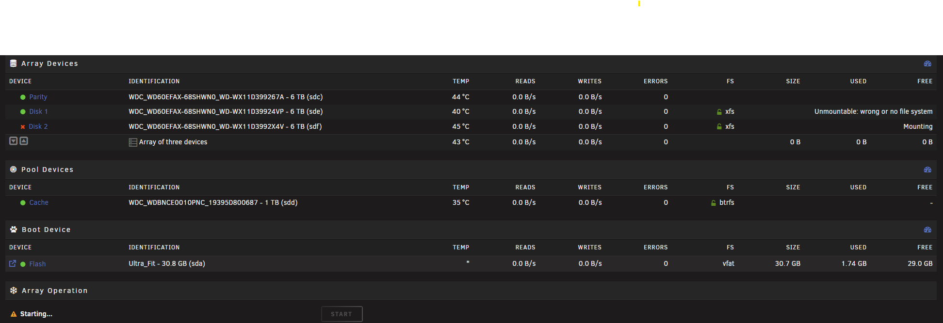

Post a screenshot of Main - Array Devices after trying to start the array.
Here is the screen shot when trying to start the array. image.png.d1df2f21a43138a0c859c3eb02341a12.png
