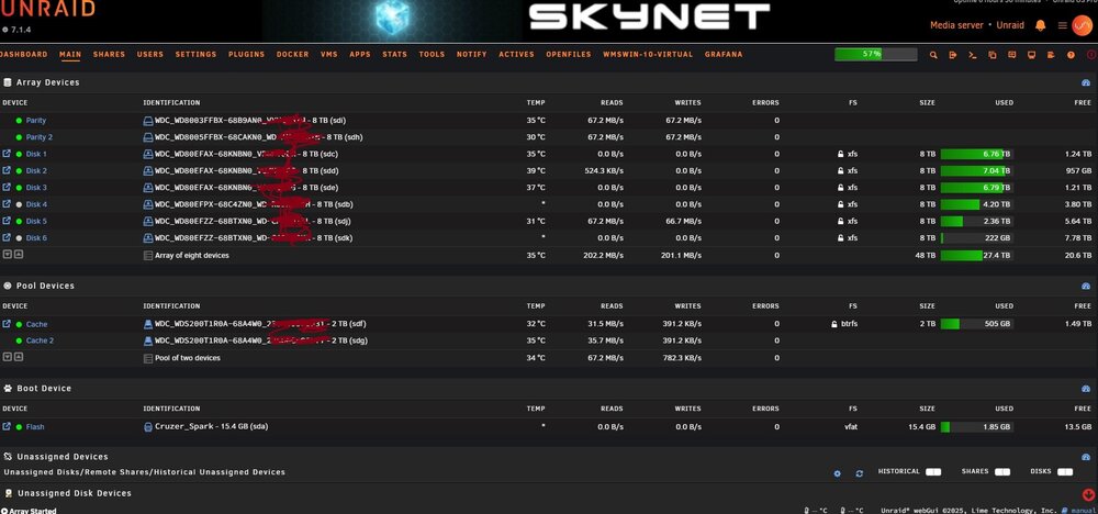

Is the parity write/calculation OK?
I noticed that when writing data to the array, some drives are not reading the data. Is this OK?
Unraid 7.1.4.
Edited by Arnavisca
Solved by JorgeB
This is normal; with standard write mode, only the parity drive(s) and the drive being written to will show activity.
OK. I thought that to calculate parity you need to read from all the other disks in the array.
That is true for calculating the initial parity.
It is also true if you have ‘Turbo Write’ enabled to improve array write speed.
I understand. I always had "turbo write" turned on, and then a week ago I turned on the "disk spin-down function". And if some disks are not spinning, then the write is in standard mode.
