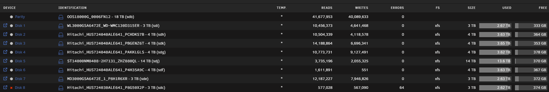

Looks like I have had my first disk fail. I got this alert yesterday
Subject: Alert [TOWER] - Disk 8 in error state (disk dsbl)
Description: Hitachi_HUS724030ALE641_P8G50X2P (sdc)
Importance: alert

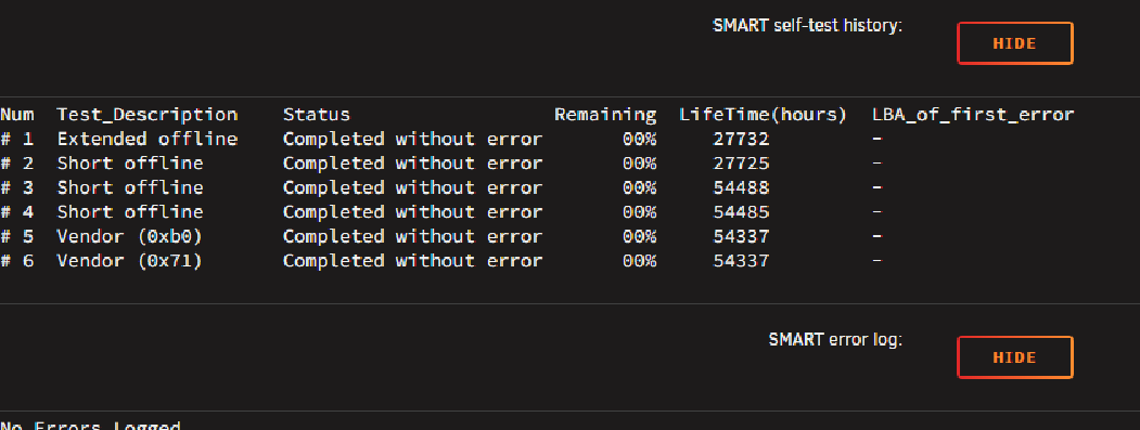

I powered it off and switched the power and sata cables. Its running an extended test now, but here is the short self test results:
tower-smart-20251007-2341.zip
The extended SMART ran last night I think its clean...
tower-smart-20251008-0815.zip
but I'm not sure. The self test history runs all say "Completed without error"

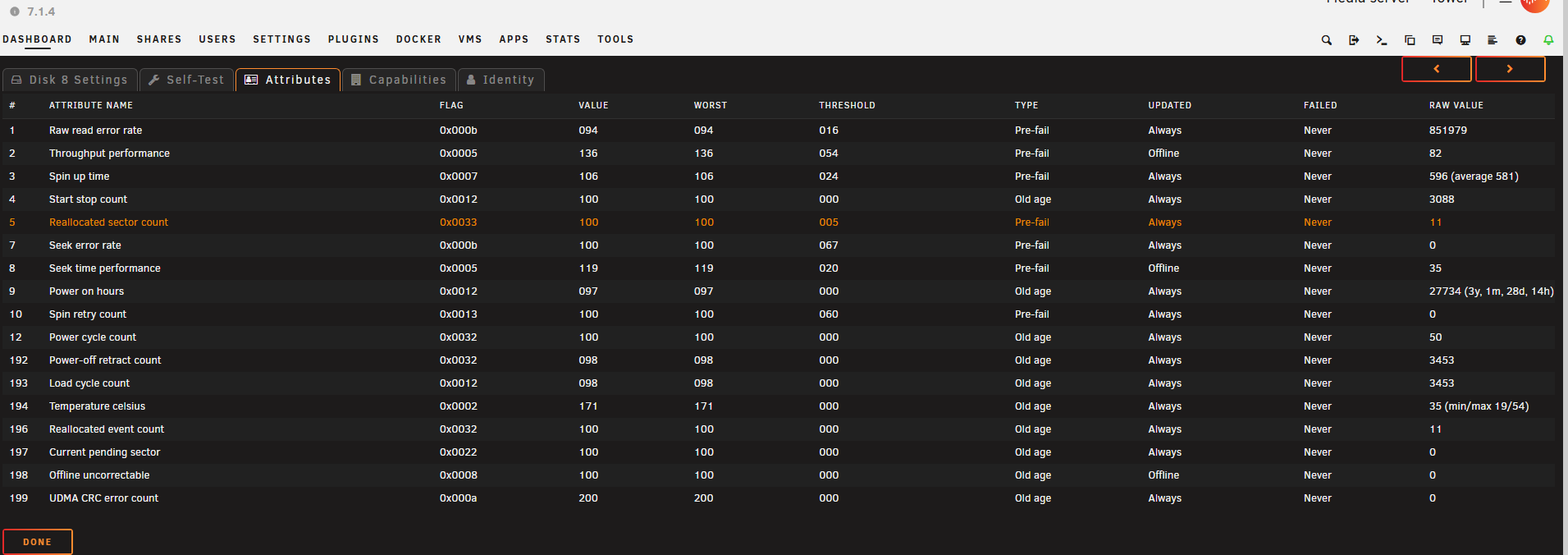

but the attributes tab on the disk has an elevated reallocated sector count:
Does this mean that the disk is on the way out?
Disk passed the extended SMART test, so it's OK for now. Those reallocated sectors are probably not new, but if they keep increasing, it's not a good sign.
