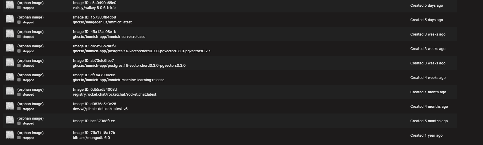

go to advance view:
click on the bad image or old non existing images and delte them:
then delete the docker and remove it image:
make sure the box is checked:
as we need unraid to initate a new docker pull for the tempalte.
once the old images are gone. and immihc, postgres and redis are gone.
reinstall them. as unradi still has the tempate data and your server data is still on disk...

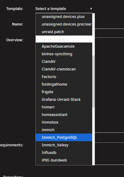

click add container:
in the drop down list:
re select the docker you deleted and apply it to intatea docxker image pull and have the docker back
