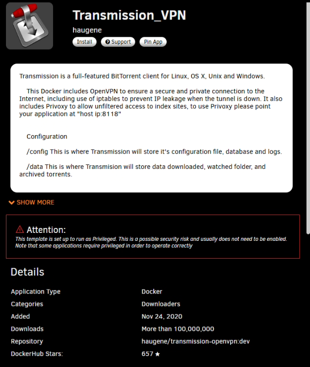

Activ-transmission vpn is no longer available in the apps, so I installed haugene transmission-vpn, but I can't get the GUI to work. I keep getting a 404: not found, and I'm stuck. I configured the docker with my PIA credentals and pointed it to my local network, but I'm not sure what else to do. I've read through all the documentation, and nothing seems to be off with the config. Please understand, I set this up many years ago and have no recollection of how.

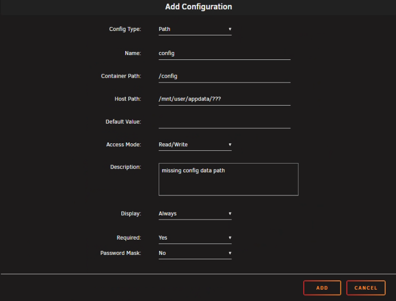

esential the older docker image and data that had your previous data was wiped when you cleared the chage drive. and the template didn't have nor contain some of the data. as docker temples are on the flash drive unless you ran them a different way like compose / docker run user script lines...

Thank you for clarifing. I would recomend using docker compose (more to easliy add and use mutple networks...
there’s a solid all-in-one: haugene/transmission-openvpn. It supports PIA (OpenVPN or WireGuard), does automatic port-forwarding for PIA regions that allow it, and exposes Transmission’s web UI.
Below are two clean ways to run Transmission behind PIA. Pick A (two-container) if you specifically want to use that PIA container you linked; pick B (all-in-one) if you want simpler ops.

I used option B and the unraid template. It seems to be up and running, except I can't find where the data is being downloaded.
I left these as they were, but I don't know where that data folder is. I've looked in every folder and I'm not sure how to change it to a folder I recognize.
I apologize for sounding like a total noob. I used to work in IT and know this stuff but I switched careers about 15 years ago and have apparently forgotten everything.
 -v /path/to/data:/data \
  -v /path/to/config:/config \
ok no worries. I assume your using this CA template the:
the above is example as the tempate essential builds a docker run line
you may need to click the advance togle at the top right some setting and options are only avliable with that togle
so in the above docker run shared. I gave exampels not direct paths.
the bare mini as well.
so the data folder should be located to /mnt/user/T_Media/Torrent/ unless you set its path
and the config folder path doesn't exist in the current CA template
image.pngeven with the advance toggle and show more settings.
I was pulling data form there docker hub / git hub.
The have adatioal support forum found here
https://forums.unraid.net/topic/60143-support-clowryms-docker-repository/
the template is also using the dev tag
github:
GitHub
No image preview
GitHub - haugene/docker-transmission-openvpn: Docker cont...
Docker container running Transmission torrent client with WebUI over an OpenVPN tunnel - haugene/docker-transmission-openvpn
Docker hub:
https://hub.docker.com/r/haugene/transmission-openvpn/
so without it int he tempalte its inside teh docer via termail cd /config
/your/config/path/:/config \
you will have to edit the repositry to a named tag
and add that path:
as ths is the latest image:
sha256:ecc30da79114d801295fd10a5dbaf8640b19707d012fb55be0671ddbe0503037
haugene/transmission-openvpn:latest
per the CA template support forum
Transmission_VPN - Docker container which runs Transmission torrent client with WebUI while connecting to OpenVPN. It also will update the open port every hour for those using PIA only as their provider. Based on Haugene's Currently the Container is set up for PIA with all the available OpenVPN configs listed as defaults. If your provider is someone else then the defaults need to be changed to the appropriate OpenVPN config names found here
Anyone having issues with Watch folder permission issues, please read this POST & this POST
