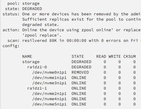

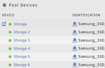

October 10, 2025Oct 10 Author After some inconsistent testing and trying I was able to: Create mirrored ZFS pool and later even 6 disk ZFS pool with 2 vdev's. Now the fun part: In the main tab, it shows all 6 devices in the pool. If I click the pool, under zfs pool status it shows state degraded and one disk from the raidz-1 vdev shows removed. Is not giving me a confident feeling on setup and config.Just asking; what would be best config for such device? Use less disks? use all disks but in different setup or config? Use Array over pool? Any tips, tricks or hints to make best use of this device are welcome. Edited October 10, 2025Oct 10 by Tonee
October 10, 2025Oct 10 Community Expert 45 minutes ago, Tonee said:Just asking; what would be best config for such device? Use less disks?If it's the power issue as linked, use fewer devices or a specific brand/model that uses less power; there are some examples in the linked thread above.
