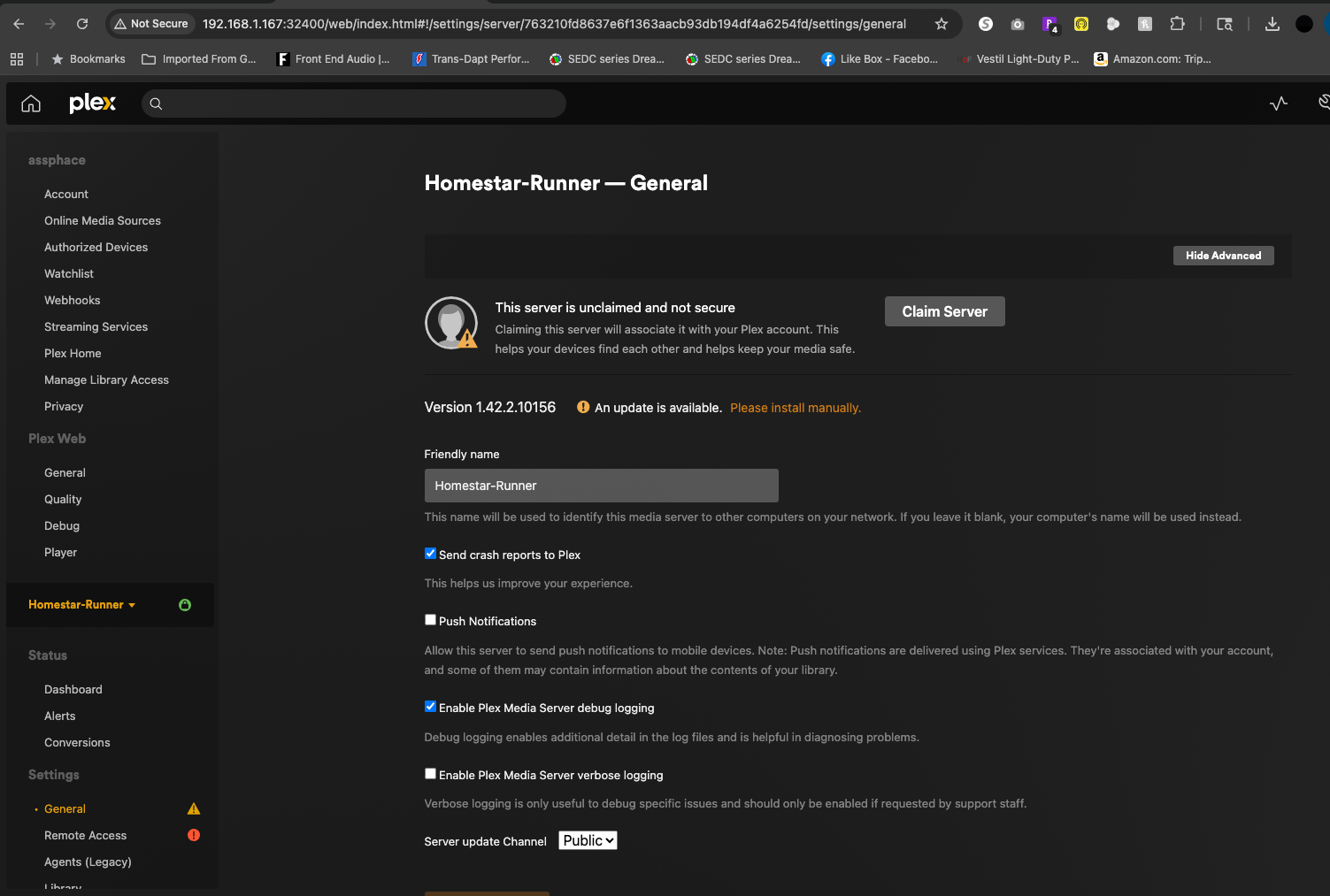

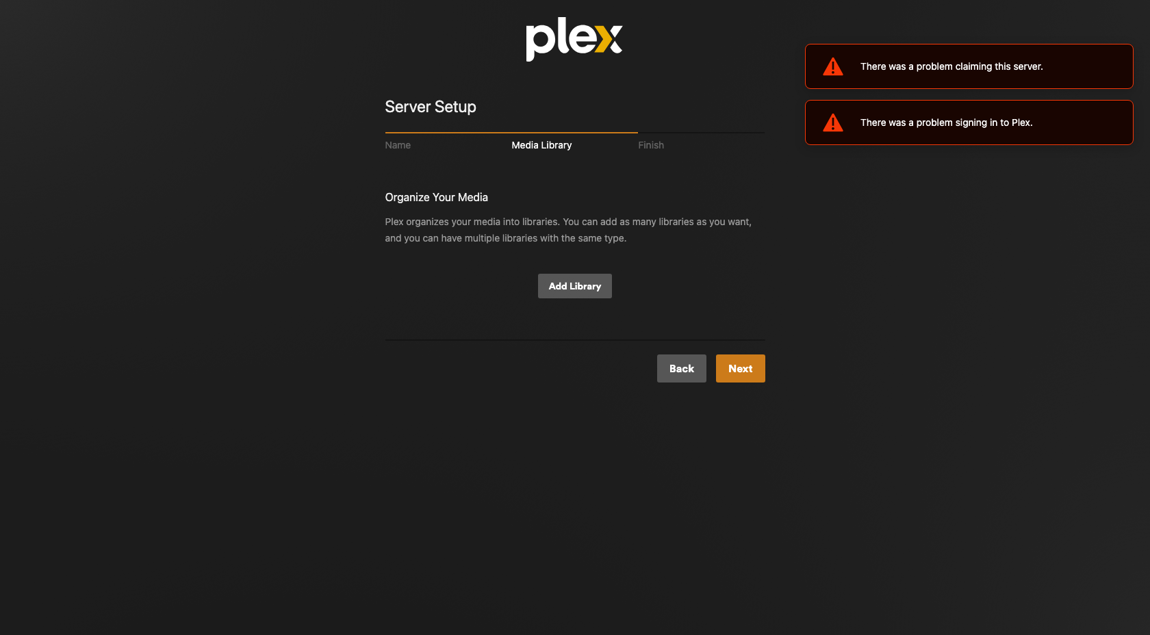

  • If I try to claim it manually via http://[SERVER_IP]:32400, the setup wizard will start, but after I name the server, I get the red error bars: "There was a problem claiming the server" and "There was a problem signing in to Plex."
  • If I use a PLEX_CLAIM token, the container log shows the start-script failing and the claim-script eventually receiving a 500 Internal Server Error, indicating it can't communicate with the crashed local server process.
This happens before I have even added a single media library. The core server process is failing at the most basic level.

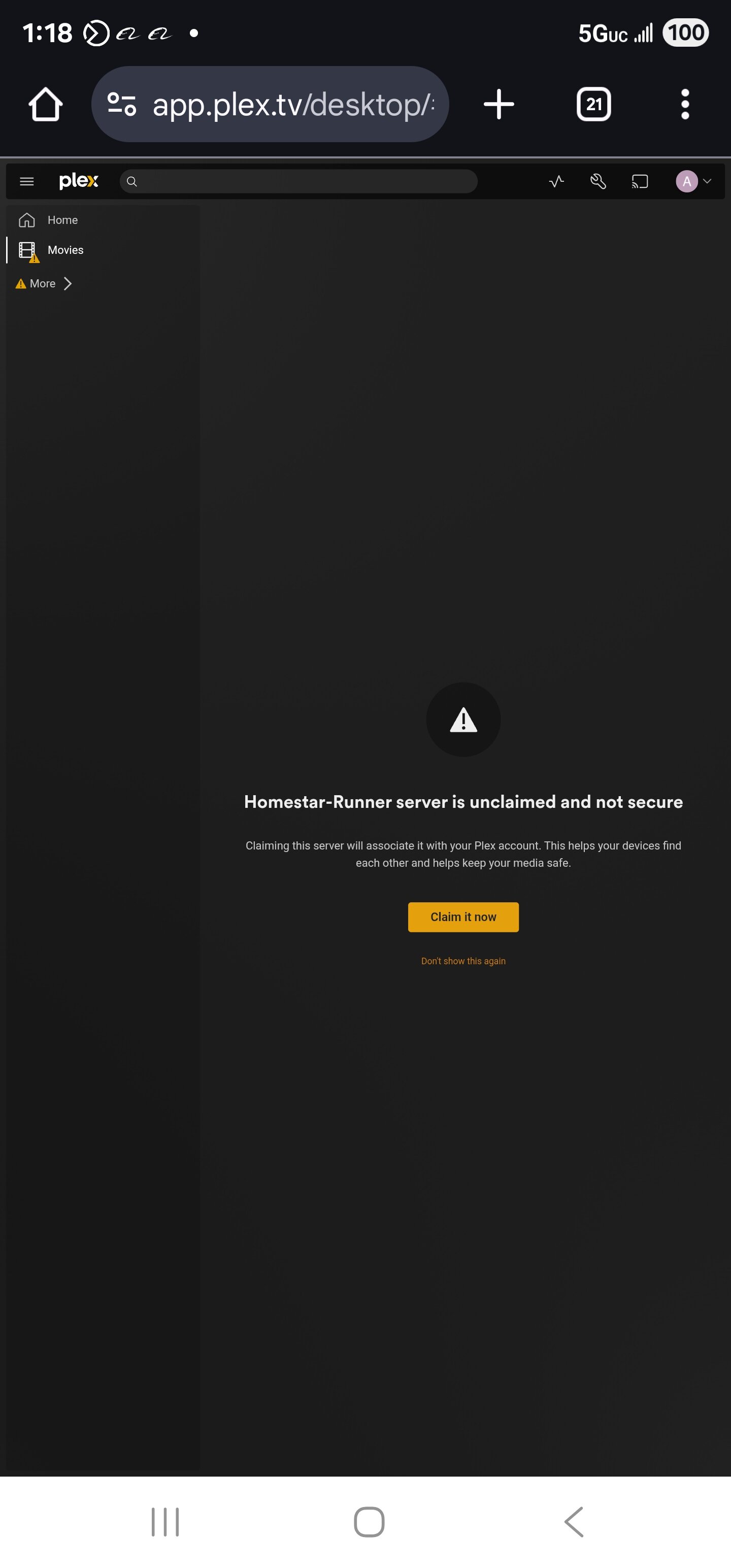

After all of this, the problem remains identical. The log from a brand new container (on a new Docker vDisk, with a new appdata folder) shows the start-script exiting and the claim failing with a 500 error. Here's a key snippet from the latest log:
Plex Media Server is already running. Will not start...
exited: start-script (exit status 1; not expected)
[info] Claim response received:
<html><head><title>Internal Server Error</title></head><body><h1>500 Internal Server Error</h1></body></html>
I have exhausted every possible software, configuration, and common hardware fix. The issue appears to be at a very low level, specific to my server, that is causing the Plex process to crash instantly.

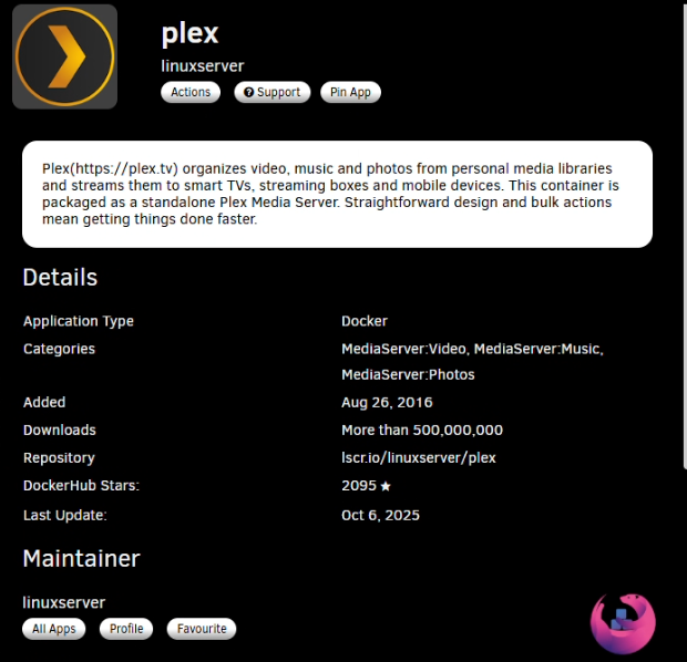

Solved by bmartino1

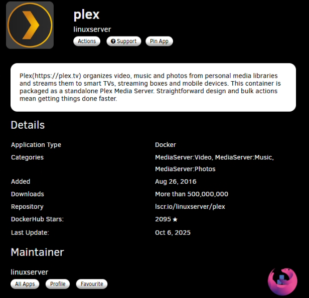

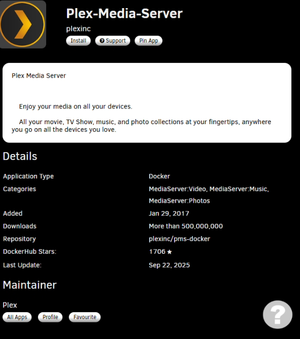

try using plex offical or using plex via linux server.
I've personly have had issus with binhex-plexpass and don't like the docker nor its setup...
again use plex offical:
docker by plex inc that was esetal copied and mainteinted via plex.
or use a trusted docker maker and maintainer like linux io linux server:
if your starting over... I recommend Linux server as they seem to be faster at security and plex updates...

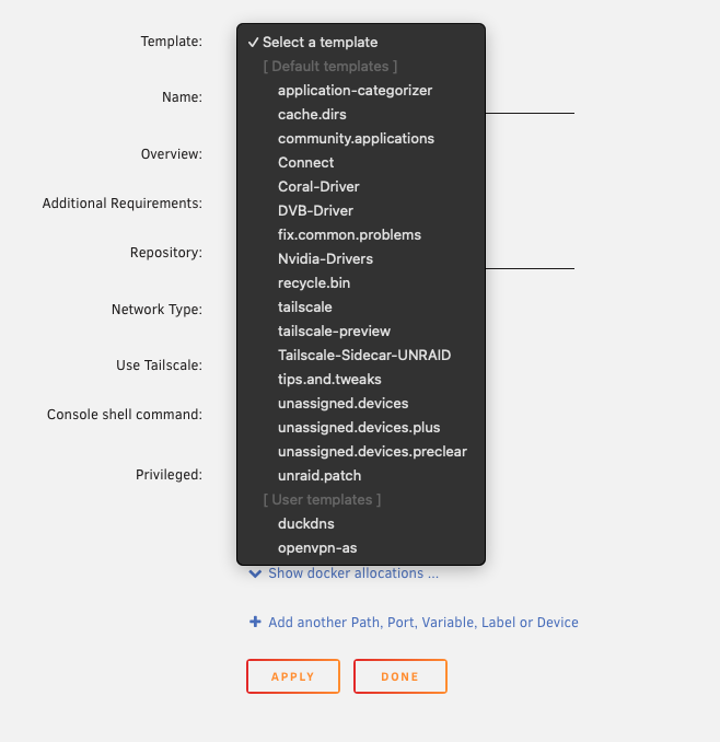

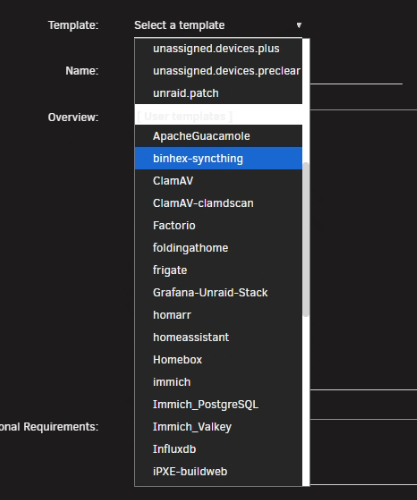

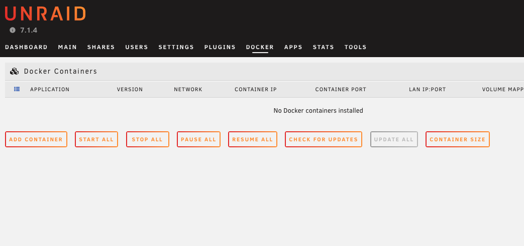

ok with the deletion of the appdata folder. I would start fresh fresh and delte your template and do a docker clean up to remove any bad images.
go to add container:
select anything tha has plex:
and hit the X at the top right to delete the tempalte:

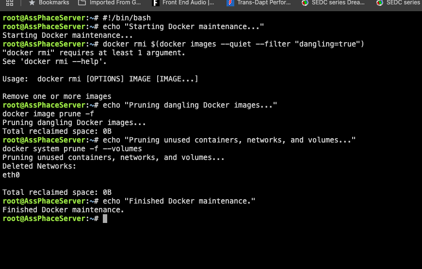

then run this script to clean up and doker image
https://forums.unraid.net/topic/178033-bmartino1-user-scripts/#findComment-1478647
then lets start fresh
so no appdata plex folder. no exisitng plex templates (templates can change...) no pre exsiitng dockers and images...

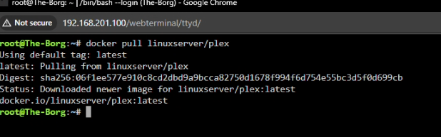

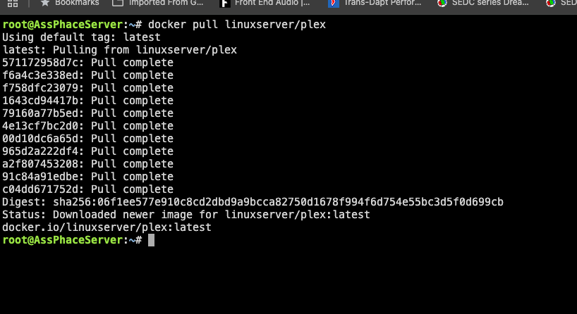

pree pull the docker image.
docker pull linuxserver/plex
close the termainl...
This is to make sure docker adn docker comunication and image pulls are working... and to make the template install form fresh

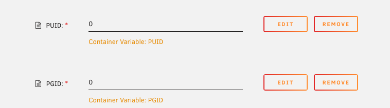

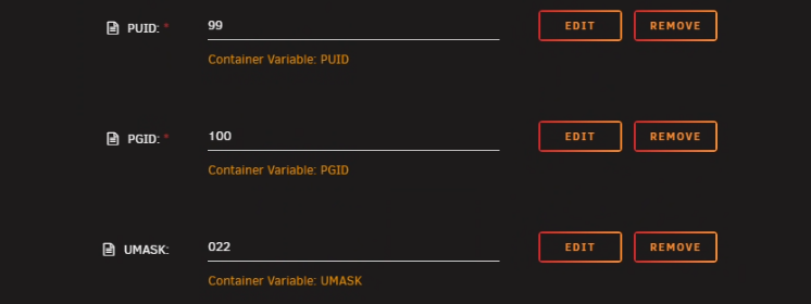

under more setting chnage 99 and 100 to 0
99 -nobody user
100- users group
0- root
we want root to access files (this is a side permission fix.
you may have bad unraid/docekr folder permissions.
docker safe permision tools under settings
chmod 777 -R && chown nobody:users -R

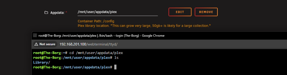

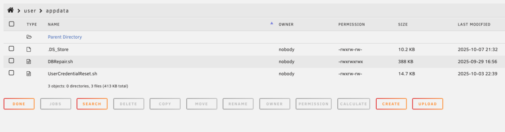

open web terminal and make sure the paths are empty
This way we know before the docker is run that there is a empty path made and used by the unraid tempate and docker for the plex configimage.png
this is where the plex database and xml configuration will latter exist.

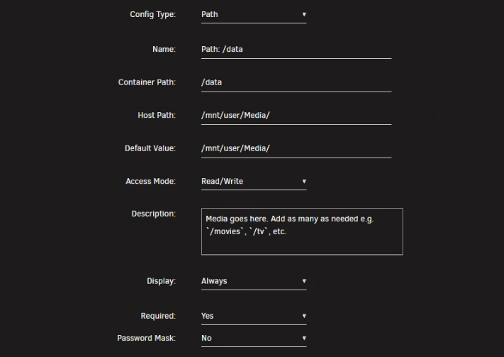

add your plex avilable medai...
Depending on how you handle you movies/TV shows
I have a sinlge folder with TV shows, movies music etc.
latter in plex we will add a libray for movies/tv shows music... by going to /data/movies /tv / etc....etc..

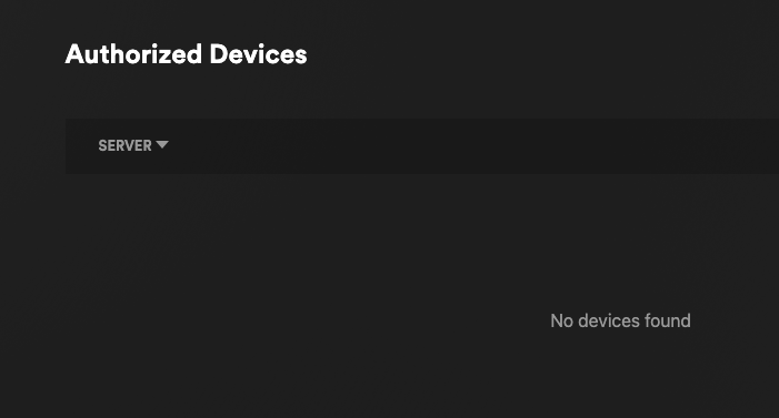

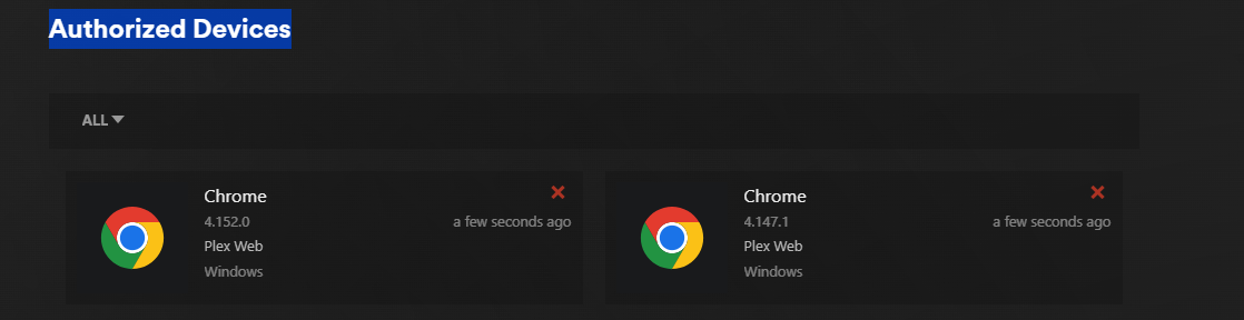

You may need to clear old plex servers form plex as well.
login to plex.tv
go to account settings
hit the red x to any and all auth devices to force a resing in and plex adation to your account.
example to look for:
this way plex api side is not the issues.

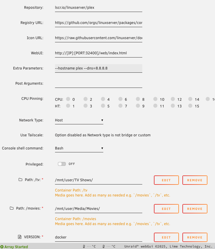

frinaly in teh extar parm add this line to make sure plex is internet reachable
--hostname plex --dns=8.8.8.8
we want a fresh plex image libray created with a fresh plex claim key and libray at a known path I use /data for continer and /mnt/user/media where my p[lex vidoes tvshows sit...
then we can look at g card addions one plex is operational.

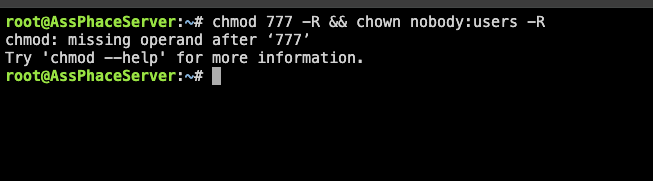

99 -nobody user
100- users group
0- root

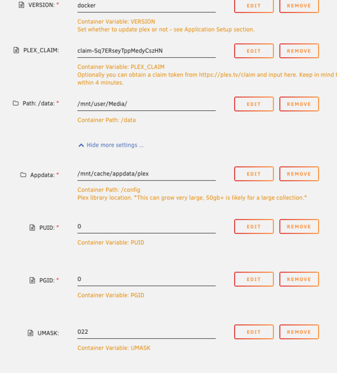

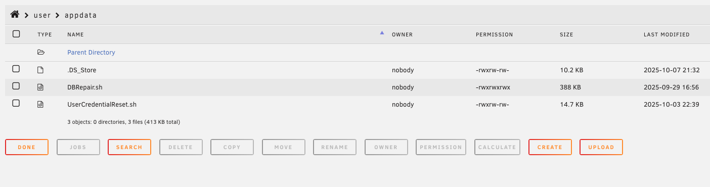

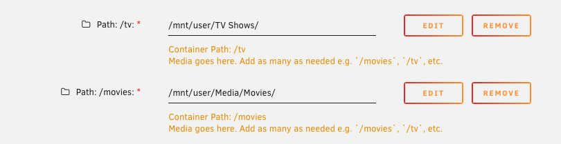

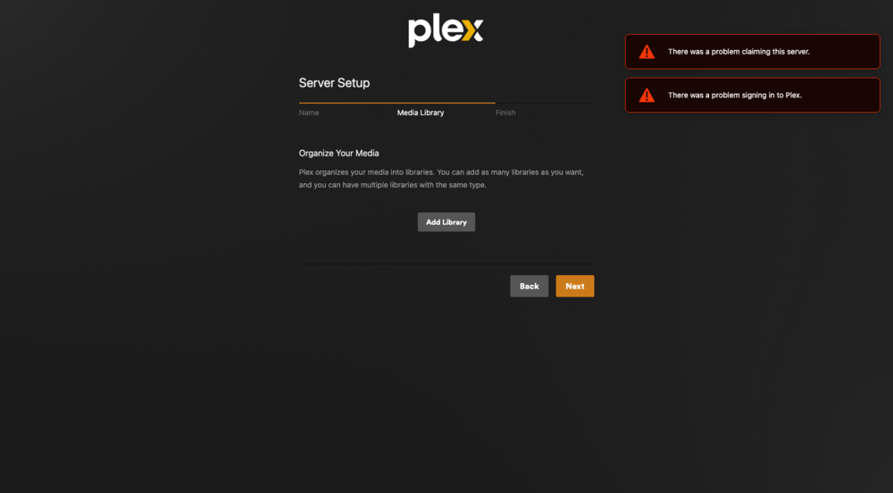

First, thank you SO MUCH for taking the time to help me! I got as far as the docker safe permission tools. I was a bit confused so I paused. Before I commit, is this right? (images attached)

yes looks good so far
image pull is clean, we are using root for a side check with permission (unraid dockers run as user root. Dockers may have continer user ID whcih is why we set linux IO plex to use root as root launched...
user tempaltes are clear.
the extra parm using dns 8.8.8.8 as there have been some issues in the past with fresh plex and claiming this sets a public internet dns for use within the docker.
--dns=8.8.8.8
other then taht its double check that your plex.tv plex account has the old plex servers removed.
Edited by bmartino1

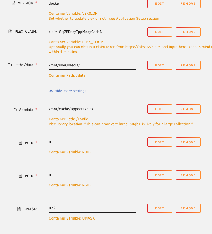

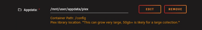

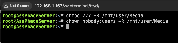

My only sugestins atm would be premake fodlers and set docker safe permissions:
The plex appdata config folder
mkdir -p /mnt/user/appdata/plex
Set docker safe permissions:
chmod 777 -R /mnt/user/appdata/plex
chmod 777 -R "/mnt/user/TV Shows"
chmod 777 -R /mnt/user/Media/Movies
chown nobody:users -R /mnt/user/appdata/plex
chown nobody:users -R "/mnt/user/TV Shows"
chown nobody:users -R /mnt/user/Media/Movies
this also tells me that we deleted the br0 default ipvlan/macvlan docker network
You may need to reboot unraid to have unraid recreate that network again. (as its best to let unraid manage that network.
since its custom eth0 this tells me that your network settings have bridge and bonding off.

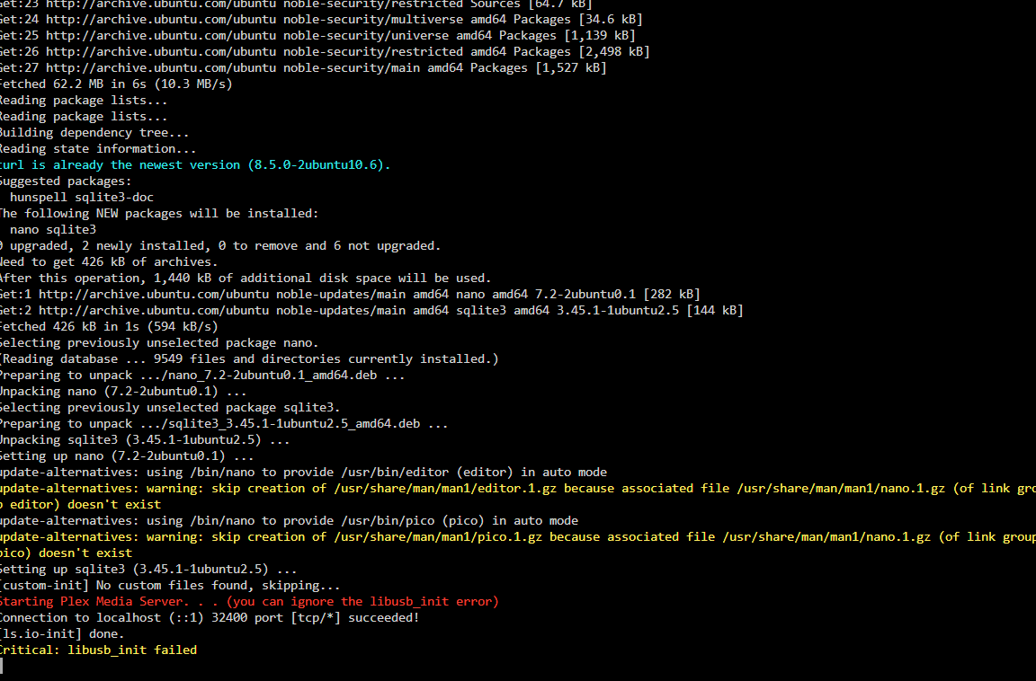

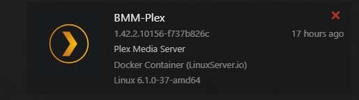

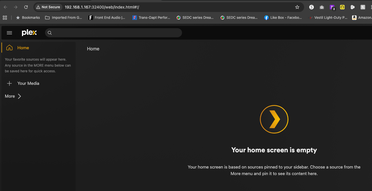

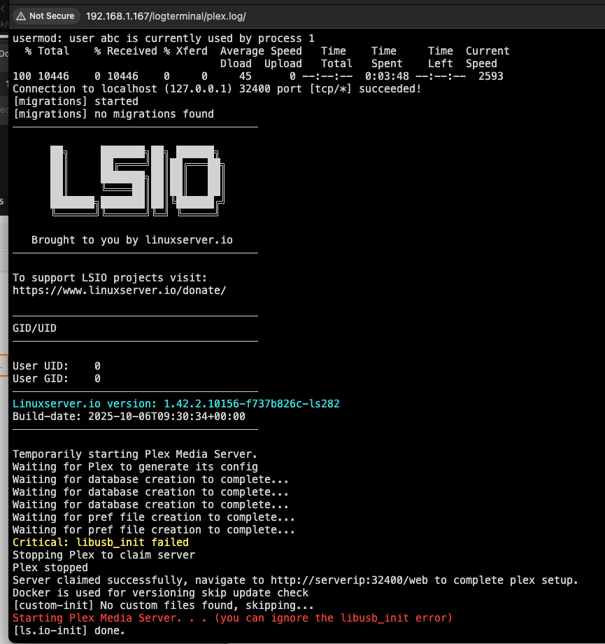

I mean... the log looks good, no? I successfully did the chmod permission thing. The only snag is that going to http://[IP]:32400/web/, the server setup doesn't show.

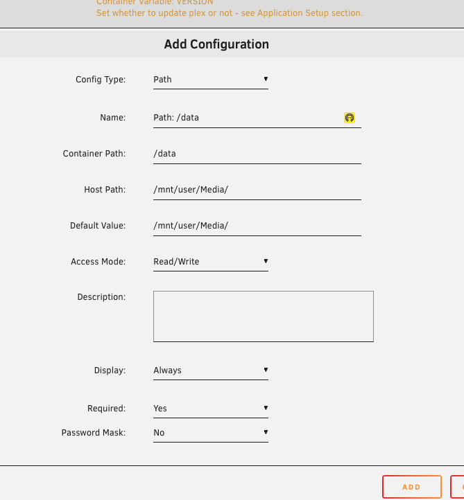

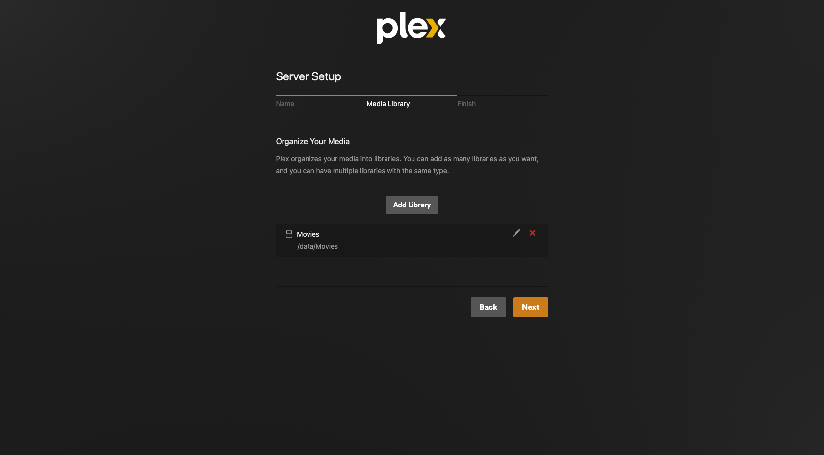

Did the /data path too.

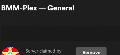

log looks good.
is ther a reason your using network mode host?
*Not a realy issues as you did hit a plex web UI...
as plex requires quite a few ports you should use bridge or custom eth0 set to a lan ip.
Plex claim may not be 100% but your in a good state atm.

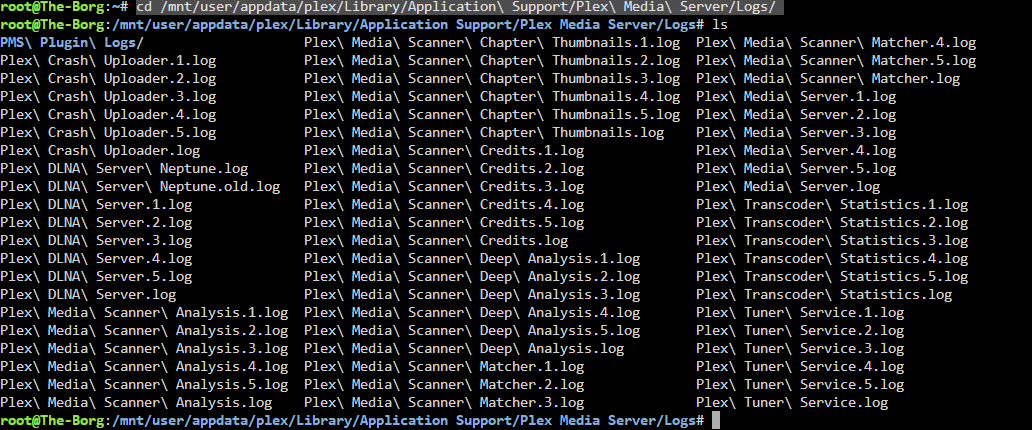

linux server docker logs will not show you plex docker logs.
cd /mnt/user/appdata/plex/Library/Application\ Support/Plex\ Media\ Server/Logs/

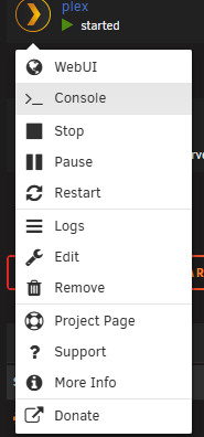

finaly you need to console into the docker and run the command:
ONLY IF YOUR CLAIM DIDN"T WORK> IT APPEARS THT IT DID!
curl -X POST "http://localhost:32400/myplex/claim?token=YOUR_CLAIM_TOKEN_HERE"
curl -X POST "http://localhost:32400/myplex/claim?token=claim-Sq7ERseyTppMedyCszHN"

  2. From the Plex advanced settings, delete the PlexOnlineToken value, and keep the name.
    1. cd /mnt/user/appdata/plex/Library/Application\ Support/Plex\ Media\ Server/
  3. Also from the hidden settings, copy the ProcessedMachineIdentifier value as it will be used to generate a claim token.
    1. nano Preferences.xml find the options Pelx Onlines adn other near the end of the long line of the file...
  4. Open a Web browser and log in with your Plex account. Go to plex.tv and login...
  5. After logging in, go to https://www.plex.tv/claim to generate a claim token. Copy this token.(reuse the one you have. or be quick the claim tokens don't last very long and you may need a different claim token...
  6. From a terminal window, run the following command:Replace {processed_machine_identifier} with the value from the ProcessedMachineIdentifier setting, and {claim_token} with the claim token from the Web page.curl -X POST -s -H "X-Plex-Client-Identifier: {processed_machine_identifier}" "https://plex.tv/api/claim/exchange?token={claim_token}"
  7. At the bottom of the response should be the following values:Each value will need to be copied into the Plex advanced settings with the following key names:
    • username
    • email
    • authentication-token
    • PlexOnlineMail: email
    • PlexOnlineUsername: username
    • PlexOnlineToken: authentication-token
    • AcceptedEULA: 1
    • PublishServerOnPlexOnlineKey: 1
  8. Restart Plex Media Server docker and you should now have the server claimed to your account...
    Annoying I know. But I can guarantee a claim this way... as we are esentail builing the plex Preference XML as plex is working but not claimed adn setup didn't start as plex api didn't see a new server claimed...

warnning
did you stop start the docker?
Weird that you didn't get a plex library setup by goin to http://192.168.1.167:32400/web
However you should be able to login to your account. then in the plex server at the ples UI go to settings (may not be there if its not calimed.)
So acount login at top right.
Go to the wrench (settings)
In the tab at the left General
there you can force a Plex account login and claim calim by login into the plex account. (soemtiems needed due to plex api new ip and 2fa...)
in the web ui as well if you see the wrench yo should also be able to see the loging..
Review:
https://youtu.be/EULsFwZB-Uc?si=jz75QMWMPkSlkUYo
With linux seerver we alos can get linux IO support on github:
https://github.com/linuxserver/docker-plex/issues/235
and use a plex script int he docker.
https://github.com/ukdtom/ClaimIt/blob/master/linux/claimpms.sh
Edited by bmartino1
but as you did get a successful claim you need to docker stop then wait for the stop and docker start plex once more.
then go to: http://192.168.1.167:32400/web
then go to the plex web server.
as your Preference XML should have some new plex claim data.
Edited by bmartino1
Stop start seems to have worked. It still gave me those two errors after adding the server friendly name. It's currently adding media. Should I wait to go to General and Claim?

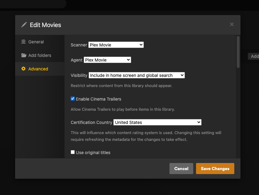

For some reason it seems to be trying to use the tv.plex.agents.movie agent even though Plex Movie is selected for both Scanner and Agent
....... back to the unclaimed loop 🤦‍♂️
Trying to reach it from outside my network. I was able to successfully claim in via the Web UI after a couple of attempts but now it's back to this.
this mean we waited to long to use that claim key. pelx shorten new claim keys to claim a server in like 5 ish min. and it made caliming servers harder on docker.

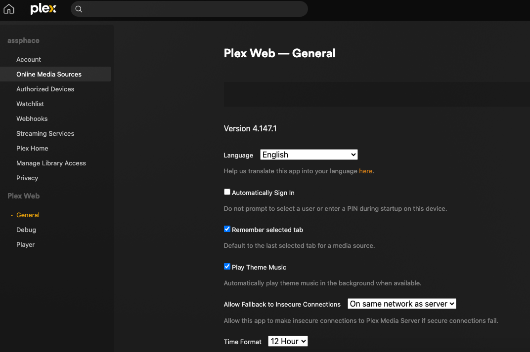

this is why the setting general exists. once in a plex UI tools we can singinto the acocunt and claim,
So we may neeed to edit the preference XML and reclaim the key once more.
Normal claim path (fastest)
  1. Log into plex.tv and visit https://plex.tv/claim to get a token.
  2. Put that token in the container’s PLEX_CLAIM env var.
  3. Start the container immediately (token expires quickly).
  4. Visit http://<unraid-ip>:32400/web/ and sign in; the server should appear as yours.
    This is exactly how LinuxServer documents it for new setups, especially in bridge mode.
https://docs.linuxserver.io/images/docker-plex/
Manual fallback (works even when the wizard bugs out)
If the wizard errors or the UI won’t show “claim”:
A. Quick method (usually enough)
Replace with your fresh claim code. Then stop and start the container once. This exact approach is what solved claims for many users (and is what I recommended in the thread as noted above).
since the docker is working, your in a plex UI. Here is a script for Manual fallback (works even when the wizard bugs out)
please grab another plex claim key and fill in the claim token in this script and run...

in extra paramerters where we added the DNS. we can use linux IO to install linux pacakges inside the docker.
-e DOCKER_MODS=linuxserver/mods:universal-package-install -e INSTALL_PACKAGES="curl nano sqlite3"
sqlite3 give you the abilty to fix and run sql comands for the plex database latter if you hit plex database coruption. nano is a text edito to open and edit files and curl (should be there) but is used to manaul claim the key...
this will make sure hte other applicaiotn are installed and working:
once plex is claimed and working stop start plex api claimed shown in auth devices.
remove nano and curl...
Edited by bmartino1

It says it worked but the UI doesn't show claimed:
root@AssPhaceServer:~# #!/bin/bash
set -euo pipefail
# Set these for your box
CONTAINER="plex"   # Docker container name (linuxserver/plex)
APPDATA_BASE="/mnt/user/appdata/plex"           # your container's /config on host
PREFS="$APPDATA_BASE/Library/Application Support/Plex Media Server/Preferences.xml"
# ======= Paste fresh token from https://plex.tv/claim =======
CLAIM_TOKEN="claim-11zympyvYWLrJ8WxDMqw"
# Quick validation
if [[ -z "$CLAIM_TOKEN" || "$CLAIM_TOKEN" != claim-* ]]; then
  echo "ERROR: Set CLAIM_TOKEN to a valid value starting with 'claim-'."
  exit 1
fi
command -v docker >/dev/null || { echo "ERROR: docker not found."; exit 1; }
Tried the other option
I must be doing something wrong
