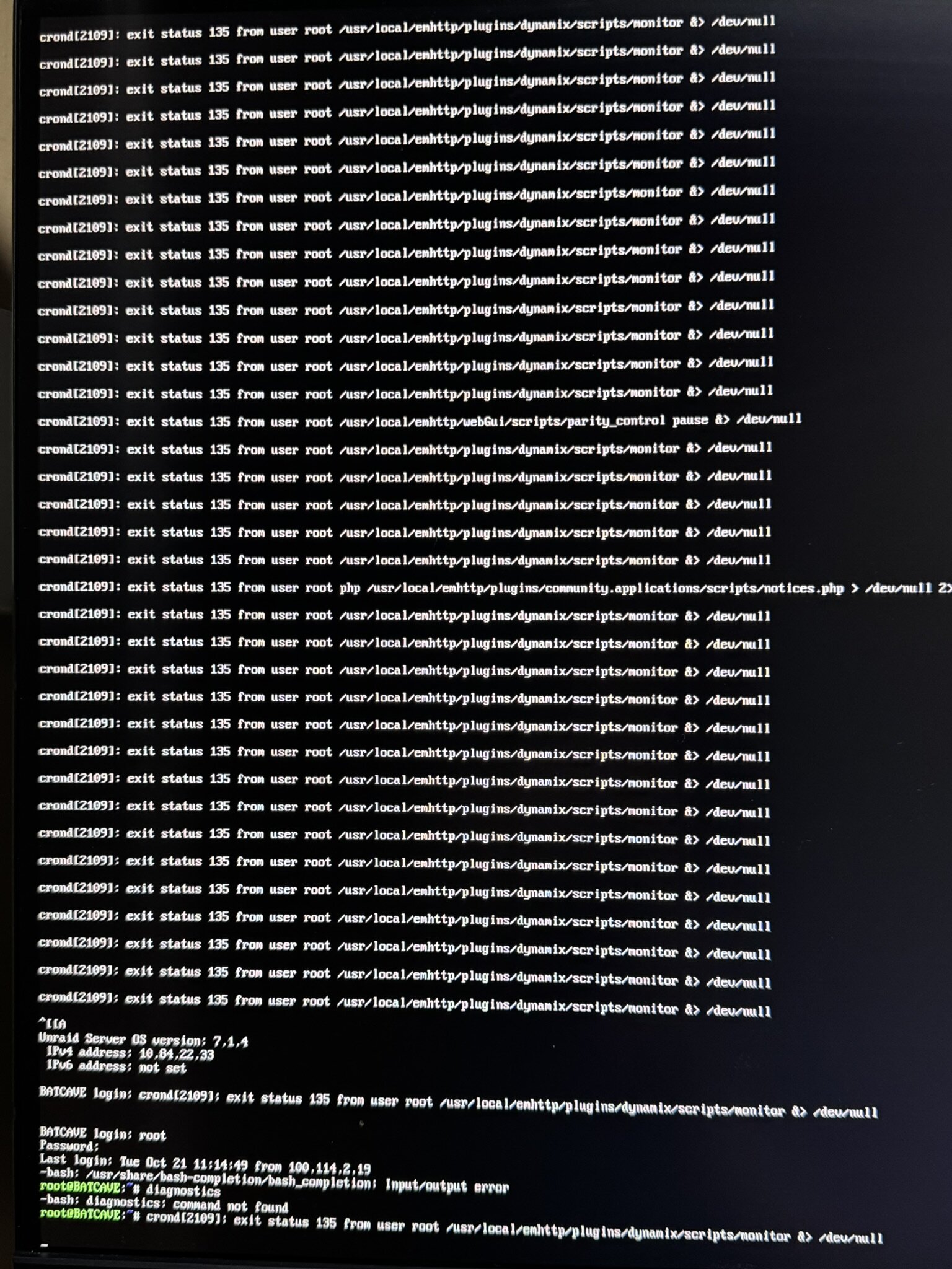

I see crond errors on the monitor screen . Please see attached.
I found the same error matched the issue on this post but no luck in resolution. https://forums.unraid.net/topic/155957-occasional-crashing-unreachable-server/
