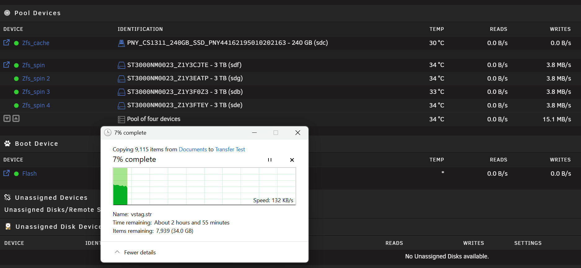

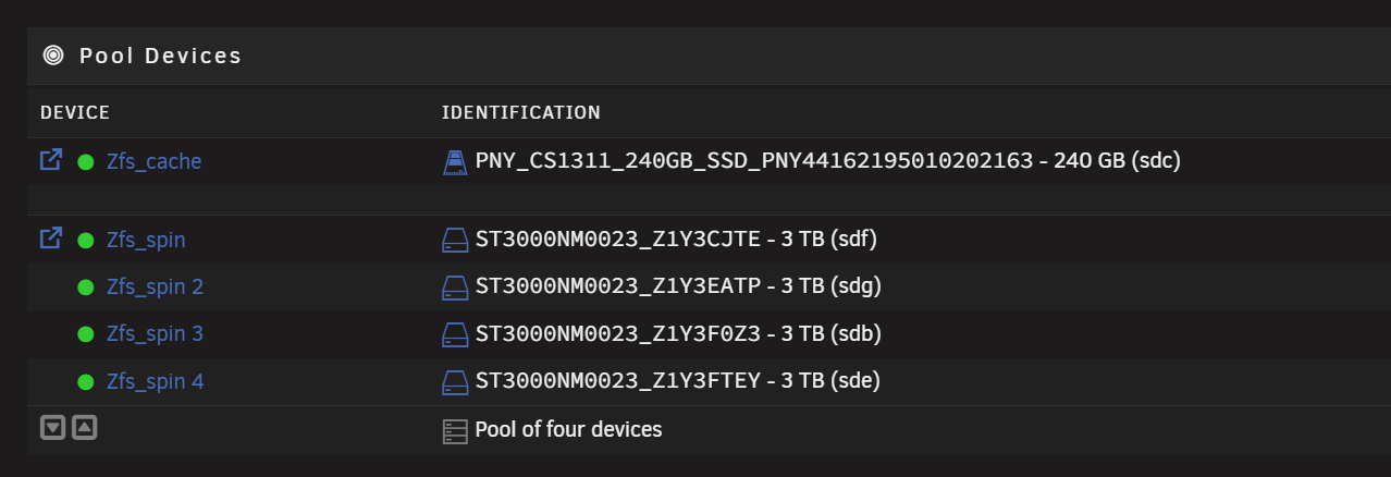

I setup a zfs_pool of 4 HDD's about 3 months ago, and recently decided to add a SSD I had laying around as a cache drive for faster file transfers and I can go do other things/turn off my main PC whilst it then sends the data onto the slower HDD's.
This appears to not be at all what is happening though, everytime I set something transfering it is going straight to the HDD's, looks like it bypassing the SSD completely.

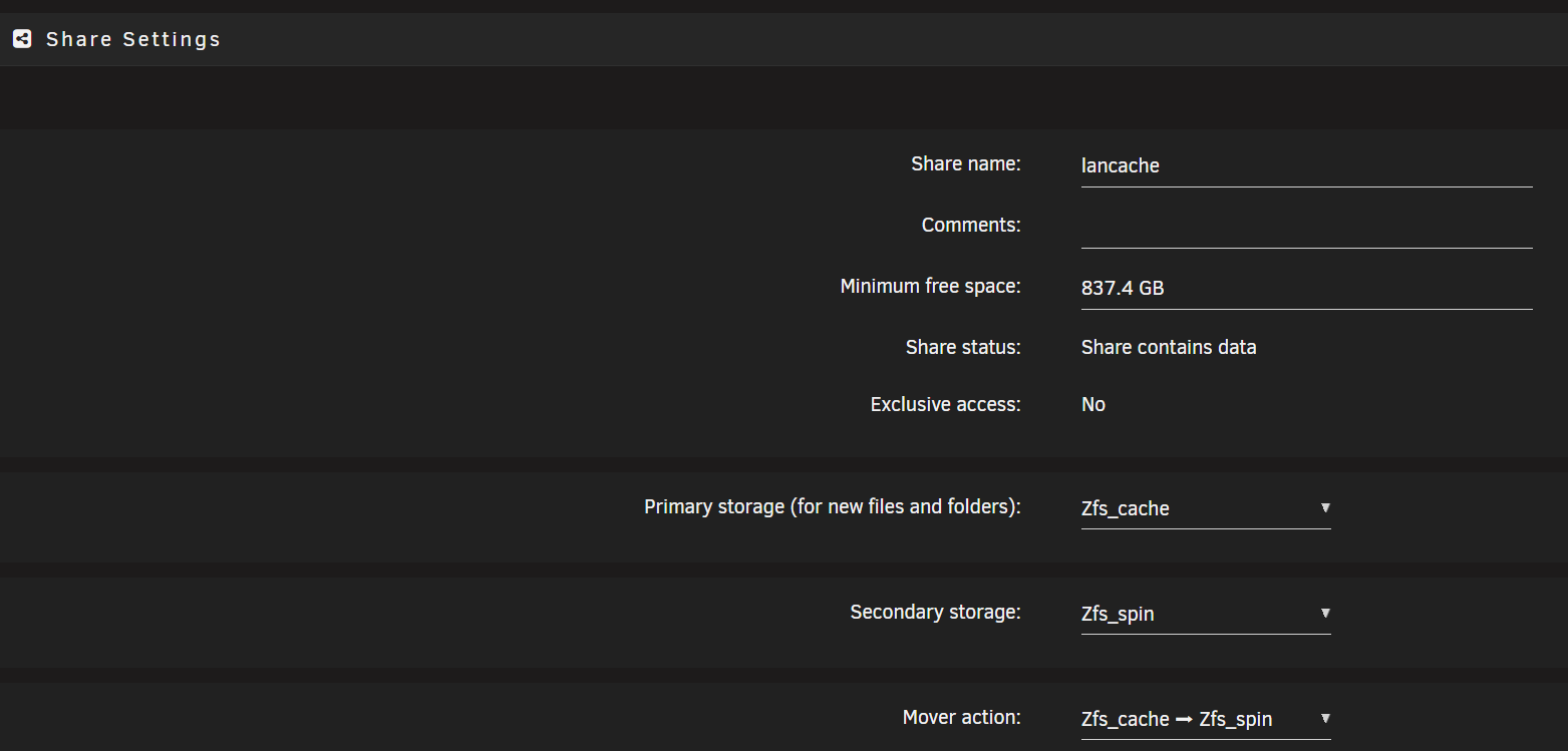

I think I have the share setup correctly so that it should be using the SSD for initial transfer. I am amateur at best and I know if I dont know what im doing I should ask.
Here is how things are setup and I am on 7.1.4
And here is whatI am seeing when I transfer anything at all to the share, in this example I started transfering 34GB to make sure I wasnt mistaking it for using ram or something first, which only seems to grows to around 3gb for info.
I do not see writes to the SSD move whatsoever even 4-5 minutes into the transfer, at which point the speed is down in the KB's......

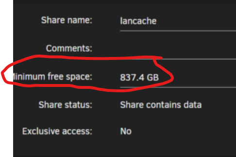

You need to adjust the floor for the share. Since int's higher than the current SSD capacity, it will be skipped and written directly to the larger pool.
thanks for the reply, how do I do that?
Change this:
Thank you 👍Its using it now and rock solid at about 258mb/s
