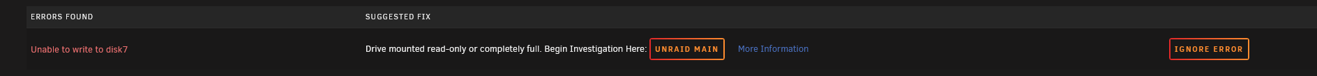

two days ago my server crashed for unknown reasons. Restartet, parity check went through (5 errors, seems reasonable for a crash). In the "fix common problems" plugin I got the error "Unable to write to disk7 - Drive mounted read-only or completely full.", with a link to more information. That info seems to be mainly about caches; it's an array disk tho. If I google the error, I didn't found much info, but restarting seemingly fixed it.

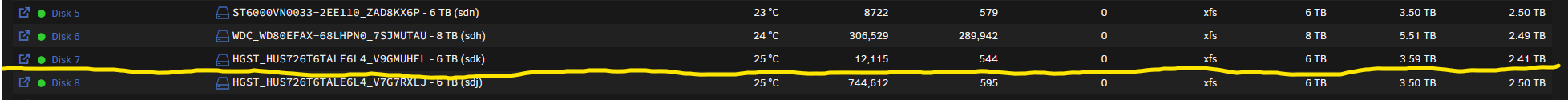

So I did a clean restart yesterday, the message was gone - and now, it re-appeared. As you can see in the screenshot, the disk is not full, and had reads+writes since the restart yesterday, and not considerably less than some other disks. The Main Page also shows 0 errors.
