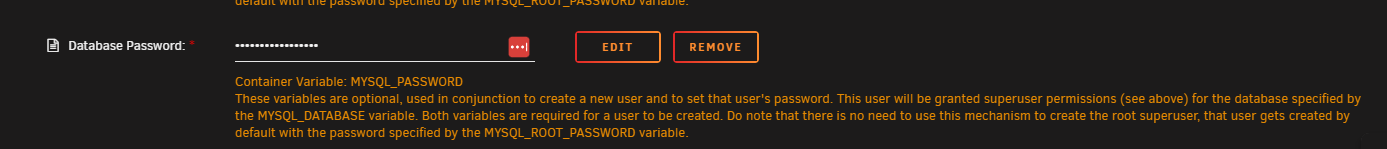

so i have a old maria db instance that was storing a lot of stuff i have lost the root password along time ago and i have also lost the default database user pass all the sub databases i made i kept there passwords safe and can recover them but the main database i cant get or find the pass word for. how ever it is still there as when i try to reinstall it is filled is there away i can get this pass word to then login to it and recover the data there and migrate it to a new database where i will keep a log of the root pass?

Unraid templates are stored on the flash drive.
cd /boot/config/plugins/dockerMan/templates-user/

I can cat my-xyz template and read the xml line.
You might be able to pull the database password from that line...
Example:
root@The-Borg:/boot/config/plugins/dockerMan/templates-user# cat my-mariadb-hive.xml
<Config Name="MYSQL_PASSWORD" Target="MYSQL_PASSWORD" Default="DATABASE_PASSWORD" Mode="{3}" Description="Set this to the password you want to use for you MYSQL_USER (minimum 4 characters and non-alphanumeric passwords must be properly escaped)." Type="Variable" Display="always" Required="false" Mask="true">clonedeploy</Config>
as I did play around with hive farm os for bitcoin miners.. there default password is clonedeploy. Which is seen in the template.
