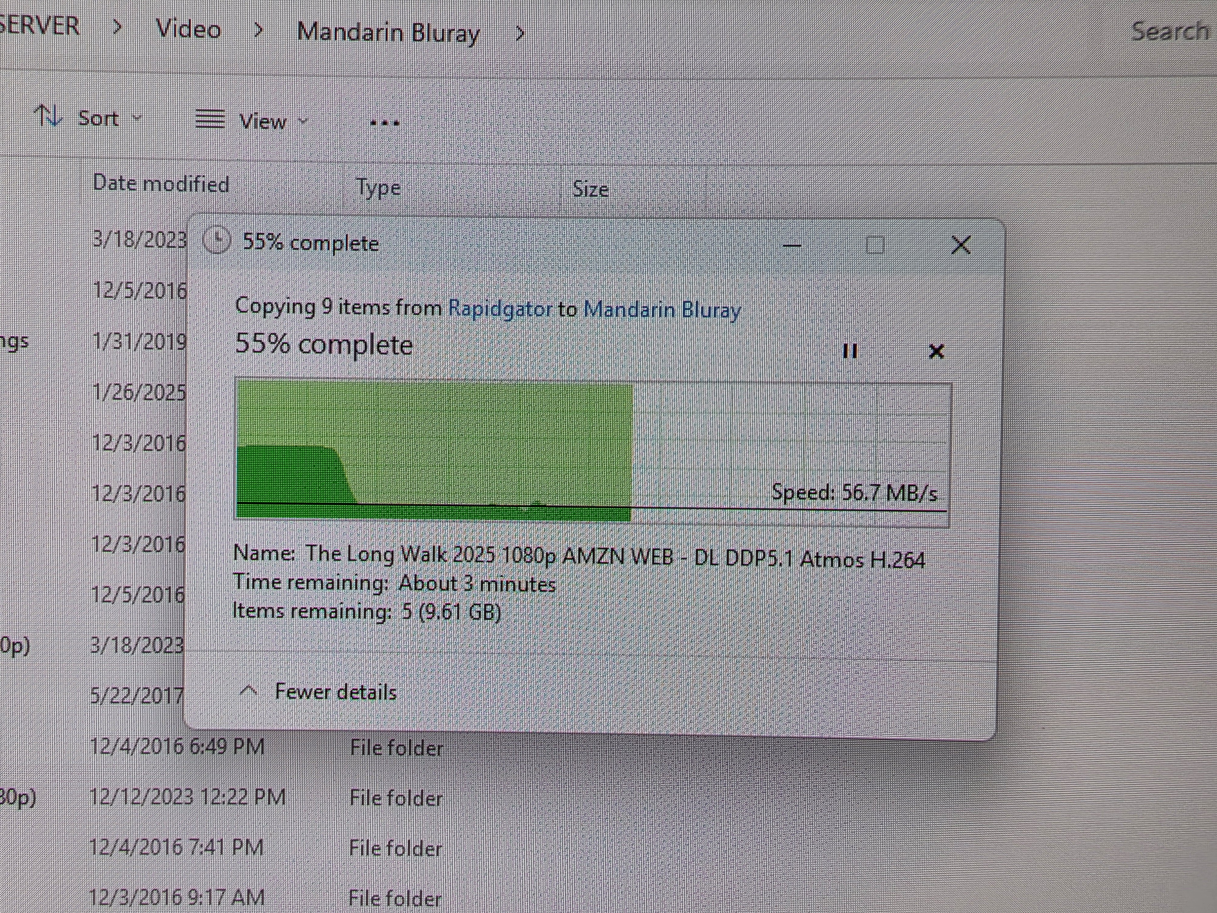

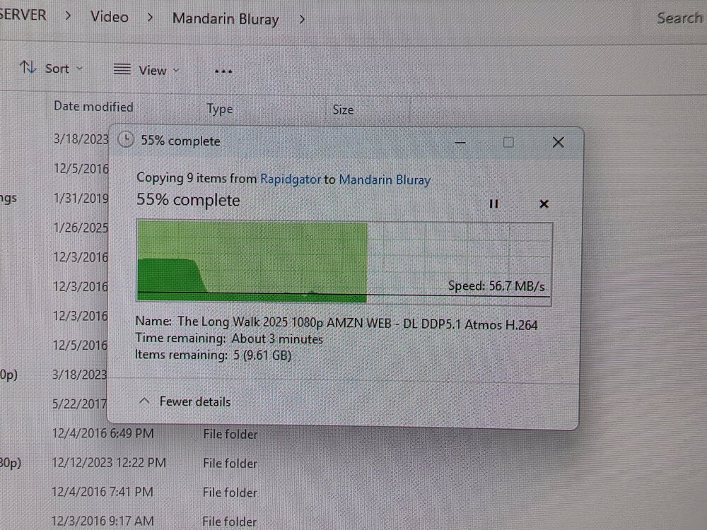

Hi, I just build my unraid, move from synology. Why my transfer speed from PC to external HDD (connect to Unraid using unassigned device) is slow (40-50MB/s) compare to Synology (transfer same file from PC to external HDD connect to synology) I got 105MB/s. Is there any setting to speed up the transfer? I also tried with rsync command transfer file between ext HDD to ext HDD, but not helping, got same speed (40-50MB/s)
When I transfer from PC to Unraid array everthing is normal, I got 250MB/s

That graph suggests the device is unable to keep up with the write speeds, initially it was faster while it's being cached do t RAM, then it's limited by the device's actual write speed.
Yeah but i use wd red plus, it supposes to be 200mb/s. When I transfer to synology I get 115Mb/s coz of limitations of 1gig ethernet.
Do you mean the 6TB WD? That's a WD60EDAZ and according to the internet, it's a WD Blue SMR.
