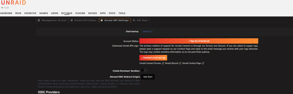

My Flash backup is not working.
I noticed that the backup I have on the cloud is very old. I can't make a new one. It's stuck on loading.
I tried reinstalling the plugin but no change.

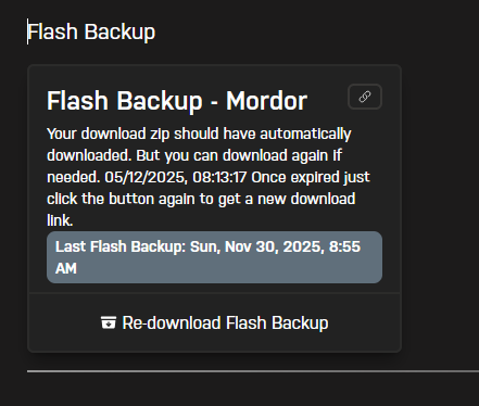

Based on the image from chitalov showing that flash backup was working but then showing a 3 month old backup is not confirmation the bug is fixed. Nor is your post showing its activated but doesn't confirm whether the backup in Unraid Connect actually backed up recently.
So are you just assuming the problem was fixed, or that since it resolved itself for one user that is must be fixed for everyone? Just trying to understand the scope of the fix since its not documented.

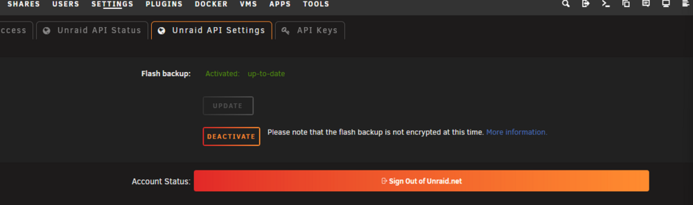

Has i can see from your screenshot you have a different problem, not the same of the post, since you are seeing that the backup in not up-to-date but you do not have an infinite spinning.
When you press Update button what is happening ?
It should spinning with the "Processing..." text and then pass to up-to-date.
I do not know why the other user has August in his Unraid Connect Web Page, but in my i see 30 Nov that is the last time i have made some changes to my system
