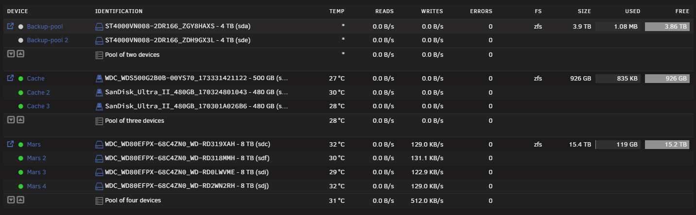

I kicked off a long sync process to backup some cloud storage onto the share and I noticed it's going directly to the Z2 array and not touching the cache. The cache actually "spins" down to inactivity.
Looking at the syslog, I am getting share cache full notices, but the 926GB cache shows 0% utilization.

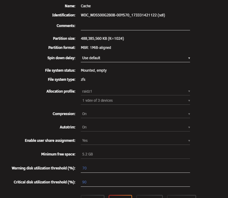

I've got the min free space of the pool set at 5.2GB... roughly 10% of the pool capacity. The default was 0 when I created it, but I did bump it thinking it was the initial issue.

You do not mention which share you are talking about, but looking at the diagnostics the likely shares have a Minimum Free Space setting of 1.5TB and the pool does not have this much free space.
Having said that is debatable whether it is worth caching a share that is on a SSD pool in the first place.
It's not the pool floor,
1 hour ago, JorgeB said:
it means the share you are writing to has a floor set to more than is currently available on the pool
Thank you both! Now it clicked! Reducing Min Free Space per share is doing the trick.
