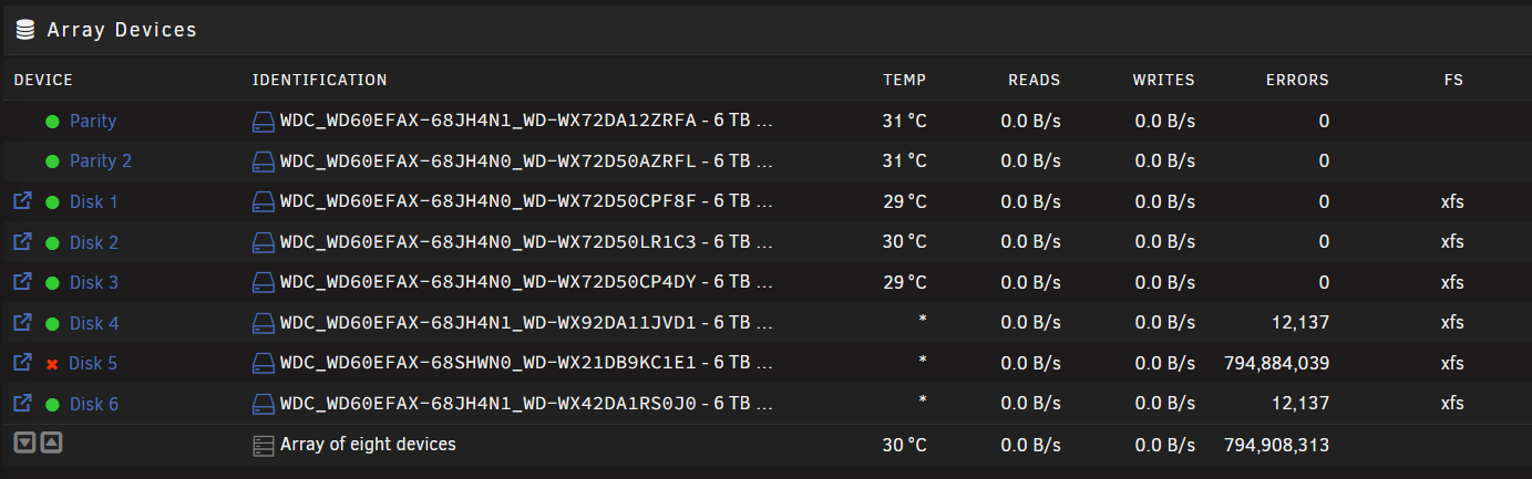

I have 6 data disks and 2 parity drives.
2 of the data disks were error disabled, so I unassigned those and reassigned them to activate them.
While the rebuilding was in place, a third disk began to give read errors. --> "Data-Rebuild finished (794882269 errors)"
What would be the best steps to verify what data is lost or corrupted?

Yes, Disk 4 and 6. It took about 18 hr and 35 min, about the usual time to complete.

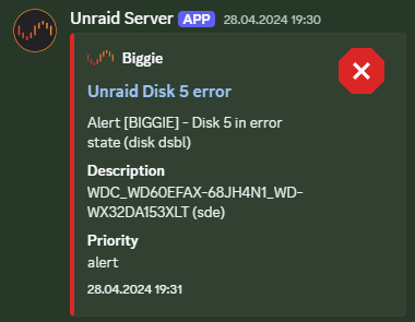

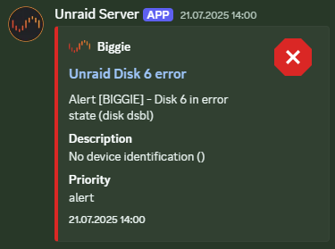

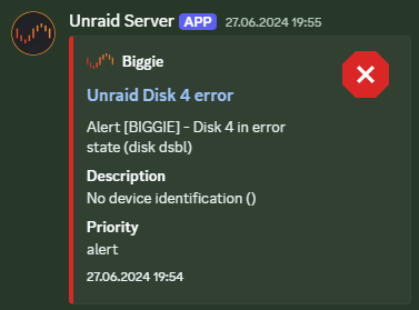

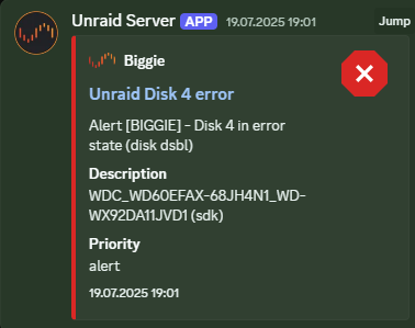

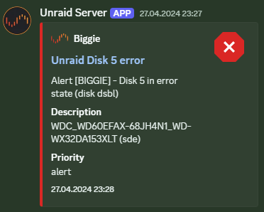

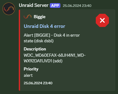

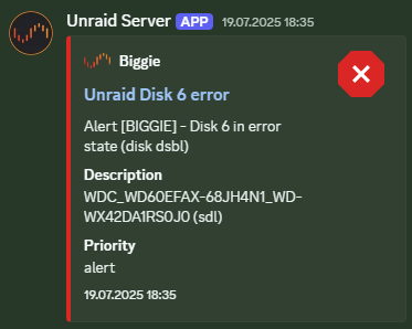

I had these issues in the past; that's why I unassigned those and reassigned them immediately, and it always solved the issue:

Yes, but they do need a rebuild - I had to rebuild those before, and when I started it, disk 5 instantly became error disabled.
It finished with 794882269 errors.

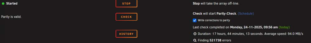

You can by doing a new config with the reservations I mentioned above—Tools - New config - Keep all - Apply.
Then check "parity is already valid" and start the array, run a correcting parity check, and if there are any disk errors (some sync errors are expected), post new diags.
I don't see any read errors, some sync errors, but those are expected as mentioned above.
OK, the array looks good now.
