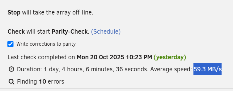

Hello. I have recently had my server rebuilt after it died early last year. The last parity check was Oct 2023.
After getting it all back together I carried out a parity check, which corrected 10 Sync Errors. You can see I had the checkbox selected.

On a second note, I am really disappointed the new hardware has added 6 hours to the parity check time.
Old hardware took 22 hours for a check (avg speed 76 mb/s)
New hardware 28 hours (avg speed 59 mb/s)
You should schedule a parity check once a month.
If there was an unclean shutdown since the last check, some errors are normal; if there wasn't, they are not.
For the performance issue, start by posting the diagnostics to see the hardware.
