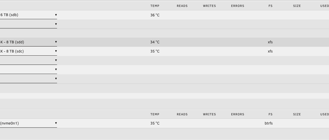

hey JorgeB,
Can't find the option to change file systems on these disks ; after the reboot, when you're on Main I only have the option to deselect the drive, in which case it shows as missing with the red cross ; when you select it again, not once am I prompted to select the fs.
What I mean to say, is that there is no dropdown menu for the fs partScreenshot 2025-10-23 at 14.14.10.png
Any ideas ?
you need to click on the device name (e.g. Disk1) to bring up the required dialog.

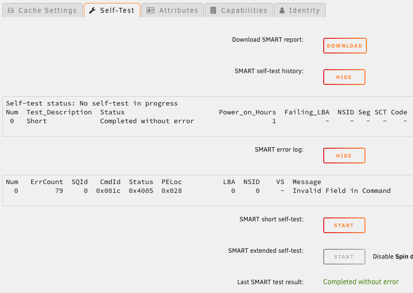

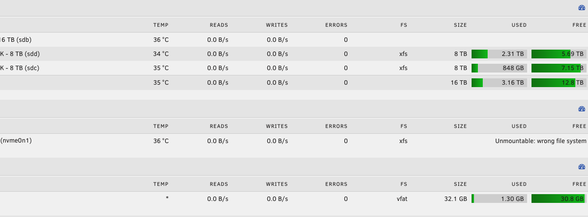

Okay I am an idiot itimpi, thanks for your help! Now that I had this guidance, I managed to follow JorgeB's instructions: seems like my problem is on the cache disk (which is very relieving since the HDDs are so much more expensive, and have data!). The Array starts without issues with the cache being unmountable.
Turns out the culprit is the SSD.
A quick SMART scan after, here are the results: Screenshot 2025-10-23 at 15.10.55.png
A bit confusing no? "Completed without error" but still some showing on the log? Is the drive dead?

Erased cache disk, changed it to xfs, formatted it, stopped the array again, changed fs back to btrfs, erased it once again ; formatted it once more.
The array now mounts without issues.
