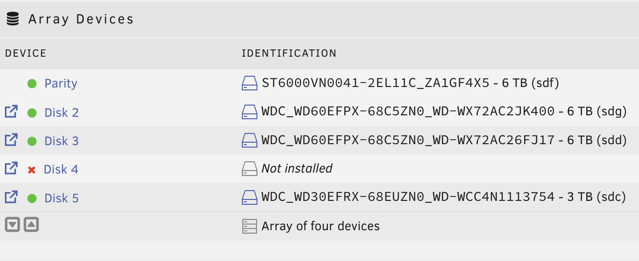

Disk has gone missing: Device is missing (Disabled), contents emulated
It is Disk 4 (screenshot) and is a 4TB, nvme drive that I only used for VMs.

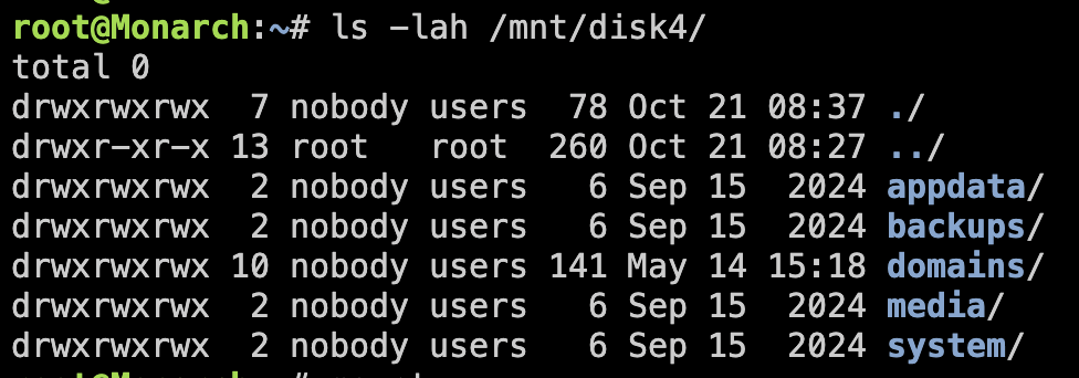

If look in /mnt/disk4, everything is there (screenshot)

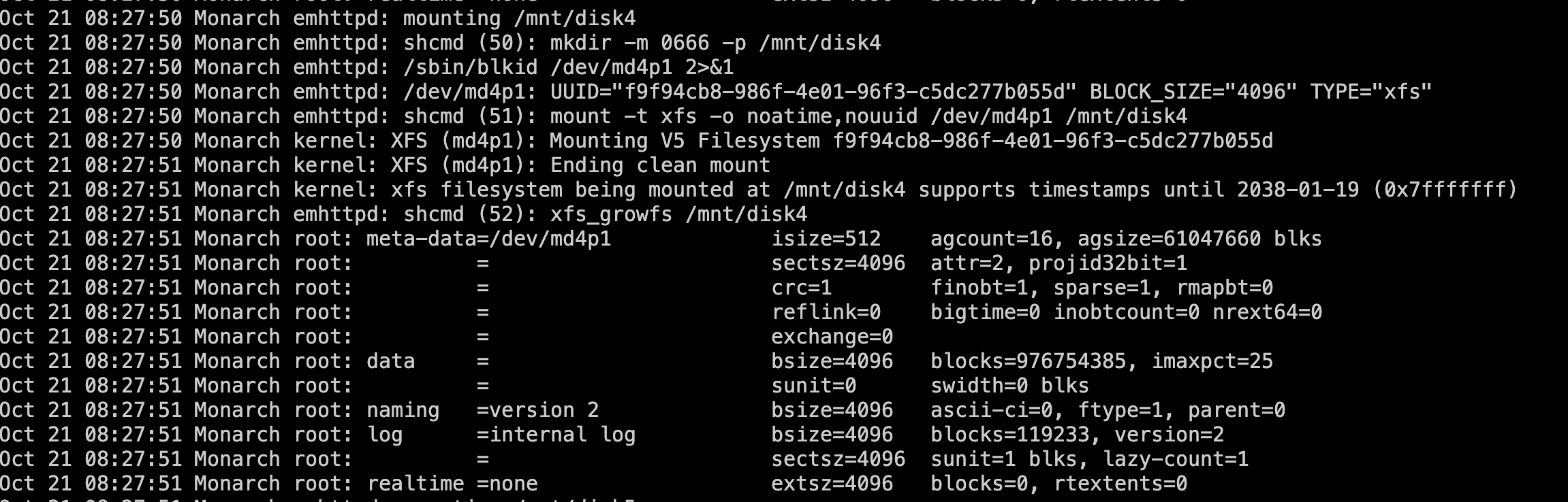

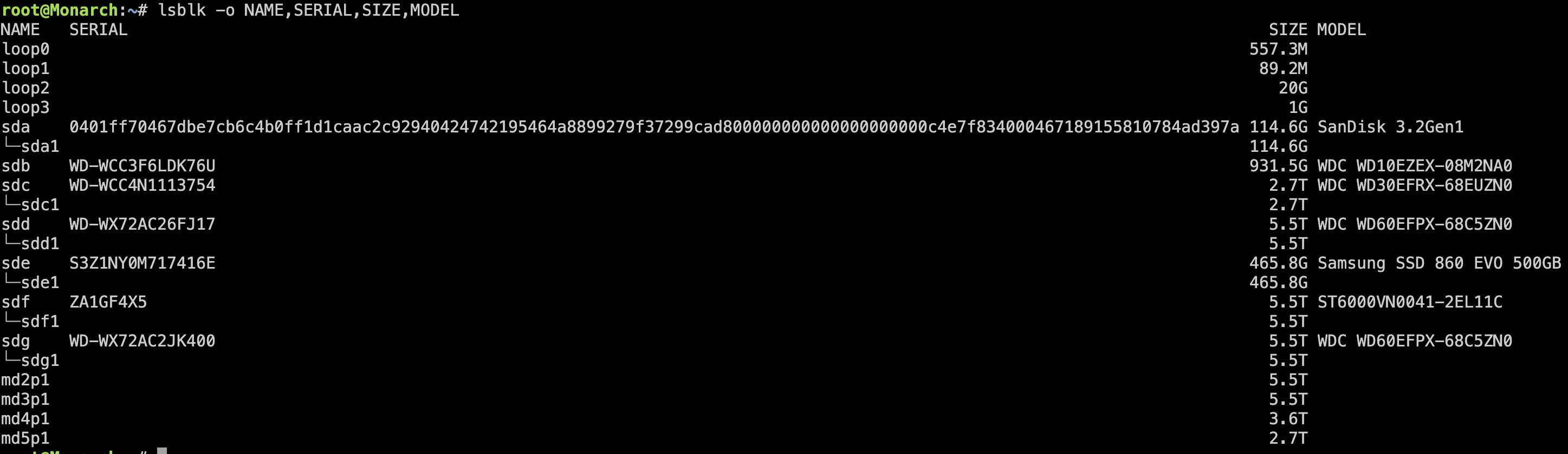

In the lsblk outputs (screenshot), I believe the correct drive is the one labled md4p1

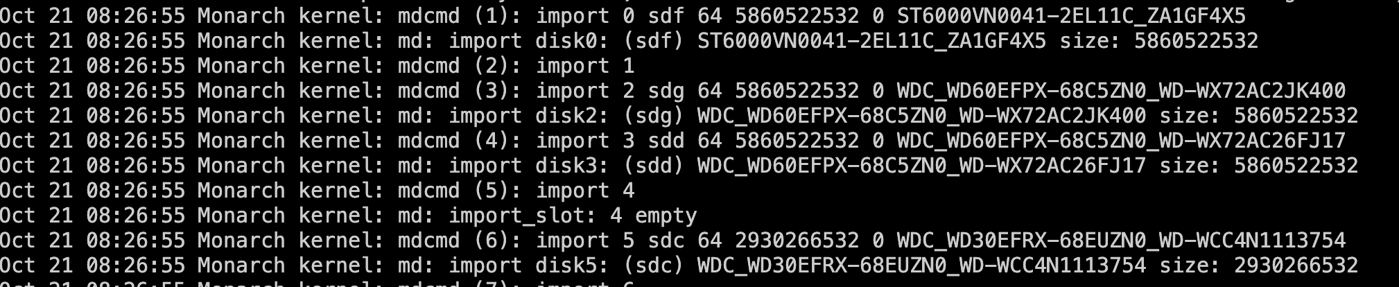

Logs show errors for my GPU but nothing for the disks. I did see some general disk stuff (screenshots). These lines seem to be the only indication anything didn't happen:
Oct 21 08:26:55 Monarch kernel: mdcmd (5): import 4
Oct 21 08:26:55 Monarch kernel: md: import_slot: 4 empty
This is expected as when a drive is disabled then Unraid starts emulating it using the combination of the other drives plus parity. As was mentioned we need diagnostics to give any sort of informed feedback.

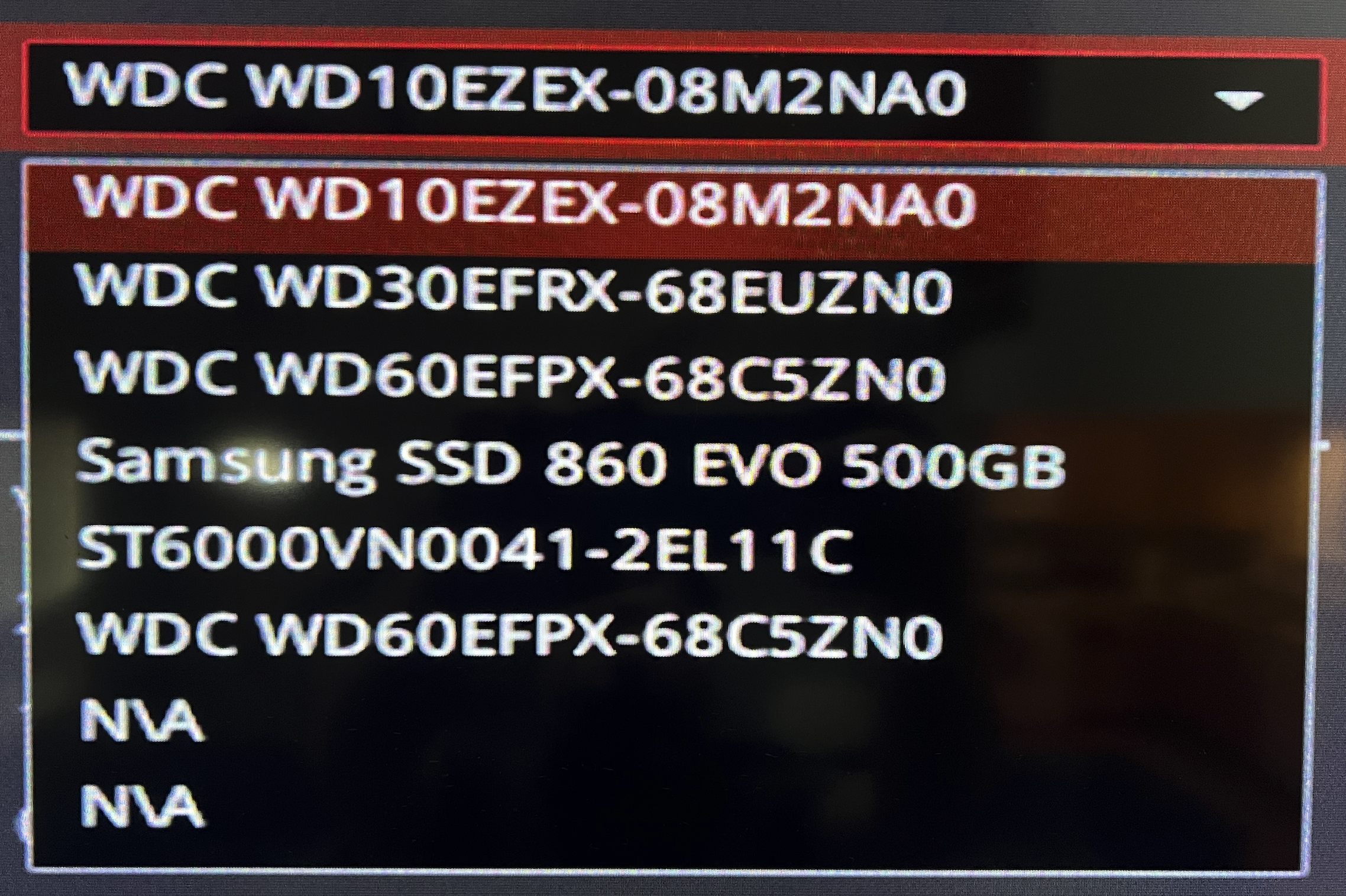

Looking at the diagnostics it seems that the drive that should be disk4 (a 4TB drive) is no longer being seen at the hardware level so it may have really failed. Have you checked if it is visible at the BIOS level? Have you done a server power cycle in case that is needed?

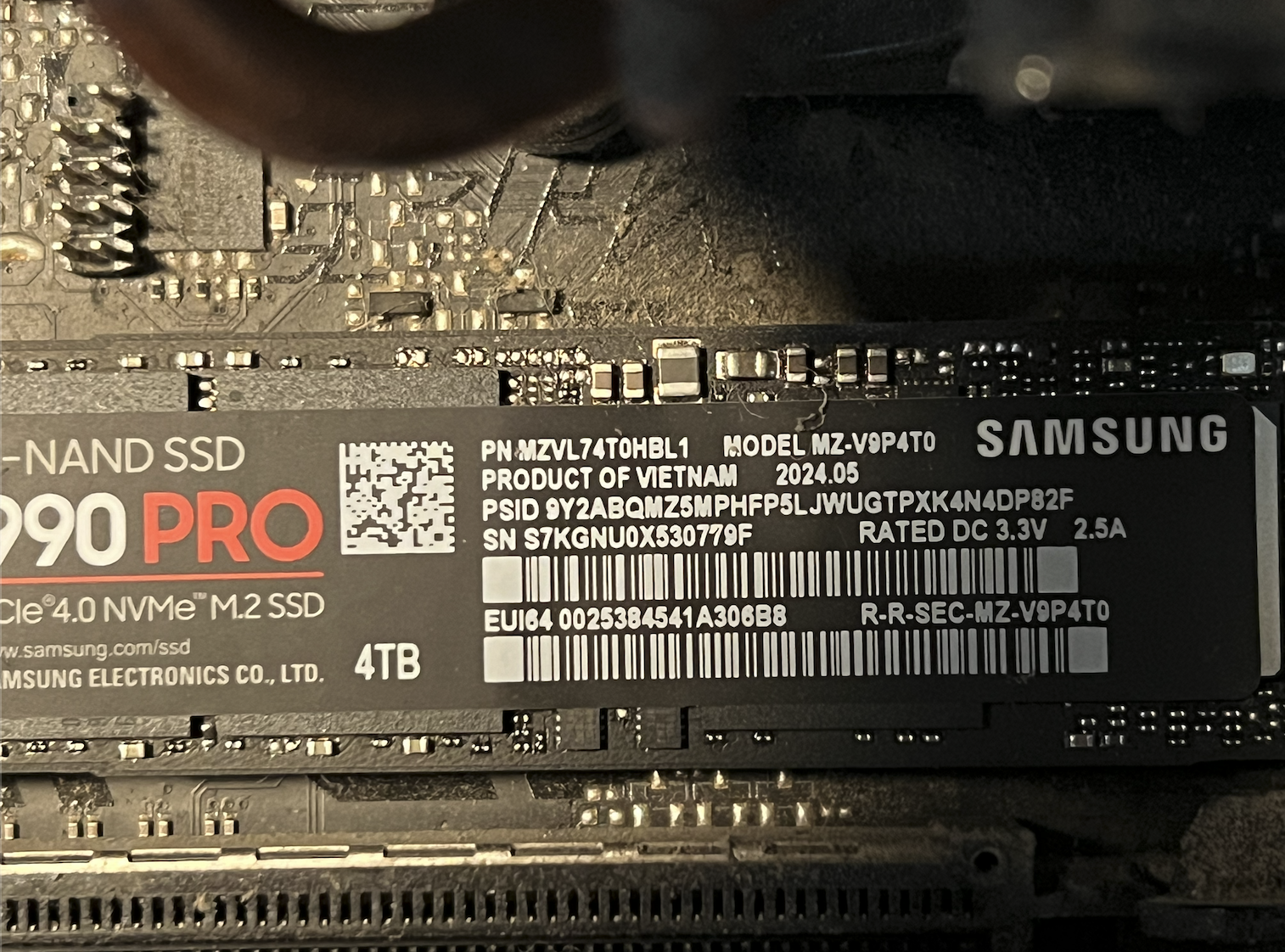

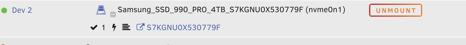

Edit: Well, I thought it was dead. Rebooted and jumped back into the server and the drive is sitting in Unassigned Devices. I was able to mount and ls the files. I've attached fresh diagnostics
Edit 2: Attached a SMART report.
I think it dead lol
Thats a damn shame. I dont think I even got a year out of it:(
>>> Yeah, I went and looked at when I bought it and its been a year to the month 🤣
Maybe I'll get an m.2 -> usb dock and look into it more.

The emulated disk is mounting. Assuming the content looks correct, you can rebuild, or if nothing was written to the emulated disk, and to avoid a full device write cycle, do a new config and check parity is already valid, then run a correcting parity check.
P.S. It is not recommended to use SSDs in the array, since they cannot be trimmed.
