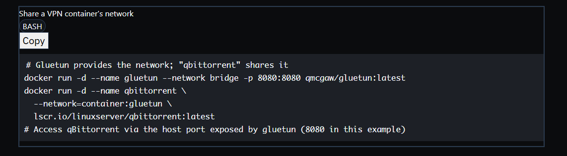

October 26, 2025Oct 26 Brandon Martino - Personal SiteGuide-DockerNetworksBrandon Martino - Personal SiteExit node: https://tailscale.com/kb/1033/ip-and-dns-addresses Please review the above links.You may also need to look into the tailscal docker sidecar method.you would implemnt a contaner network to the vpn.the vpn like gluetn for example would have adational port mappings.in my docker weebly guide I use qbit torrent for examplethis means that the qbit torrent docker will use gluten for its only netowrk data adn what gluten has it will use.this also means to access qbit torent the ports need to be open in the gluten docker.https://www.reddit.com/r/unRAID/comments/1ar02ij/tailscale_sidecar_docker/ https://forums.unraid.net/topic/186777-need-help-understanding-implementing/
