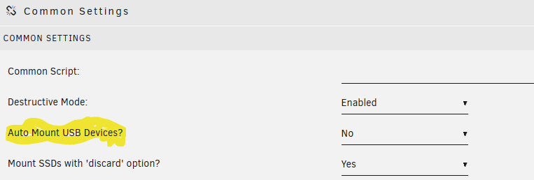

Perhaps he meant this?
Thanks. I had already manually mounted the drive. When I found this setting I switched it on, but it wasn't the problem. The problem was basically that I found it overly complicated to copy a few files to external usb with the inbuilt file manager. I probably also overlooked the /mnt/disks/ mount point when using Midnight Commander as JorgeB pointed out.
