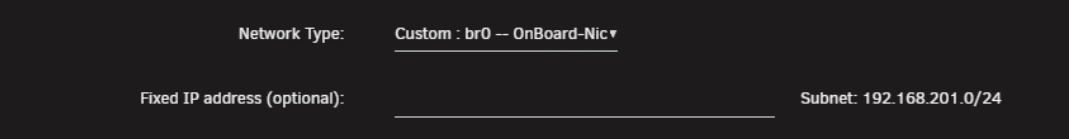

set unraid to a static IPv4 Addresss:

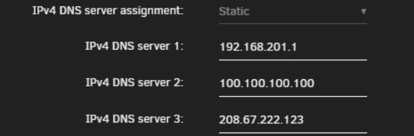

set your router, tailscale magic dns and a public dns you trust. 1.1.1.1 cloud flare, 8.8.8.8 google, 9.9.9.9 quad 9 208.67.222.123 cisco open dns family filter...
since using tail scale. My data shows some of my router network is 192.168.201.x/24

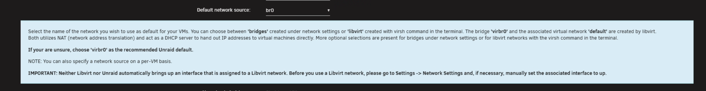

VM settings:

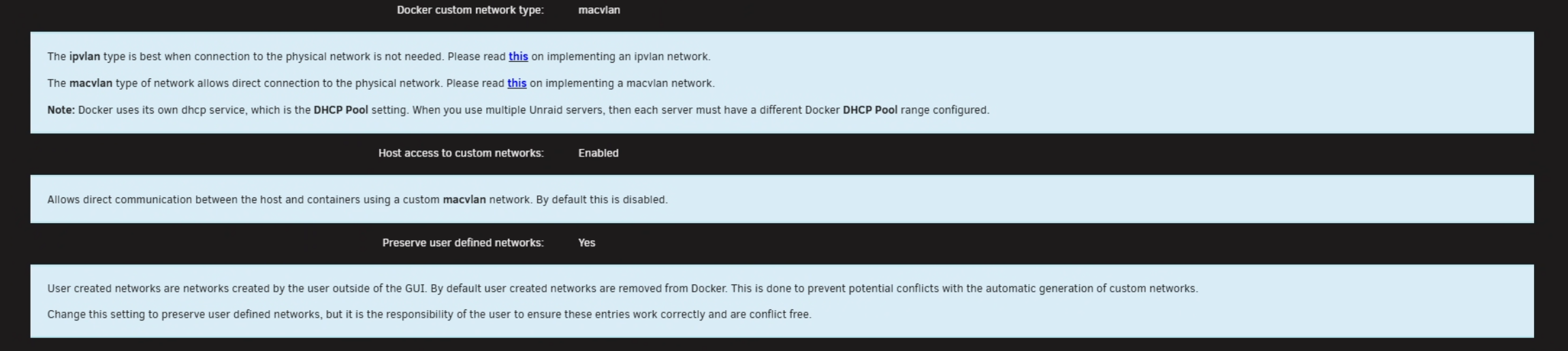

Docker settings:
You may also need to define extra parameters line for DNS depending on how you setup tailscale...
edit docker > advance tolge and add the --dns=8.8.8.8 to make sure the docker has internet access...

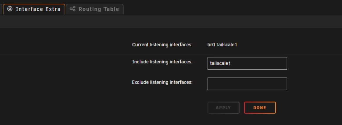

IF using tailscale magic dns and set dns to ture/yes this will override unriad resolve config and dns and can cause intermitten network issues...

Are you using br0 network mode (custom IPs) for your containers without having enabled the "Host access to custom networks" in the docker settings?
