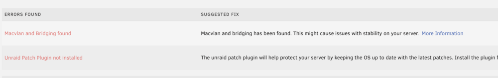

Fix Common Errors flags the following:
"Macvlan and Bridging Found". I'm not sure why this would come up with any ver of unraid after 6.9.2.

I'm no expert, but normally the diagnostics are in a zip file rather than several separate files. In this case, I would miss the syslog-previous.txt file, which is the one that can give us more information about what happened in the system when it shut down, since the syslog.txt file you attached will be from this execution and we won't be able to see the errors.
Try uninstalling the Dynamix S3 plugin and retest, or reboot in safe mode.
