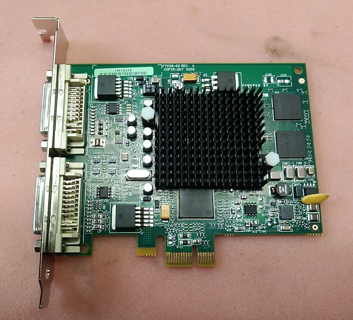

This is the model I have: s-l1600.webp
@snsn that looks like the card I have.
I have attached the vbios ROM file I'm using.
