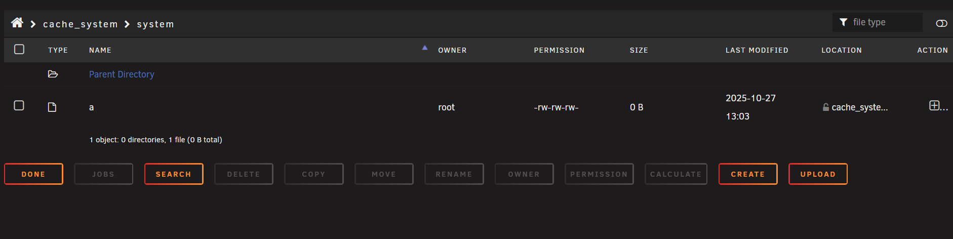

Type touch /mnt/user/system/a then post new diags

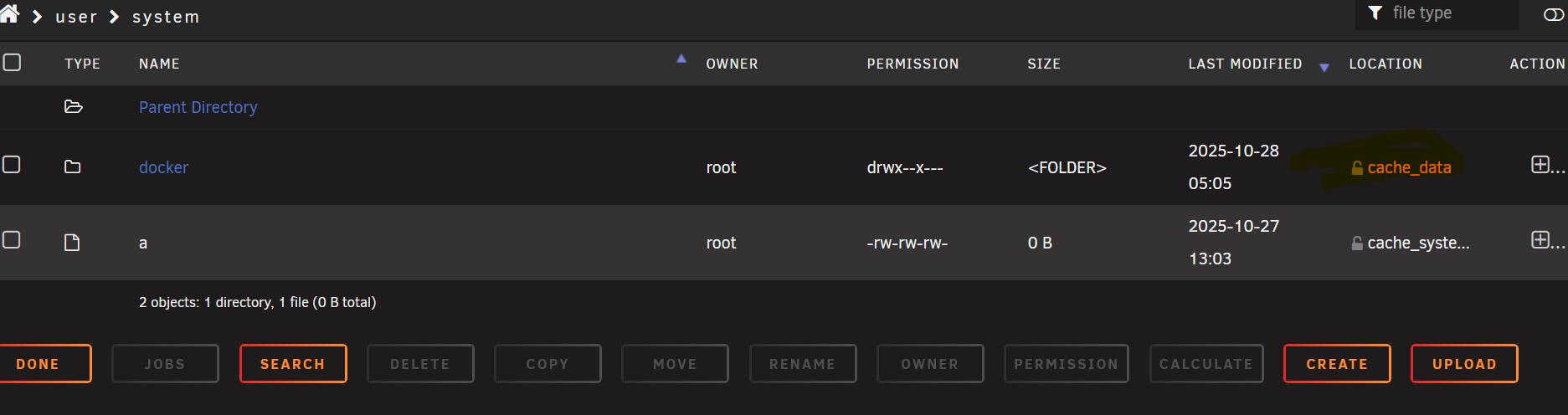

Thanks so much @JorgeB , I've just done that and posted the updated diags. Also, taking a closer look it appears the system folder on my cache_system drive is empty

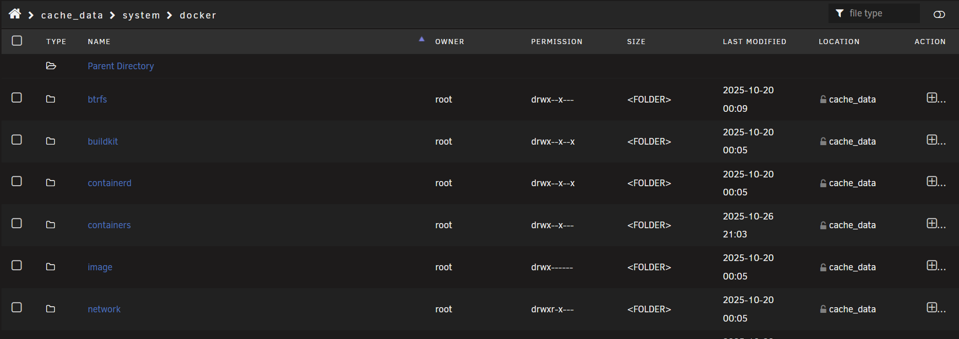

But then on the cache_data drive there is also a system folder populated with a single sub-folder called 'docker'. This has lots of folders/files within it and seems to be regularly updated.

The new file was created on the correct pool, so the share settings are working. Note that any existing files won't be moved there automatically from the other pool, you would need to move them manually or use the mover.

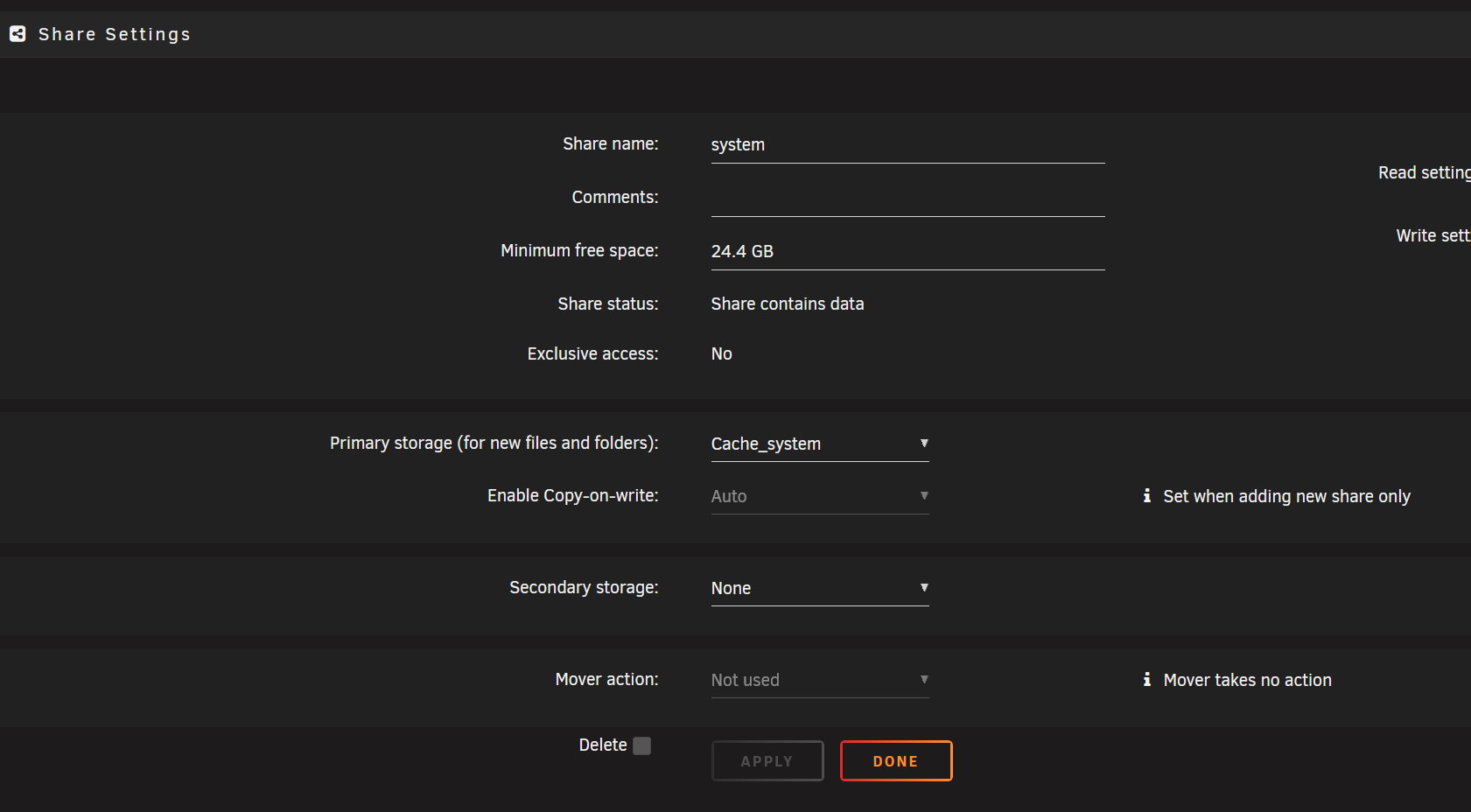

The System share has a primary storage drive of Cache_system (which is the drive I want system files to be stored), and no secondary storage set
The appdata share also has a primary storage drive of Cache_system and no secondary storage set
All of these setting remain unchanged from my initial config of this new server a few weeks ago
The test file @JorgeB had me create in the terminal has written to the correct Cache_system drive.

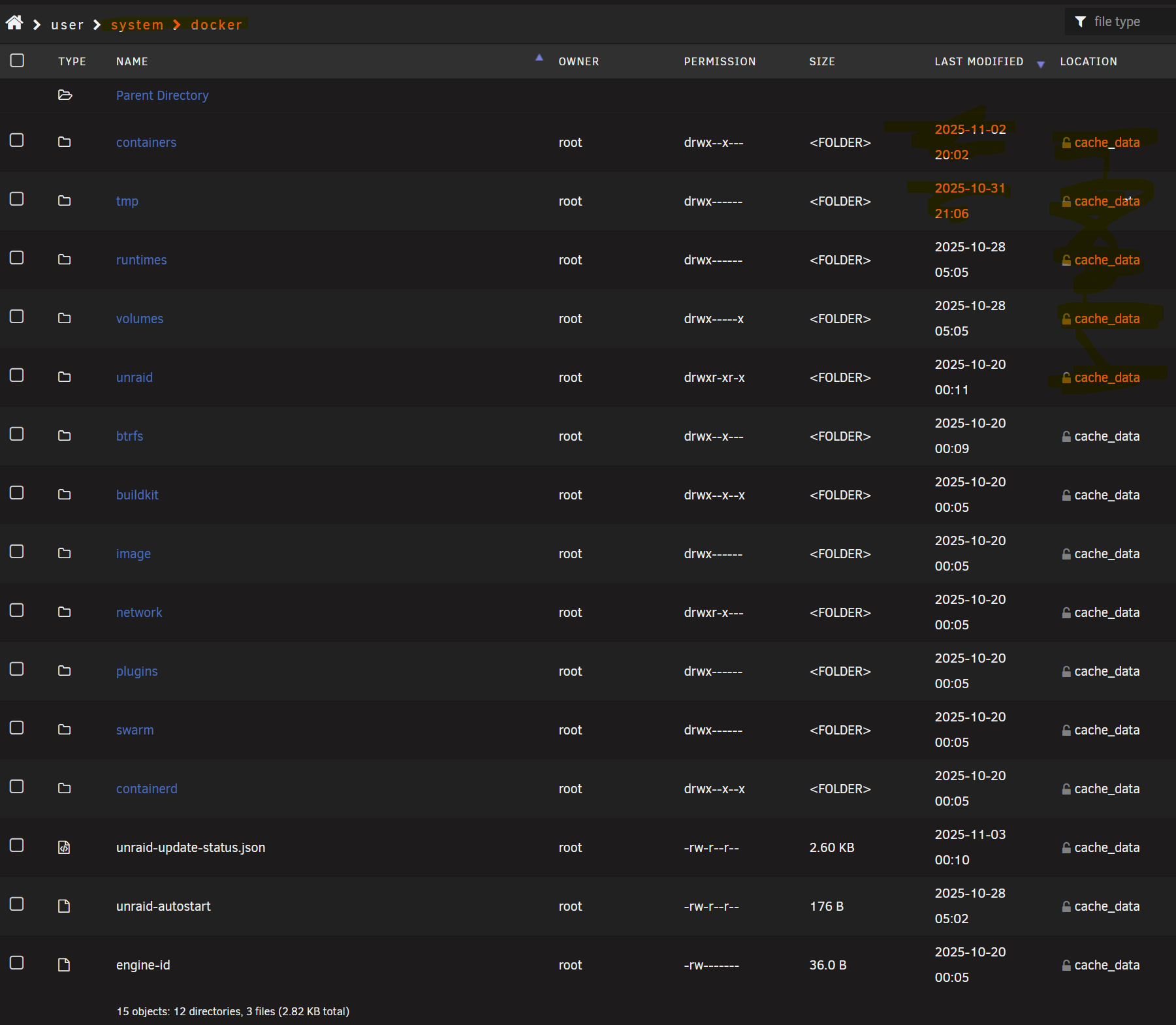

But somehow despite all of this a "docker" folder in the system share continues to write new files to my other cache drive (Cache_data). See screenshots below sorted by last modified
If I move the docker folder from the cache_data drive to cache_system where it should be it appears that future writes will just continue to land on cache_data despite all my correct settings. I'm also concerned that moving this folder might screw with my config, so wanted to check in again before I so anything. Have also attached diagnostics.

Did you actually move those shares to the new pool? If the appdata and system shares are on the old pool, any changes to those files will keep going to the old pool.
The solution is to move the data over, new files should be wrote to the new storage location. Existing files being modified wont be moved regardless of what storage pool you selected in the share settings.
Stop/Disable docker service in the unraid settings. Set cache_data as the secondary storage for your system share and then set the mover action so that the arrow points to cache_system from cache_data so that it looks like cache_data -> cache_system and run mover.
