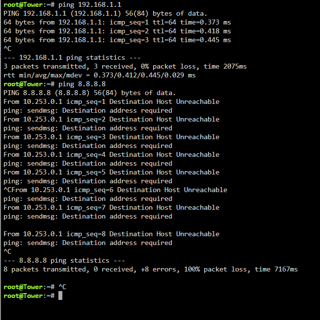

ping to gateway and google dns

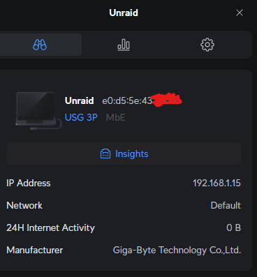

No VLANs? Maybe check you didn't have MAC address filtering enabled on your router with the old machine's IP...
router can see i but shows 0 bytes of internet traffic , no blocking, no filtering no vlans

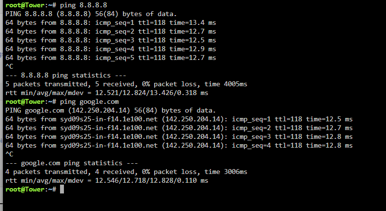

fixed it .. well kind of, Disabled the inbuilt WG VPN ( no endpoints conencted) and everything fired up
not sure why that would break things
