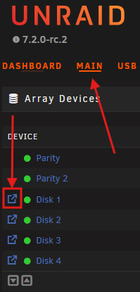

Well first take a look at what's physically on disk1.
Confirm it's not just an empty "system" folder.

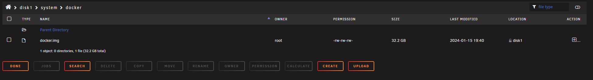

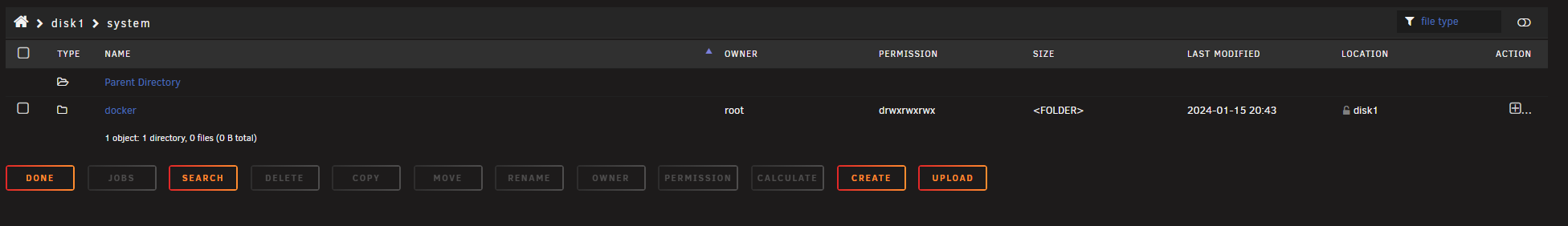

Looks like the only thing in there is a docker.img file.
Stopped the docker service and VM service. Ran the mover again with mover logging enabled. The docker.img file refuses to budge.
Attached is the updated diagnostics.
fossiltower-diagnostics-20251028-1443.zip
Oct 28 11:41:40 FossilTower move: move: /mnt/disk1/system/docker/docker.img File exists
Mover won't move duplicate files, see which one you are using and delete the other one.
