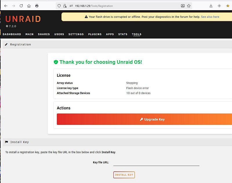

19 hours ago, ConnerVT said:
I'm feeling pretty good about this update. Enough that I will likely take the plunge and bring the main server up to date from 6.12.10 to 7.2.0. I have time the next day or two, so we will see how it goes. Those who know, I'm hesitant to update unless I have a compelling reason to do so. 7.2.0 looks like a stable point to take the plunge.
Well, I took the plunge. Fortunately after being greeted by this screen, things seem to be working nominally after a power down restart and cancelling the parity check.

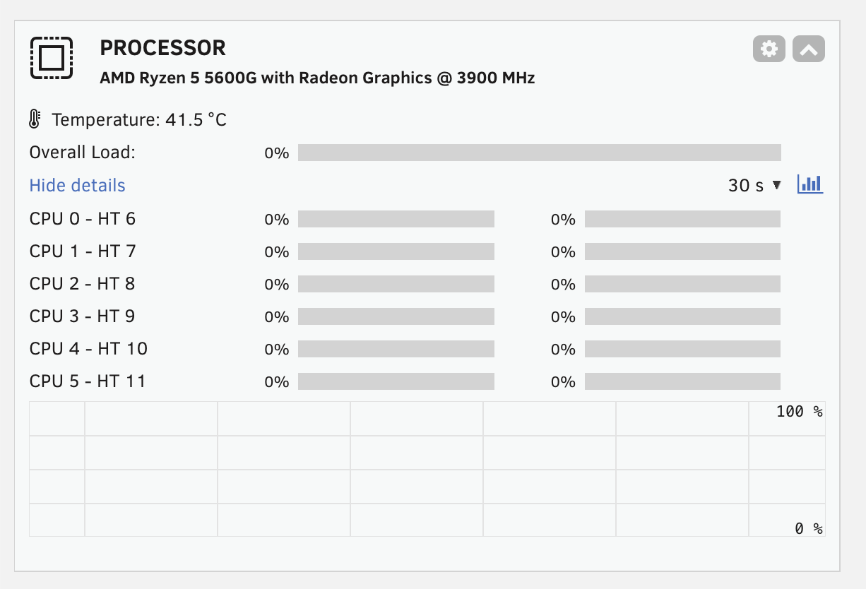

Oddly the Processor graph from the dashboard view is now blank (save for temp) after update. On a AMD Ryzen 5 5600G server. Tried a restart as initial diagnostic, no joy.
Stats page shows CPU load graph correctly.
Do you have the connect plugin installed? If yes try removing to see if it fixes?
