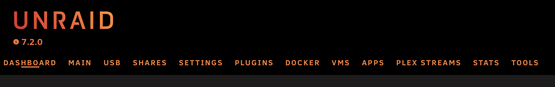

Minor but in future I'd probably be inclined to change the highlighted underline nav bar to a .
as a dot looks better when the length of nav bar titles changes length?
Edited by dopeytree
In design less is more.
At the moment the line not adjusting to the length of the characters is more disturbing.
Could have the line be the same width and align to the left of the text.
Also needs a 5px gap above the line or something its too close to the words.
Other options include just changing the colour of the active nav point or fading etc.
All will probably be possible with new theme engine?

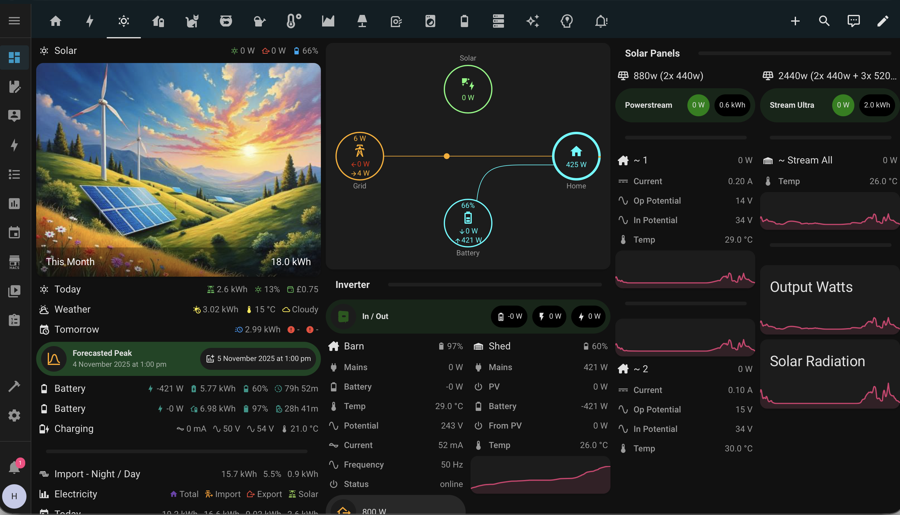

Perhaps swap to icons like homeassistant.

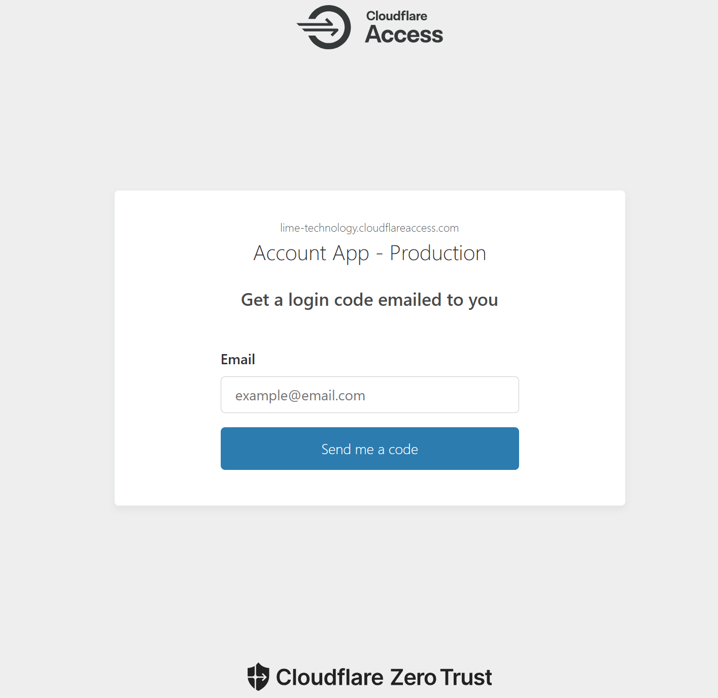

no issues here but noticed this, when selecting tools|updateOS a cloudflare screen is displayed,
