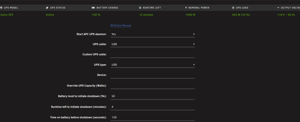

If it helps at all, this is what my settings page looks like:
Yours should look very similar, would you mind posting a screenshot?

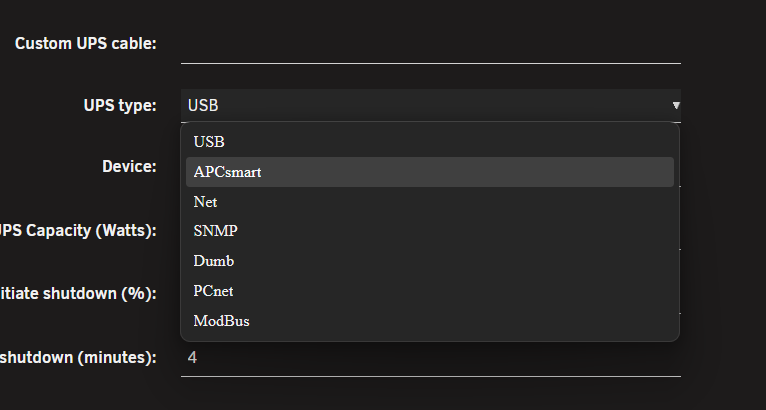

If this is still an issue id suggest trying to set the ups up on say your laptop - this is counter intuitive - lets find out what port you need. I'm leaning to the |o|o| (serial port). I run an Eaton 5PX ups and it is a USB to the RJ interface for the serial interface.
suggest installing the APC Power chute software to your computer then plugging it in. the green port is for the cloud management software. if you are running a windows vm on your server you could pass that usb port through to it to do this testing.
i dont have an APC smart to test with but it looks like 7.2.3 has an APCsmart in the drop down as well.
