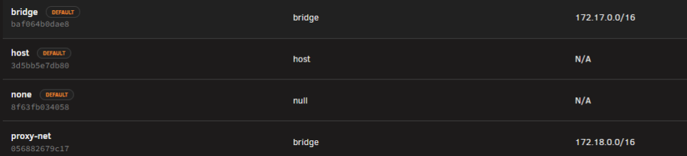

I dont see how you're running out of 254 addresses on the default network size. Are you running more than 254 separate containers?
furthermore you can create custom docker networks which would then get their own separate entire pool of IPs
for example, look at bridge and proxy-net. these both have 512 addressable IPs per poolimage.png
Edited by MowMdown
