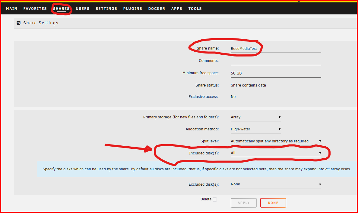

Look at this setting right here:
You will have to keep an eye on how full that disk becomes and add a second one at the appropriate time!!! (Should not be a big problem with +20TB drives now available.)

To state the obvious, for the 'other shares' use the "Exclude disk(s)" setting and set it to disk 1 for those.
