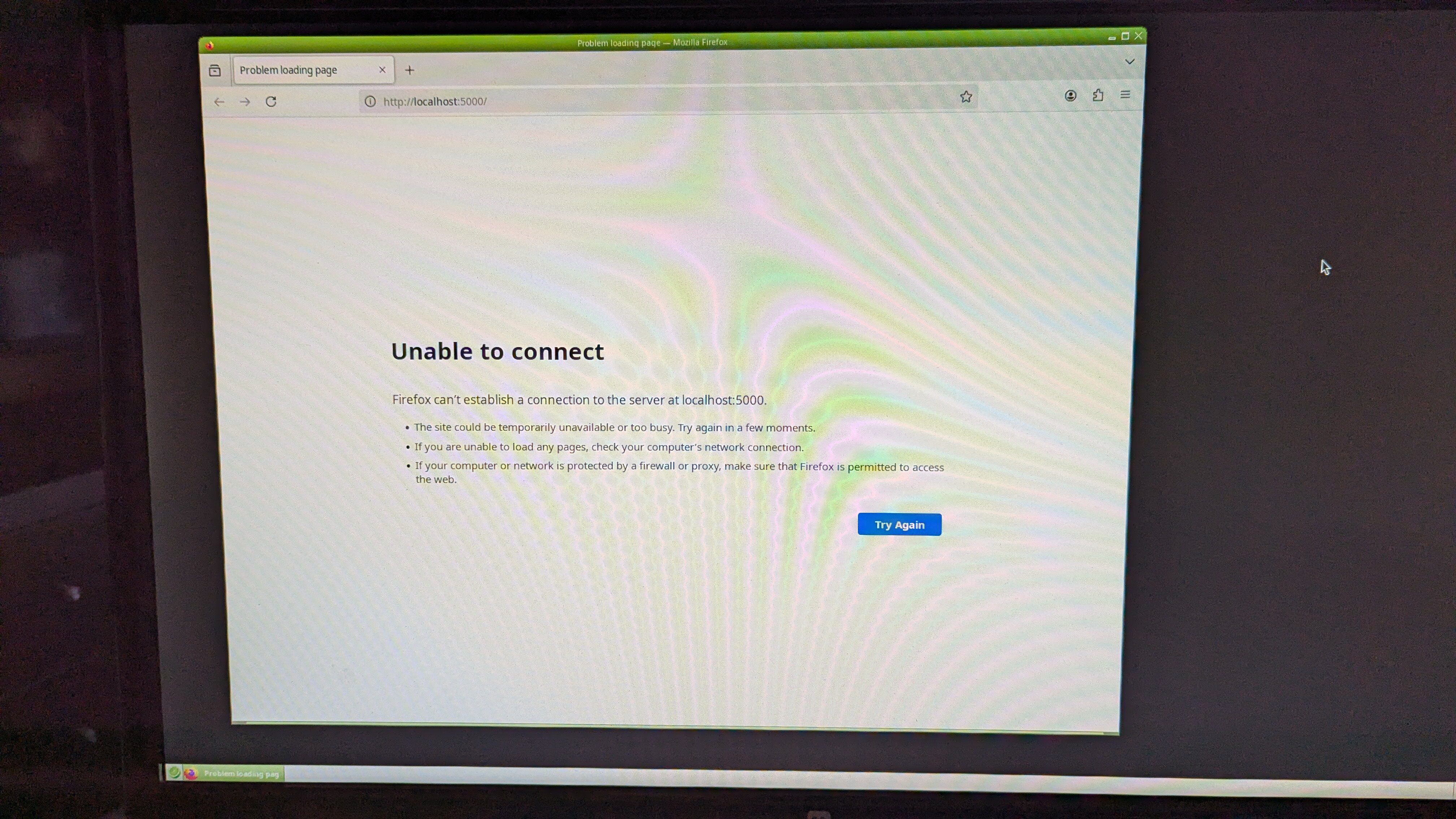

Nothing at all, no shared drives or login prompt. When I connect a keyboard and monitor to the UnRAID server and boot with GUI, the firefox browser opens but nothing is displayed, like the web interface is missing.

Attached is what I see when booting in GUI mode.
Thank you for responding and assistance.
Boot in normal mode and use the keyboard to login and get the diagnostics, using the CLI.
There's no link on either of the NICs, but that is not the only issue. Disable the Docker service by editing /config/docker.cfg on the flash drive and changing DOCKER_ENABLED="yes" to "no", then boot in safe mode and post new diags
