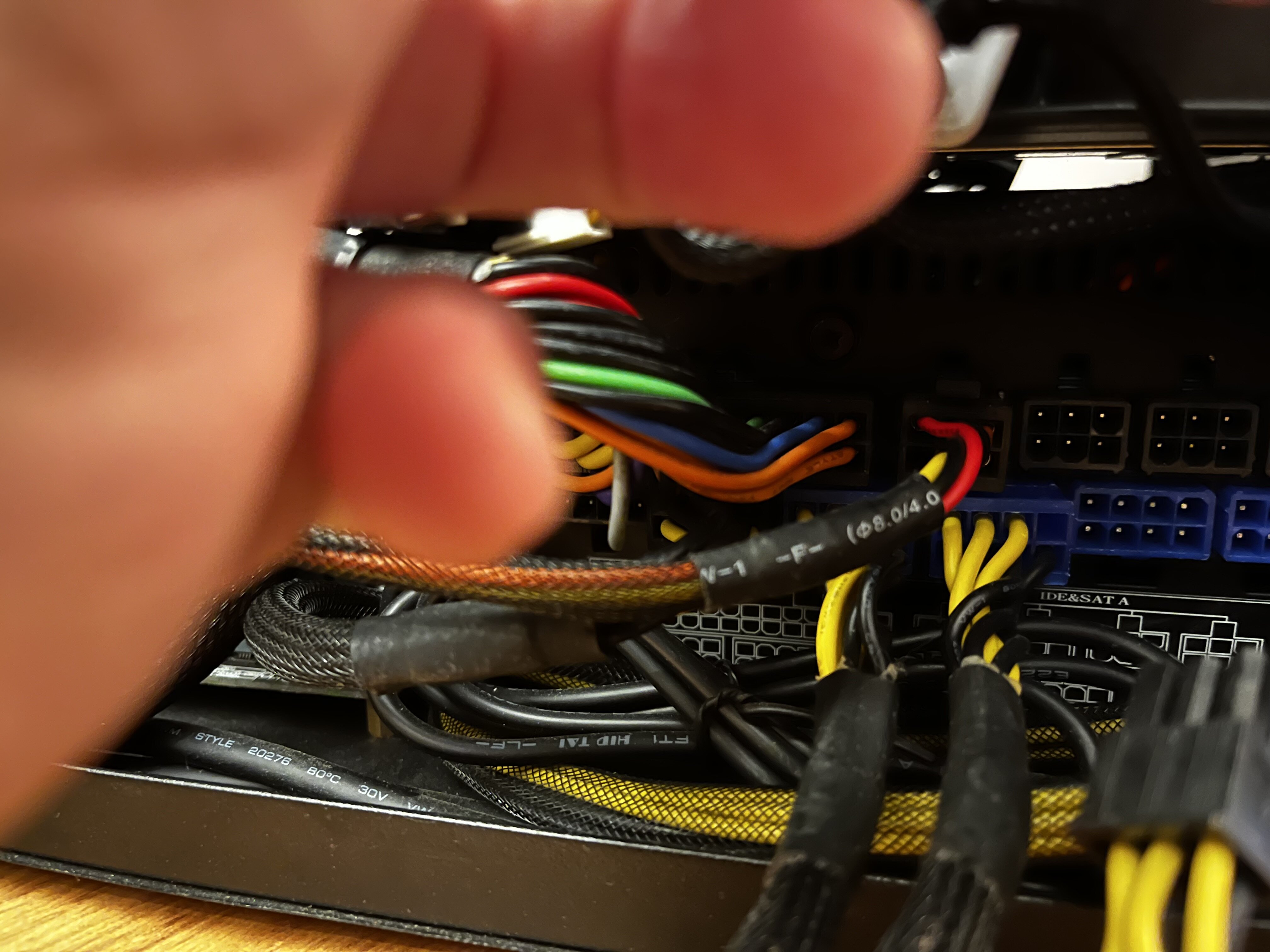

My Uraid system built in a small form factor case using a Silverstone ST75F-P power supply. From what I can tell this silverstone should be modular, but it will not power up unless I have all the cables plugged into it. The case is very small and it is next to impossible to close with the extra cables that I don’t need.
In the attached photo it is the two harnesses plugged into the bottom blue sockets that I don’t need.
Is there something I’m missing? What can I do?
Does two blue plug cable also missing wire on that hole ? I would expect one will have black wire there, and once that cable plug-in then PSU would work.
If above were true, that means the "black sense" need short to black wire.
Edited by Vr2Io
