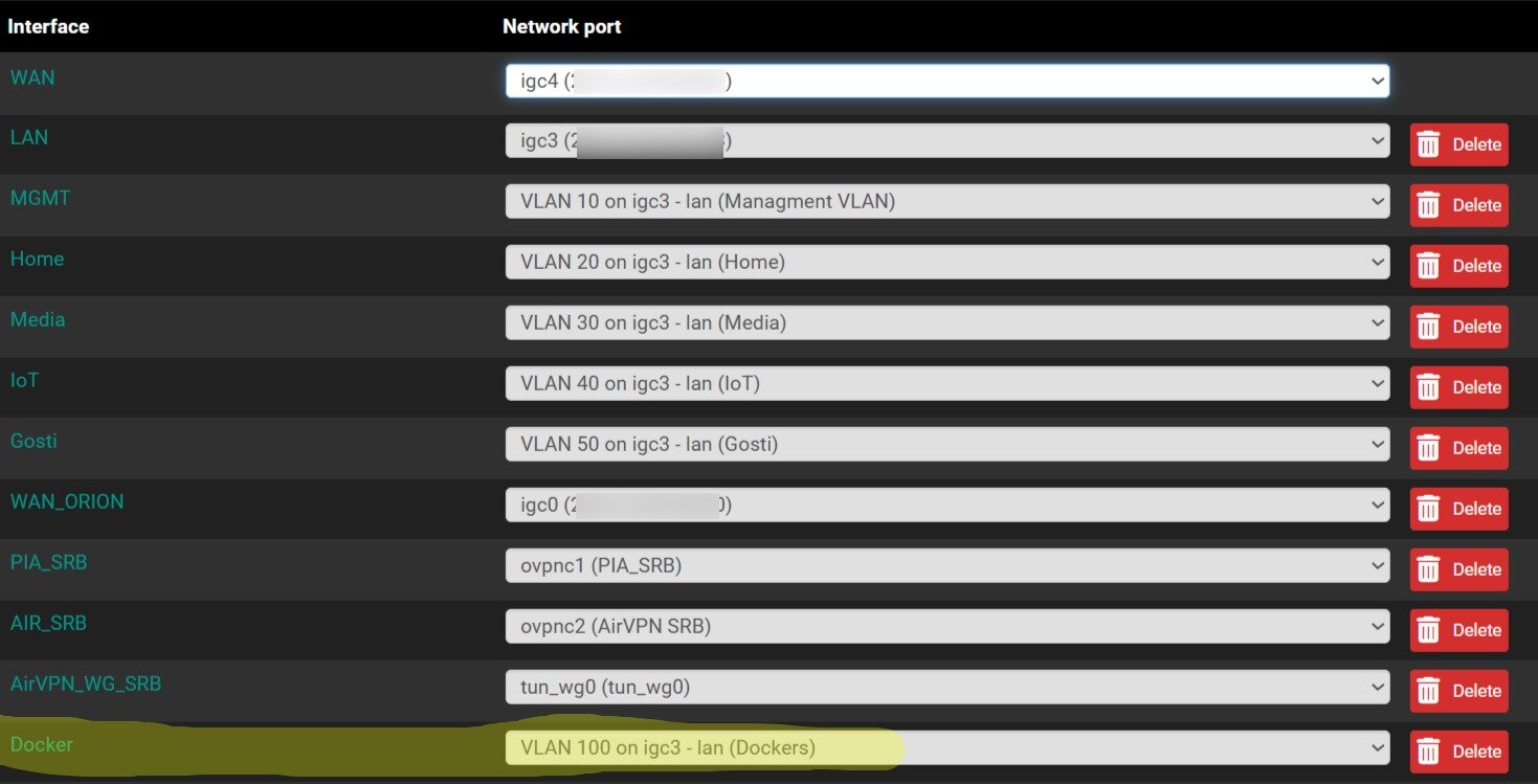

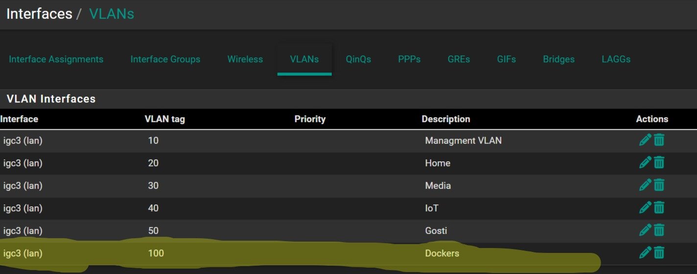

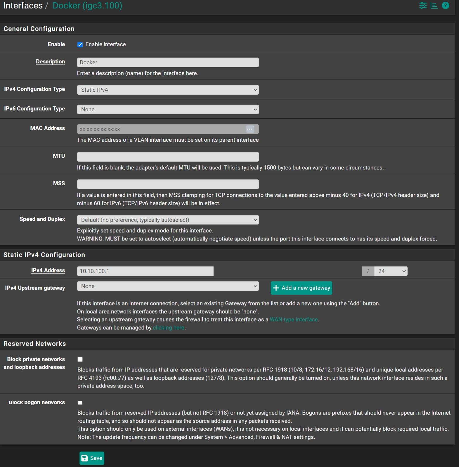

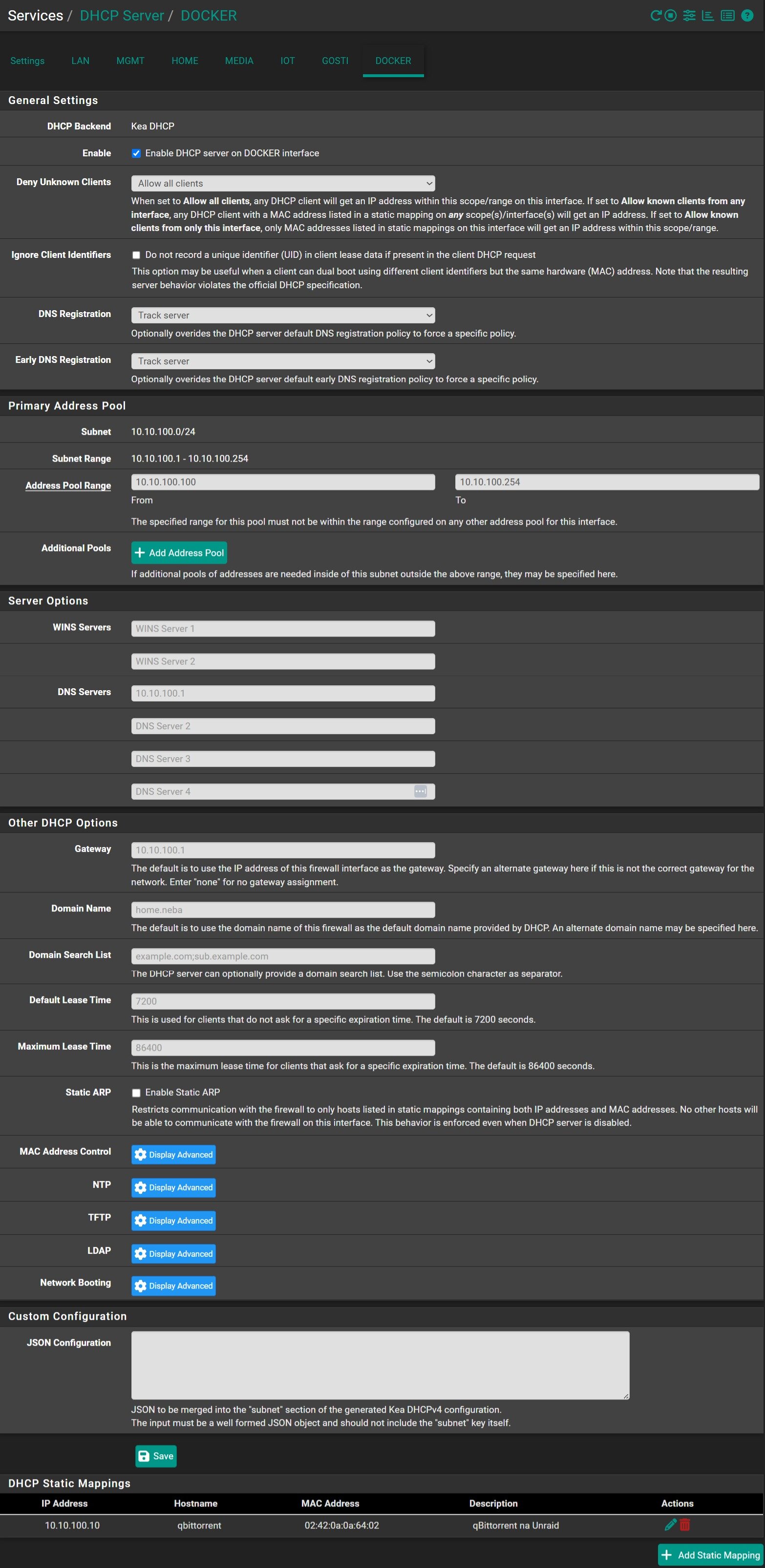

I don't know how to pfSense give IP address assignment for the Container
I would like pfSense to assign an IP address based on the MAC address of each container.
I tried everything I knew. I also tried assigning a custom MAC address via --mac-address in Extra Parameters: in Docker details.

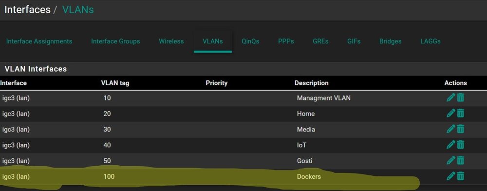

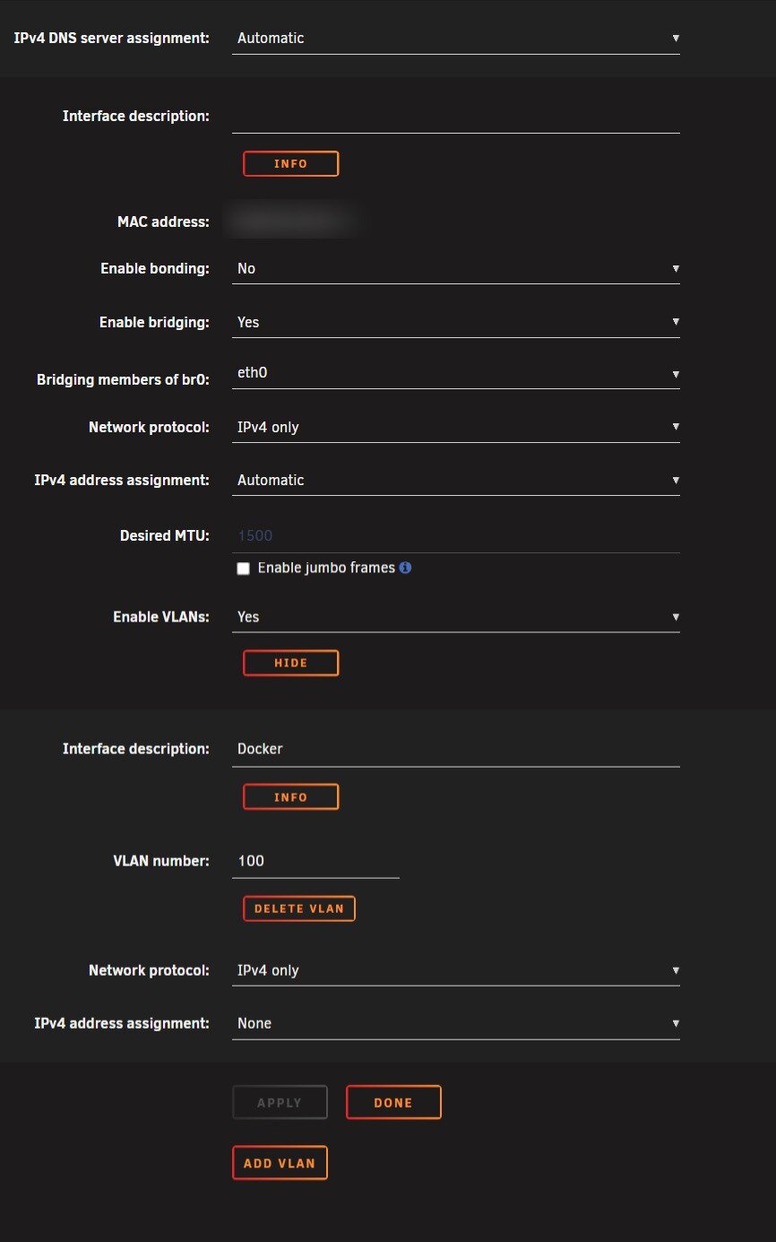

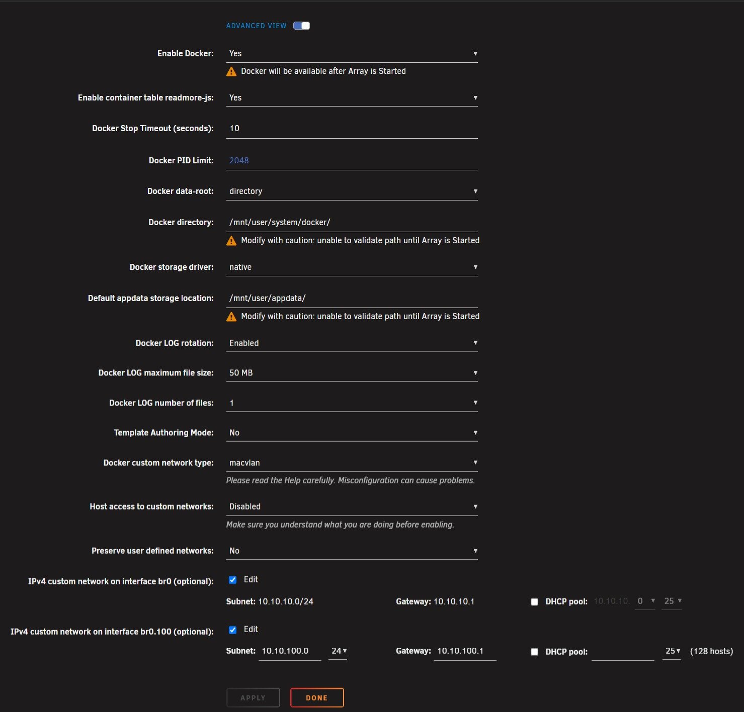

I created a VLan on pfSense, and Unraid assigned IP addresses in order, I can't get pfSenese to take that role.
Here are a couple of screenshots of my setup, if you need anything else, I'll send it

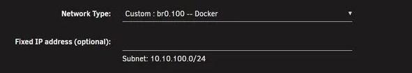

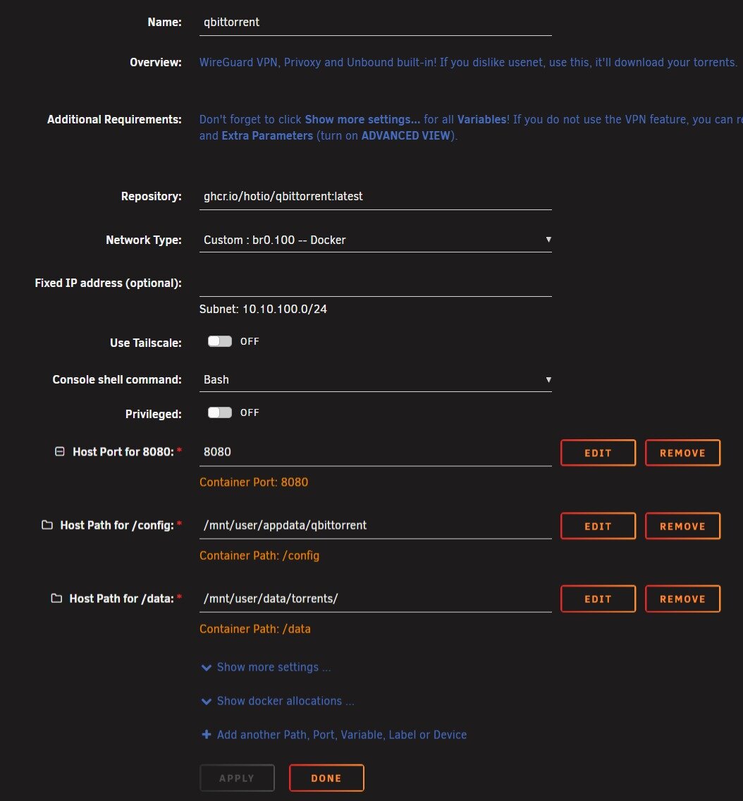

Example. I would like the qBittorrent container to get the IP address 10.10.100.10 and to do that pfSense. Unraid persistently assigns the address 10.10.100.2
The screenshot shows the settings of Unraid, pfSense, and the command prompt from the Unraid terminal and Docker terminal as proof of the MAC address of the qBittorrent container.

Macvlan for Docker network type is set.

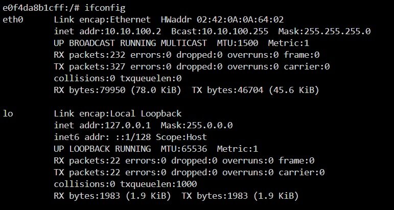

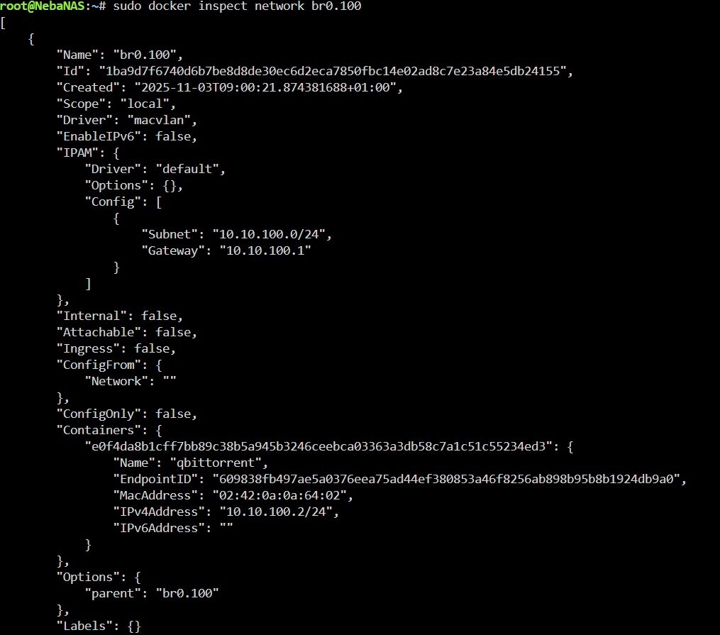

In the example above, I let the Container assign the MAC address itself, and it can be seen through two commands. There are screenshots

if you let docker assign its own mac, it will start with 02:42 (vendor portion of mac address), you don't need to override mac but it is an option.
8 minutes ago, neba said:
What does it mean that it is related to the IP address.
As above, first part of the mac is 02:42:0a, the rest is determined from its IP address it has been assigned, as explained here:
The MAC addresses for Docker all begin with 02:42.
The remaining four octets represent the IP address of the container in hex.
0xAC in hex is 172 in decimal,
0x11 is 17,
0x00 is, well, 0,
and 0x02 is... 2.
Thus this MAC address represents a container with the IP address 172.17.0.2. The default Docker bridge network is always given the IP range 172.17.0.0/16 by default, thus this would be the MAC address of the virtual Ethernet adapter given to the first container you run on a fresh Docker install.
If you change the IP address the mac will change, that was the point I was trying to make.

As far as I understand, if I want the IP address 10.10.100.10, I need to put the MAC address 02:42:0a:0a:64:0a.
What is the purpose of pfsense and the possibility for it to give me an IP address based on a MAC address?

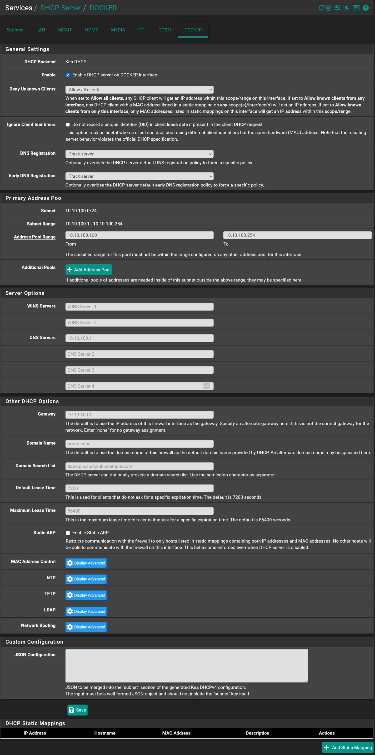

Would have thought in pfsense under status > DHCP leases you could configure the IP assignment there by finding the one in question, then clicking the + symbol on the right and filling it out. If it's already built, you can find it under services > DHCP server, select the correct lan and looking at assignments at bottom of page.
That's right, with the fact that I manually entered the MAC address and IP address. I'm not sure that the DHCP leases show the MAC addresses of the Container.
pfSense-DHCP-Server-DOCKER.jpg.34769071e
Can compare the Mac address from ifconfig from the container console to the pfsense assignment Mac.
It looks like everything is working like it should. All that needs changed is static mappings from .10 to .2 (in pfsense). Follow that with clearing your DHCP leases. Then restart container so it acquires new lease.
I'll give it a try

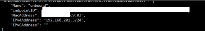

eample my dns unboud docker is given this mac address in unifi I've infomred that this mac is this hostname and ip
you then use that data to propgate pfsense and store mac address data...

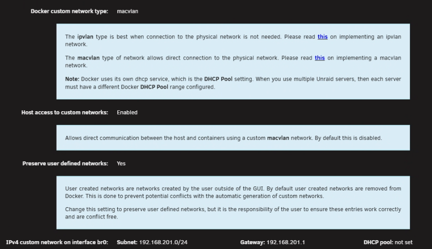

What I notice is that I set it up under docker settings:
Host access to custom networks: Disabled
Preserve user defined networks: No
Your advice is to be Enabled and Yes

Correct, please set custom to enabled and preserver user defined.
Host to enabled will fix some docker isolation issues and on reboot your custom docker network on br0.100 for example would not remain causing other networking issues upon reboot.

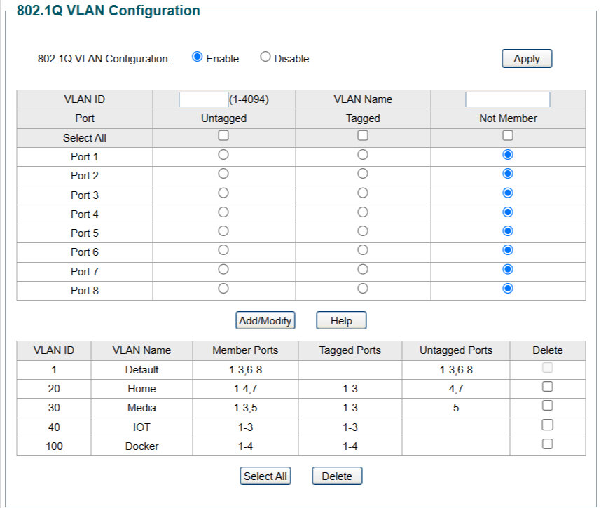

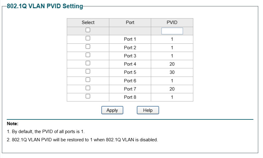

Here are the settings in pfsense. I installed Unraid from scratch. I have only one Container installed and I will try with it.
The problem may be in the Switch.
On port 1 is pfsense (10.10.10.1)
On port 2 is Unraid (10.10.10.10)
On port 3 is a wifi AP (10.10.10.2)
correct layer 2 layer 3 with vlan tags. it could be I need time to go though your configurations and check. but atm this look good. The switch is a potental issue.
isp > pfsense > switch > unraid
pfsesne mutple dhcp servers setup with vlans
swithc port form pfsense port igc3 (this tells me the port is intel gigabit port #3...)
swithc port will need trunkign and or vlan taged to default valn 1 and other vlans you want unraid eth0 interface to interact with...
On 11/3/2025 at 9:17 PM, neba said:
