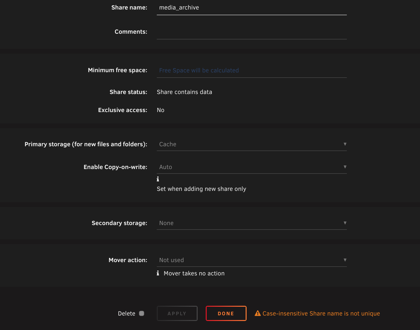

Thanks but when I delete the /boot/config/shares/Data.cfg from the Flash and go into my share everything is grayed-out and I can't change anything! Tried modifying my share but it doesn't let me choose to move to the array and when I push 'Apply' no data.cfg file is created on my flash drive. Now I can't access my share anymore from my PC.
Edited by siamsquare
You have to adjust the share name; in your case, it's media_archive
yeah tried that but the data.cfg is still missing on the flashdrive and nothing has changed.
I managed to make it partially work. When I change the share to media_archiv and back to media_archive I can configure everything , I can see the share from my Mac but the data.cfg file is still missing from the flashdrive! The good news is that Mover is working again...the bad that there is no more data.cfg file on the flash.
data.cfg doesn't matter in this case, it's the other share, if you also have a data share, click on it and then do a dummy change to apply the settings, and a new cfg will be created.
