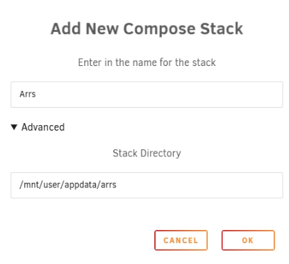

this way
/mnt/user/appdata/arrs will be our compose docker and env location for latter!!!

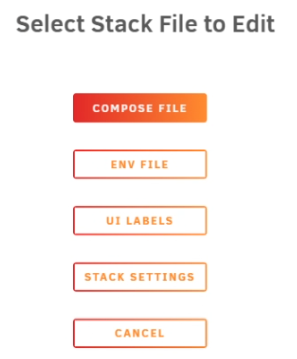

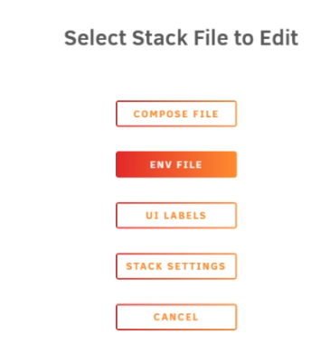

then eidt the stack env
ENV:
TZ=America/Chicago
PUID=0
PGID=0
# --- Unraid shares (simple) ---
APPDATA_ROOT=/mnt/user/appdata/arrs
ARSDATA_ROOT=/mnt/user/arsdata
compose file:
Compose:
