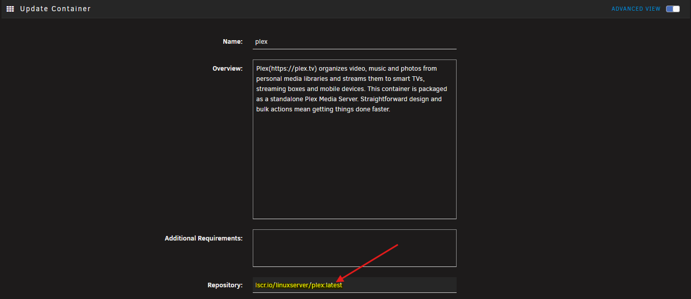

To make the change you simply edit the docker container template, expand to advanced view, and edit (or add) the docker branch tag to the end of the repository:
In the example below the tag is the whole part after "plex" :latest so in this case latest is the tag. You will need to figure out what tag was used and append it.
You may or may not have a tag, if you don't you will need to add the semi-colon+tag. (then click update)
If the action is unsucessful or the docker run says failed, your container will be orphaned, you will need to click on the "add container" button, click on the corresponding template, and fix it and run it again.

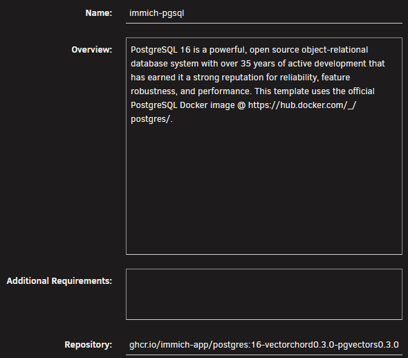

Here is another example with a custom tag specific for this container:
