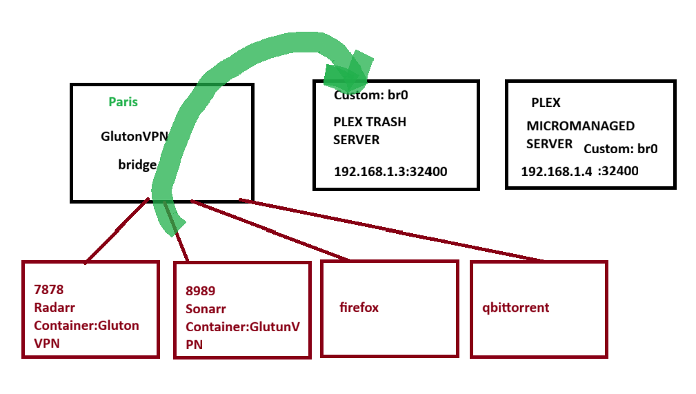

Hi, please can I request help - so this is my setup and I have a network problem; where it's doing what its meant to do. I have an OSI level 8 error 😅
I suppose the fix would be to put the plex in the same area as the GlutunVPN however I would prefer that it does not. How is this best approached? In the example below I can connect to Sonarr by going to 192.168.1.2:8989 however it cannot see 192.168.1.3. The glutun vpn has a container IP of 152.13.0.3 (not sure if that's helpful)
Thanks in advance.

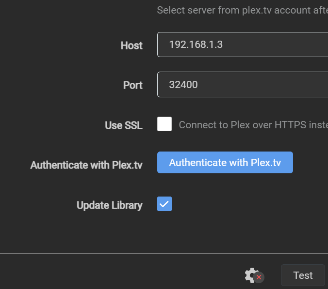

So hitting authenticate allows server access and will display your remote login - it auto populates host and port.

This didn't work for me as I use Starlink CGNET - but will work for others who have that normal WAN access.
As I understand this gives 2 options - either tailscale or VPN. Both are equally good.
Tailscale is a plugin which allows UNRAID to be used for remote access in CGNET at which point the dockers external to the VPN should also work - though I suspect I'm likely to do another post asking for help! However I believe this is the solution. Going VPN - should also work; the difference is that it wont resolve the UNRAID disallowing remote access with CGNET. It does however expose it to the internet. In this case two plex containers would have the same IP but need different ports configured.
