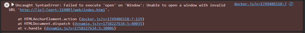

It stopped working on every single browser.
That's the interesting part, I didn't touch any advanced settings. Here is plex configuration, looks exactly as yours.
There is clearly some unhandled error. But I'm not web dev, so little lost to even where should I go to debug this.
var eventURL = '/plugins/dynamix.docker.manager/include/Events.php';
Edited by hallow
Please post an unray diagnostic file...
Would you make any reach and changes to your network such as docker Network a reboot if not reserved docker networks...
Cuz that will grab the IP that the doctor sees. So what do you see if you console into the Docker...
Not enough info to assist
